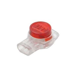

I usually strip with a razor blade or finger nail then solder and heatshrink. 24 is basically the same guage as cat5 cabling. If you dont care about "marine grade" you can certainly look into connectors for phone and data. The connector below is very easy to use (doesnt even require stripping) and comes filled with a gel to keep out water an moisture

These work without stripping the wire. 3M Scotchloks, is my love so wrong? - Panbo
I'm going to keep these in mind. Reading Panbo, apparently, some of these are marine grade. Back of the mind kinda thing.

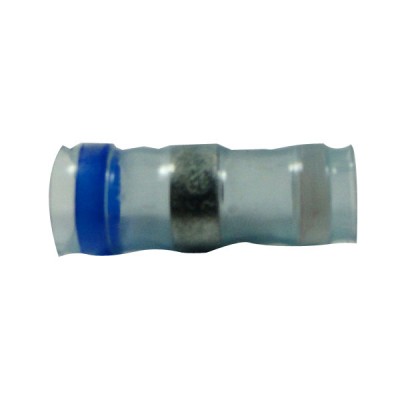

Sorry, this probably was a lapse in judgment for an application on a recreational boat, did not think this through carefully, my bad!!!
In 1998 I took over a company that manufactured mil-spec computers (ROLM Mil-Spec Computers). These nuclear hardened computers launched nuclear warhead missiles such as Trident, Peace Keeper, Tomahawk, and were rated from -40-105deg.c. Solder sleeves were used ubiquitously. The problem with using them on a boat for any critical wiring is using the proper technique for installing them. They are tricky to use!!!
high temperature Teflon coated wire should to be used (which you don't find on boats) and the use of the correct heat gun w/proper tip so that it heats the device to the correct temperature uniformly.
Raychem makes them, but I would not necessarily recommend using them unless the above conditions can be properly met. Other than that they are a very good way to splice wires.
