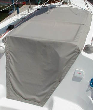

I had a cover made for mine. It covers the hole area from the mast to the hatch boards. Boat is dry as a bone since.

Ricks answer is right on it.
Most of these boats suffer from this type of leak from a heavy driving rain. I tried everything and was finally relieved of my frustration when Kelli sewed up a piece of light weight canvas to simply snap over the entire hatch area and the companion way slats. It functions well as a cooling sun shade for the interior and acrylic when the boat sets at the dock(which is all too often), during broiling summer days while sailing and as a modest skeeter deterrent too.
Just do it and be amazed. I think the canvas and snaps were less than $40. I had to buy my seamstress dinner too but I can't really add that can I;)
