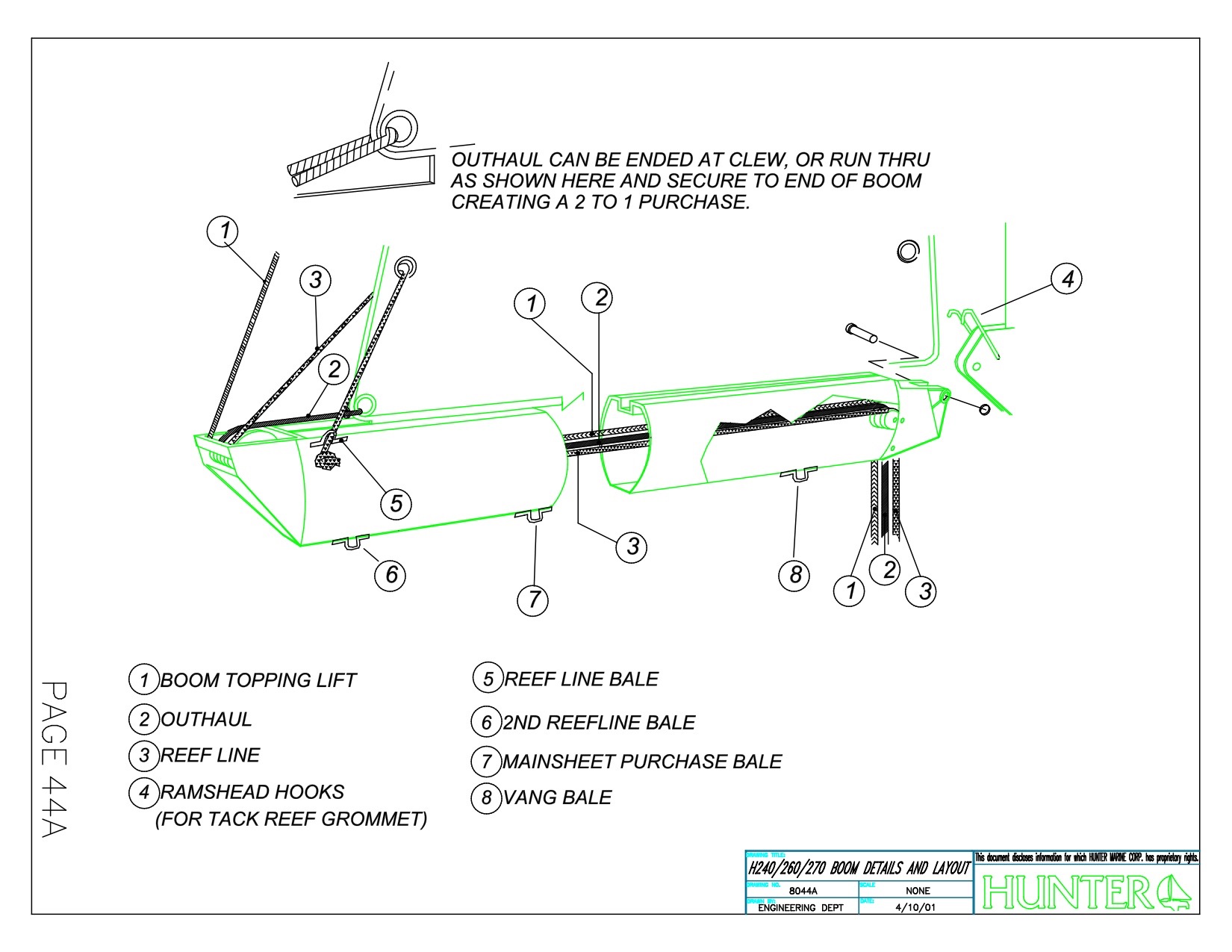

I've had one reply stating they ran the topping lift through the boom to the third unused cam cleat at the goose neck end. I would need a longer topping lift. Ever tried this?
Oct 19, 2006
337
Hunter 27-3 Brownsville, VT/Mystic, CT
Yes, my H23.5 is rigged that way and, yes, you need a much longer line, but that's how it's designed.
Here is the page from the H240/260 manual, but it's the same on the H23.5/26:

Thank you VT. I think I may give that a try. And WOW! Your manual looks MUCH better than mine. Mine doesn't even have page numbers.
Oct 19, 2006
337
You're welcome... And, that's not actually my manual. I have the same boat as you! I have an electronic copy of our H23.5 manual somewhere, but this one was the first one I found.
One thing to consider: after you run this line, put a figure-8 stopper knot in it so if the cleat releases, the boom doesn't crash on to the cockpit sole. Our stopper knot limits the scope to about a foot below parallel.

I can't help with the way to attach the top of the topping lift to the mast, as I have a 23 and it has an aluminum mast crane that may be different from yours. The boom does have the 3 sheaves like in the illustration.
One improvement you may want to consider if you intend to run a longer line through he boom: cut the current TL so it is about 2 to 3 feet short of the end of the boom when it is horizontal (I don't know if yours is wire like mine or line). Attach a small swivel block to the bottom end of this shortened "standing" part of the TL. Tie the new TL line to the end of the cast fitting at aft end of the boom, run it up through the swivel block and then down, routing it through the sheave and up the boom as diagrammed. That won't help with the issue of having to go forward to adjust it, but does give you a 2 to 1 mechanical advantage, making it easier to raise/lower the boom and also there would be half the force trying to "unjam" the jam cleat lever. Personally, I have not had mine slip even when tightening on the main sheet, but I do use a stopper (via the coiling of the excess line).
I also fashioned a sort of "line cleat" with a small nylon horn cleat and some screw eyes, that I clamped to the "running" TL line about 3 inches above where it ties to the boom aft fitting. I can pull in the TL from the cockpit, and tie it off to that cleat for convenience and temporary boom raising, and later go forward to adjust it at the jam cleat. That is mainly so I can lift the boom after lowering the main, so I can deploy my (oversized) bimini under the boom.

Excellent idea isaksp00! That would also eliminate the need to rethread the topping lift through the boom every time you restep the mast, remove the boom. Thank you!
Jun 2, 2004
3,612
Running the topping lift through the boom is a pain in the ass.
It will make the topping lift virtually unusable as you have to go all the way to the mast to cleat it and to remove the boom and store the boom in the cabin is a hassle. I did just as Dave suggested and put a block at the end of the boom along with a cleat and it is possible to adjust the topping lift with one hand while standing at the tiller.
