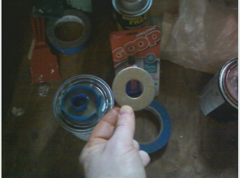

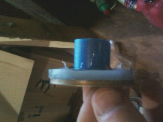

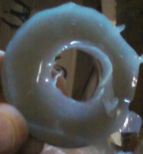

For the swing keel you need to put a rubber washer between metal washer and the keel trunk and tighten it down. You can buy rubber washers of various sizes from MacMaster Carr
https://www.mcmaster.com/#rubber-washers/=16dwon0
or you can make one by making a masking tape dam around the washer and filling in the dam with goop. Let the goop dry and peel off the tape. I've done that.. (see pics).

First boat purchased was a South Coast 22 many years ago. It was a good trailerable sailboat but I believe the above post for the keel attachment may be correct. Rubber washers are highly suggested or like material as pointed out, not bubble gum that I use to see on some boats brought in for repairs when I was a dealer. It was a little good coastal boat as well. The company I remember was on the coast I think in Lousiana or Mississippi or somewhere along there but hurricane I believe destroyed that mfg. facility.
