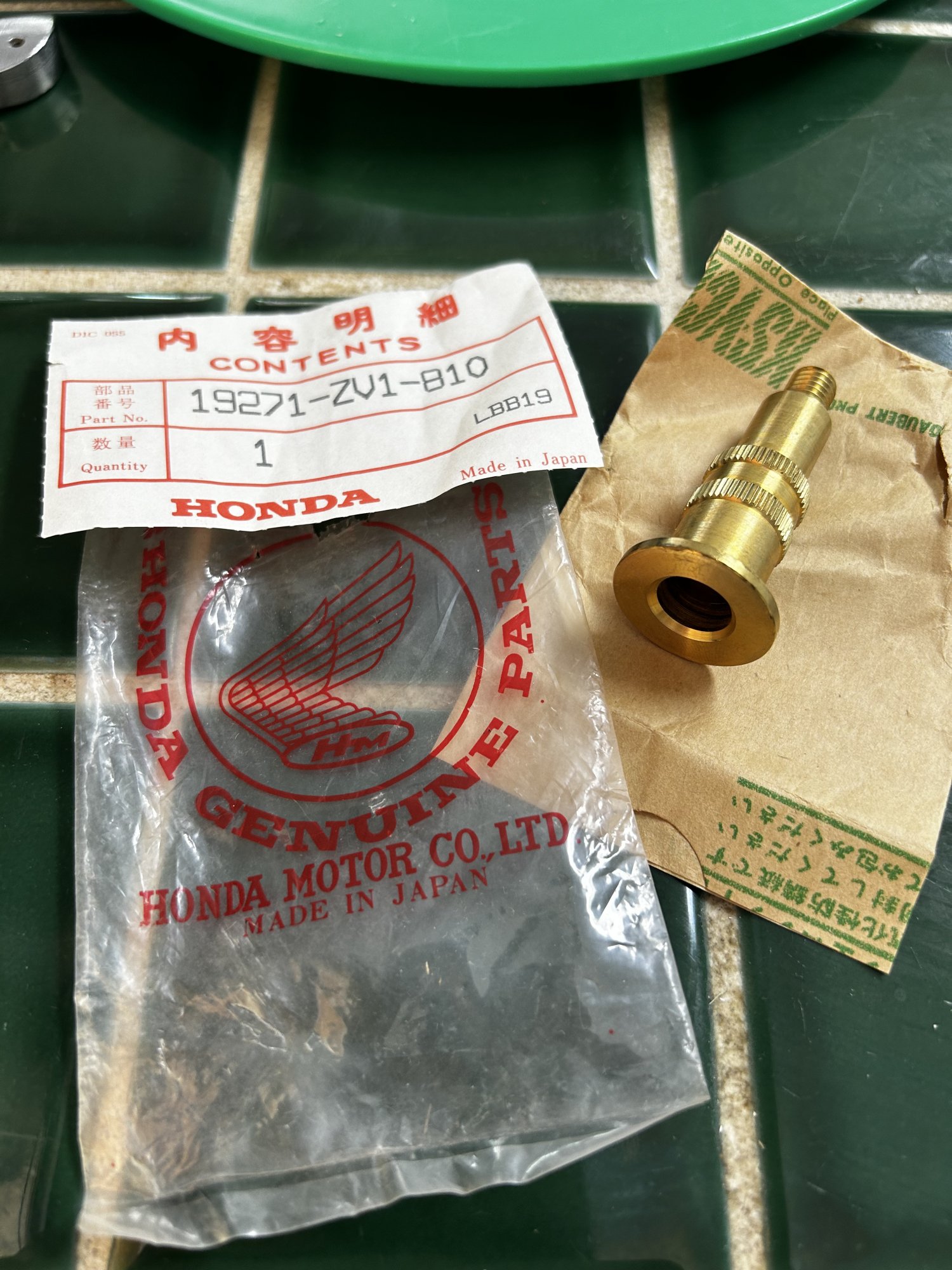

There is a special adapter (19271-ZV1-810) to drain the oil easier than just tipping the motor over a can. Which seems like a good idea to me.

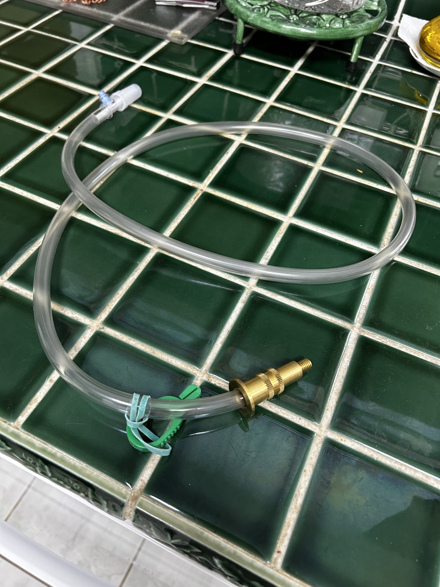

Got the adapter to drain the oil easier today. Looks like it will make it cleaner and easier. The opening is just shy of 1/2 inch. With a length of flexible hose in there, draining the oil into a container should work nicely.
Sep 26, 2008
779
Hunter 340 0 Wickford, RI

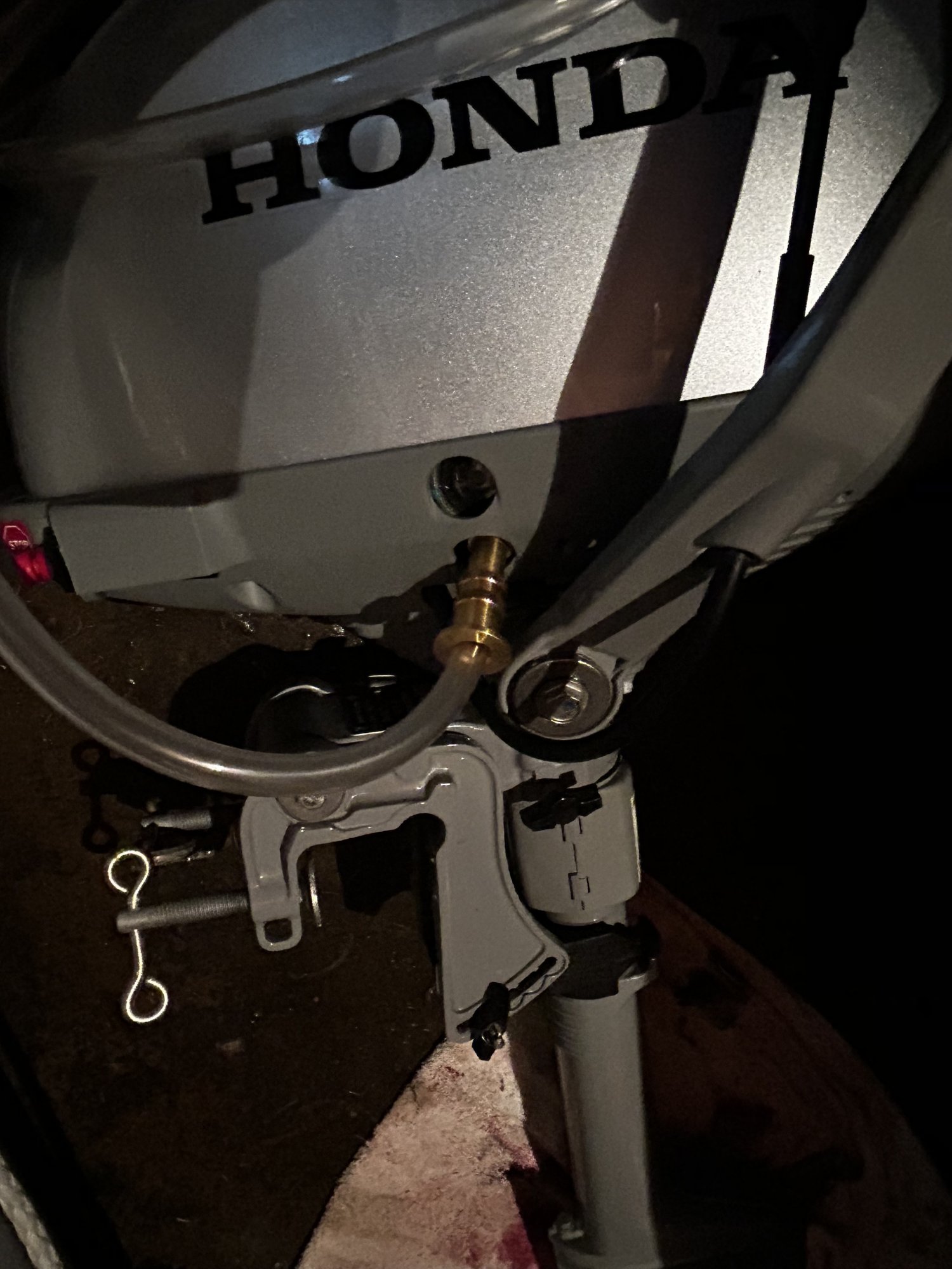

Update. The adapter works well and with the added length of tubing attached the job is clean.
But First…
You do need to lie the motor down to screw the adapter in. Don‘t try doing this while vertical, the oil will flow out.
Then stand the motor up and let the oil drain into a small container.
Were not talking much, a little over a cup of oil in the sump and the first half emptied quickly. (I didn’t warm the engine before draining the oil, only because I forgot to and had already drained the lower unit and fogged the motor.)
You do still have to tip the engine to allow the last of the oil to drain out. Looking at the sump design, it is angled back away from the drain plug just enough that the last of the oil will not drain out.
Now I will be looking to redesign my outboard motor stand to allow it to tip enough in the direction of the drain plug. This will eliminate any need to hold the motor while draining the oil.
Which was the whole idea of this in the first place.

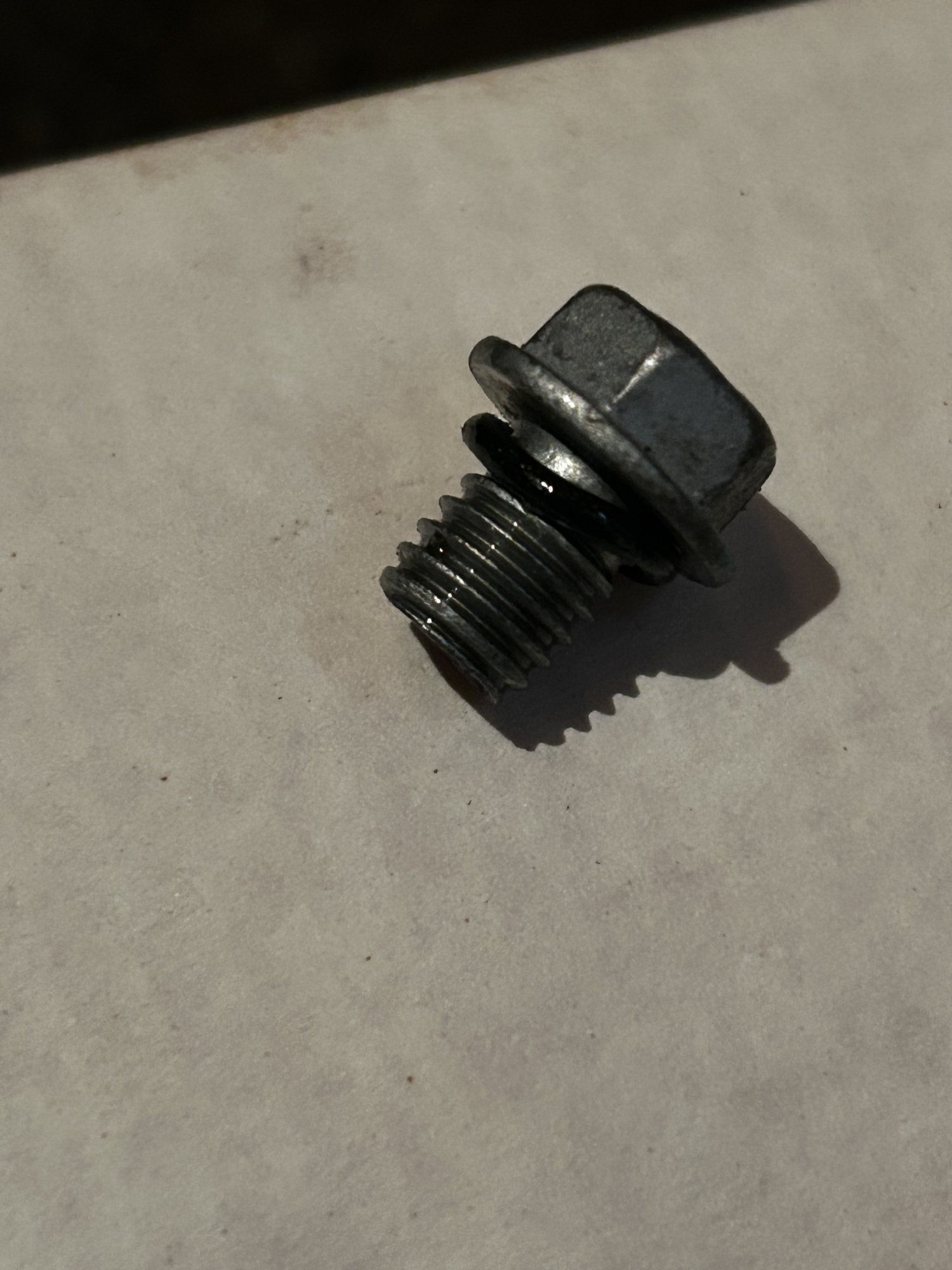

Be careful of the O Ring washers on the drain plug and oil fill cap. They’re slippery, fall off easily and roll.
