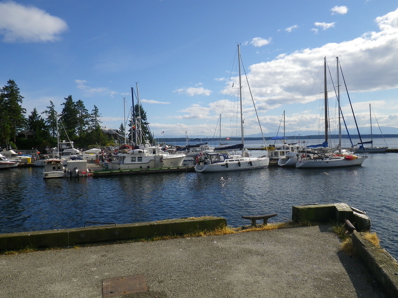

IMGP0137.jpeg Lund Marina filled up for the Shellfish Festival. Great feed of prawns and oysters today!
