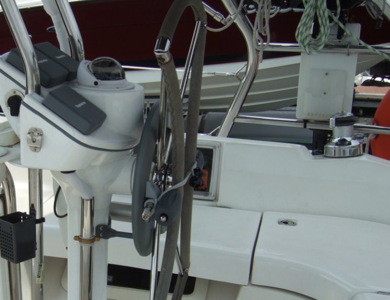

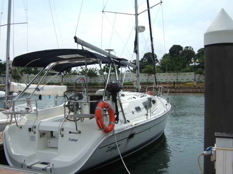

Hannah, Thanks for the reply! Looks like a good option and an area I have considered. Can you say how much , if any , does that location interfere with using the stern pulpit seat with the motor hanging on that mount!Photo attached for small outboard mounting bracet
Thanks!I purchased it from my local marine shop, The Binnacle for less then $30.00. Very cheap and takes about 2 minutes to install. The placement doesn't interfere with the person using the rail set. With the 2.5 hp outboard which is nice and light, it makes it really easy to stand on the rear transom and remove or install the outboard.
Thanks much for the detailed reply! I'll look in to these parts and see if I can't figure it out. Is that not a mount on your port stern seat in the picture you posted?I had forgotten that I had removed the motor mount so the dealer can show the boat at the Vancouver boat show. So here is the skinny:
- Hinged Tee (Sea Dog 290904 approx. $25) connects to the bottom rail,
- 125° Bow Form (Sea Dog 295126 approx. $25)
- a 7 1/4" piece of SS tubing connects these two,
- Rail Mount Motor Bracket (Sea Dog 327150 $20),
- a 5 1/4" piece of SS tubing connects the Bow Form to the bracket..
Total cost approximately $70 and a couple of pieces of 1" SS tubing.

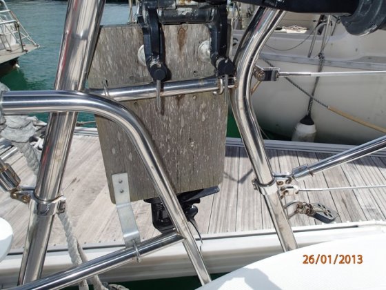

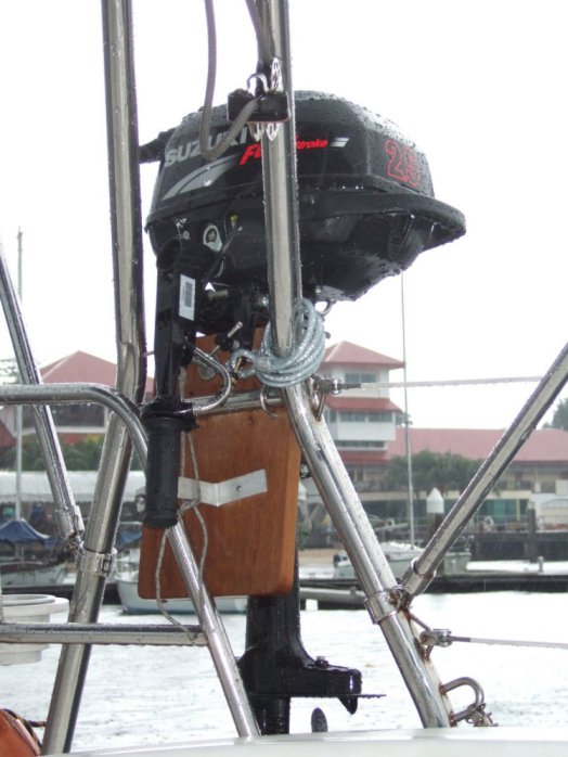

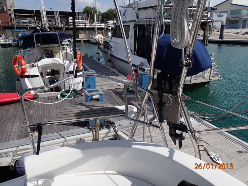

KenOr you could hung it at the small horizontal bar of the arch. That's what I did on my 326 and on friend's 33.
Len, I use a wooden chopping board (cutting board) approx 10"x12" 3/4"-1" thick. Secure to horizontal bar with 2"-3" U bolts. An aluminum strip connect mount to a lower bar to prevent mount from tipping. I'll post picture when I get home.Ken
The lower bar on the 2012 Hunter 33 is 1 1/4". What did you use for a motor mount. I had considered that option and it still sounds like the place for it; but, I couldn't find an off the shelf motor mount that would fit the bill. The upper bar is 2", I believe.
