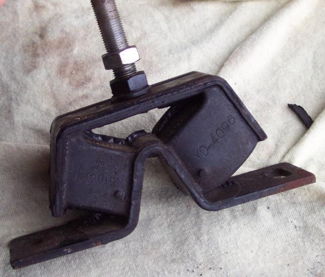

Of interest:
The old engine mounts, at least 9 years old, were found to have “bulges” in the rubber that indicates they were on the path to delaminating. Weirdly they were of two different stiffness’s (100 and 150) and more weirdly the similar ones were installed diagonally opposite each other. This gave rise to some fore and aft vibration, especially at idle.
Now the mounts have been replaced we sense the engine is smoother but not hugely so.

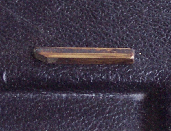

One fear I had is that the propeller/shaft key (¼” X ¼” X 2” bronze) might be wearing, leading to the possibility of the propeller slipping on the shaft and ultimately being lost, so I requested that it be replaced. As it turned out there was no sign of any wear on the shaft key.

Of interest:
