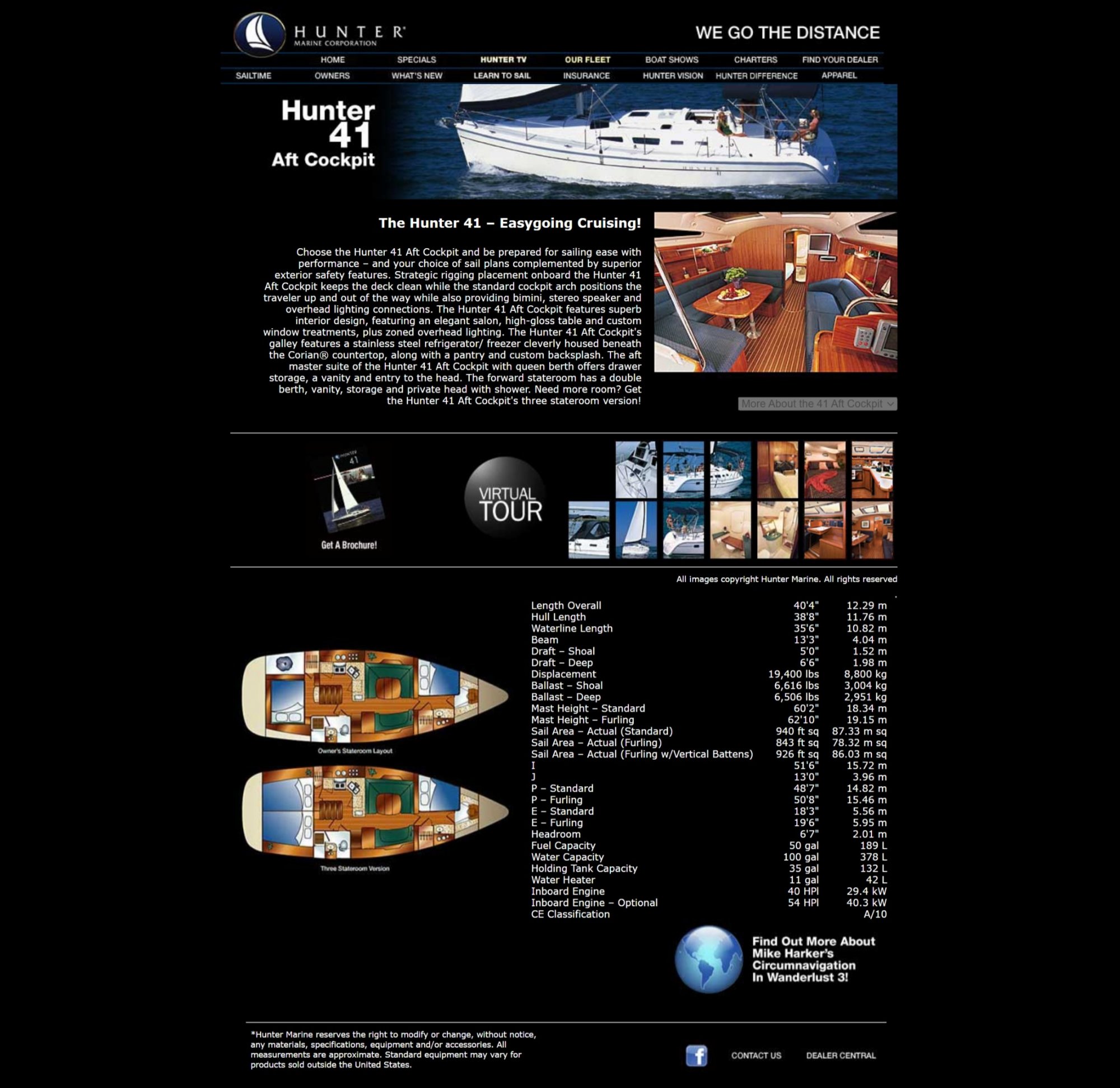

Specifications for the Hunter 41
Edit these specs
I51' 6 in
J13'
P48' 7 in (standard)
E18' 3 in (standard)
LOA40' 4 in
Hull speed8
Displacement to length ratioT
Sail area928 (standard) or 84
Capsize index1.86
Years in production2006-
Length at waterline35' 6 in
Beam13' 3 in
Draft5'/6'6in
Displacement"19,400 olbs"
Ballast6612/6506 lbs
Mast height60' 2 in (standard)
Water capacity100 gal
Fuel capacity36 gal
Engine HP56 hp diesel
Keel materialLead
