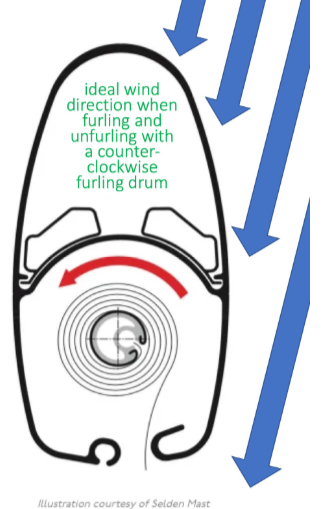

Congratulation on your new boat purchase. Now to answer your original question: Deploying a mast furled main should be relatively low effort, especially furling out IF the sail was furled into the mast tightly to begin with. The trick to the latter is to pull or winch the "furl-in" line while maintaining tension on the outhaul and while on a slight "starboard" tack (assuming you have a counter-clockwise furling drum [sail furls in counterclockwise] like my Selden mast as shown in the diagram below). Now with a tightly wound sail in the mast to unfurl you can either pull or winch the "furl-out "line or outhaul while maintaining tension on the furl-in line to keep the sail tight in the mast and while on a slight "starboard" tack. Once you get the hang of it you can pull the sail out quickly with the furl out line and visa versa with the furl line with little effort. You might refer to the modern sailing article on in-mast furling mainsails in the link below.

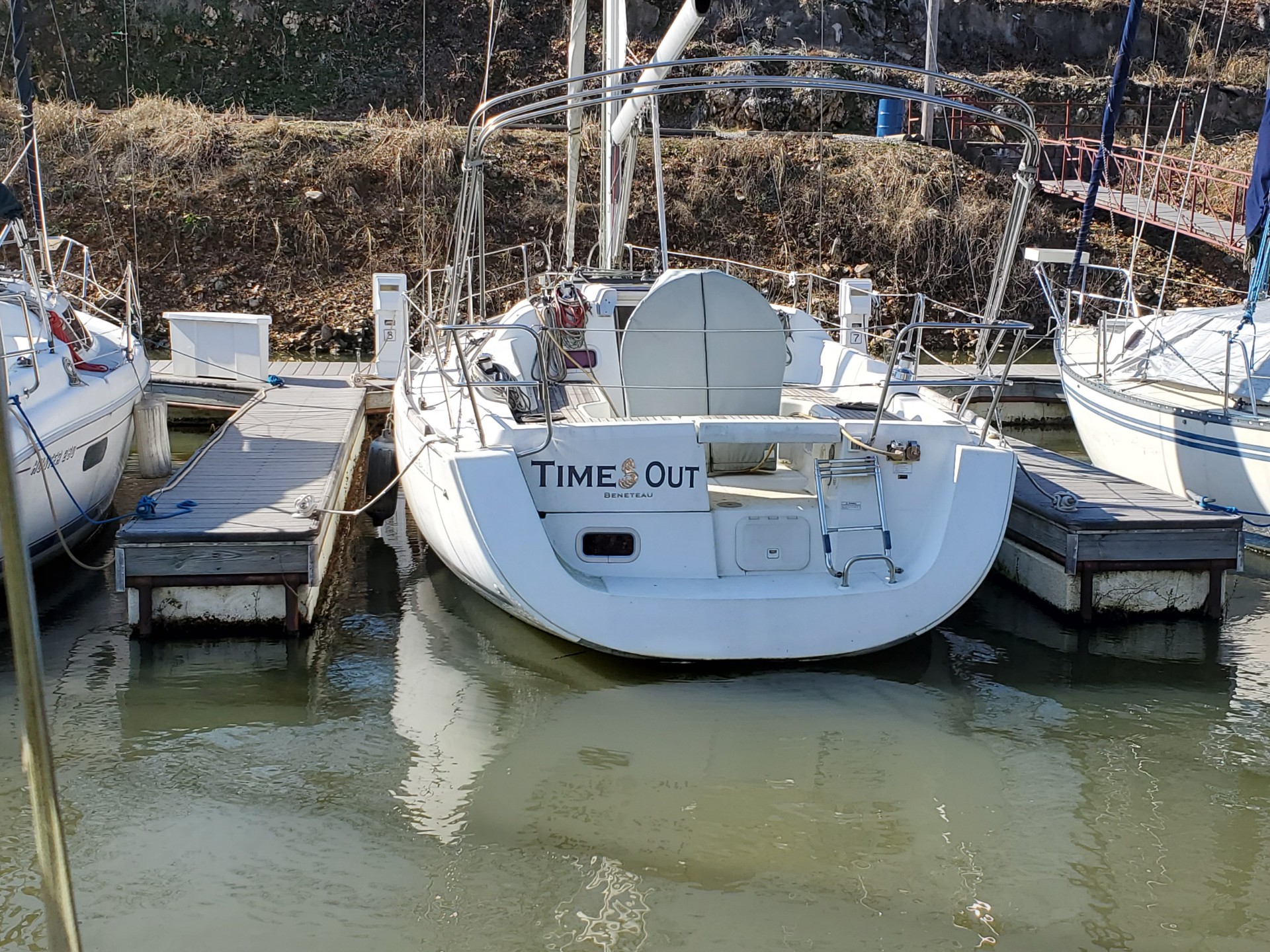

Does this one have a name or are you going to take your chances with the evil boat spirits again. :biggrin:

The OP and I are friends in the real world. He introduced me to sailing. I just like to give him a hard time about his last boat not having a name. :biggrin:
