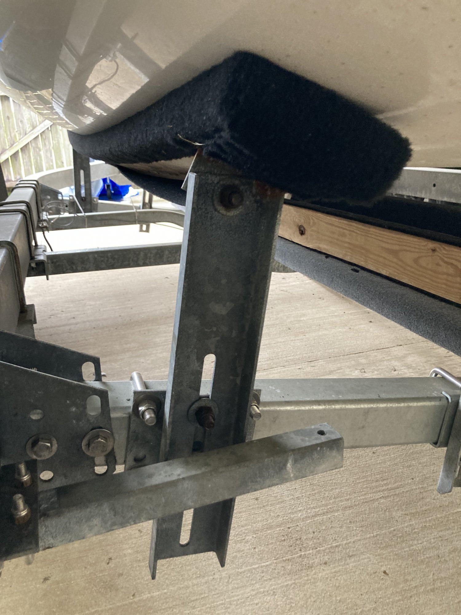

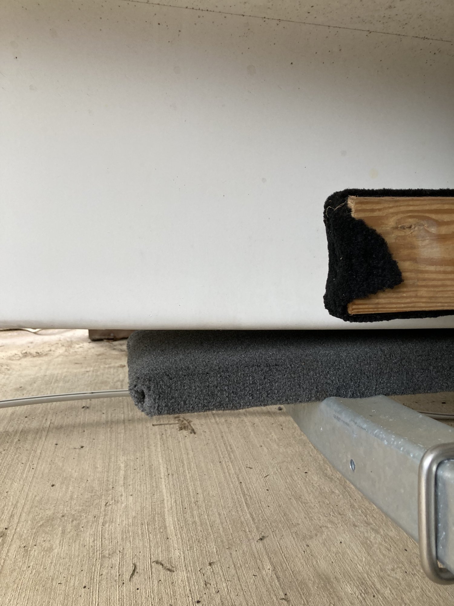

One of the items on my list was replacing the trailer winch. When I released the winch, the bow of the boat shot straight up 2 to 3 inches. After looking closer, I realized the front of the keel is no longer sitting on the center bunk board. The front side bunk supports are 2inches higher than the rear side bunk supports. Also the keel is 16 inches toward the bow from the center bunk board and the rear of the keel is touching the center bunk board. Another project on the list is to change the side bunk boards and brackets when I adjust the boat on trailer.

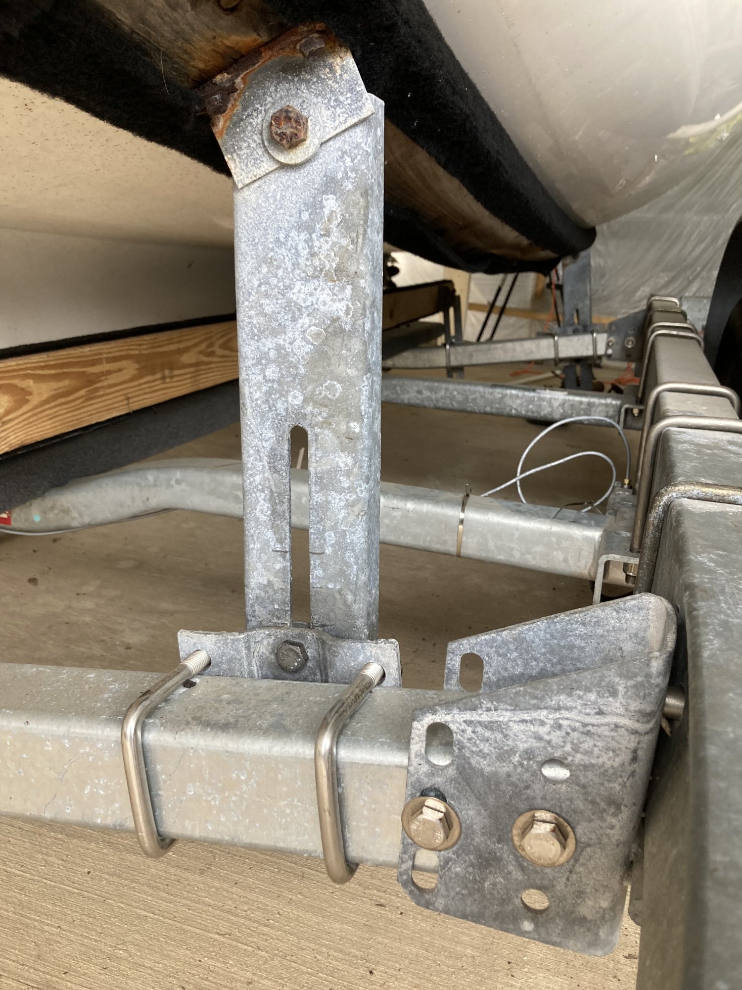

As far as the front of the keel not sitting on centerboard, the front bracket of the side bunk boards are two inches taller than the rear brackets and I think this is causing the front of the keel to be sitting two inches off of the centerboard.

Ok sorry about that, I miss spoke. Looking back at the previous post i had mention centerboard. What I meant to say was the Bottom or center bunk board on trailer. The first and second pictures in the original post show the front of keel not sitting on the bottom bunk board. The rear of the keel is touching the bottom bunk board but the front of the keel is not touching.
