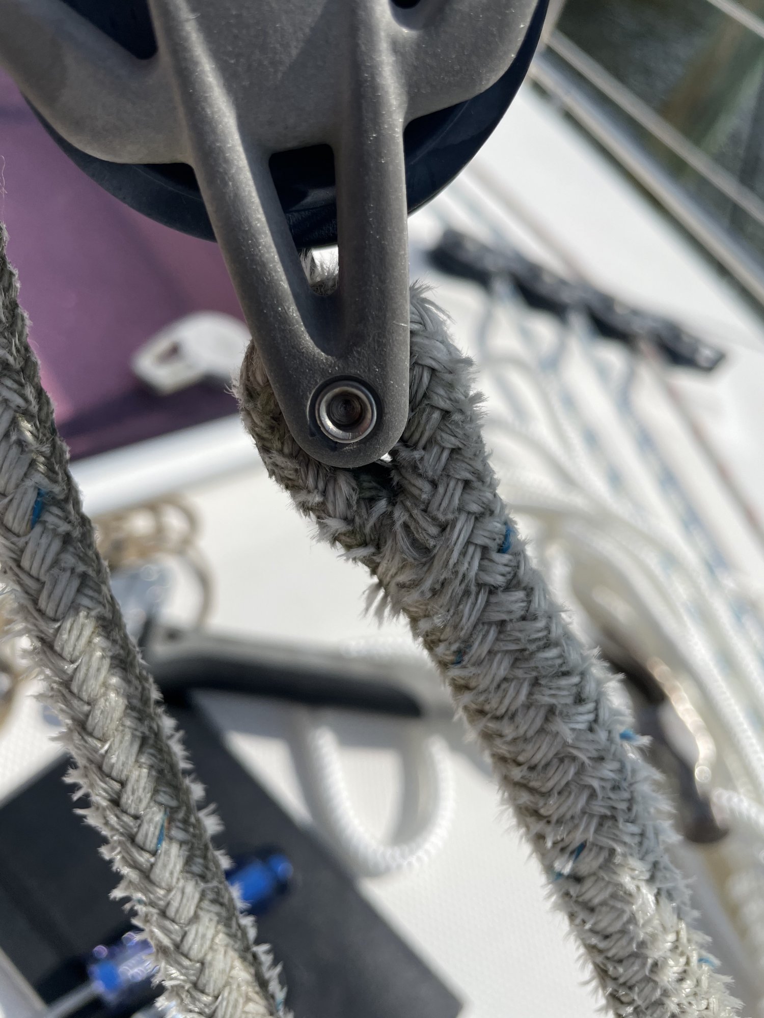

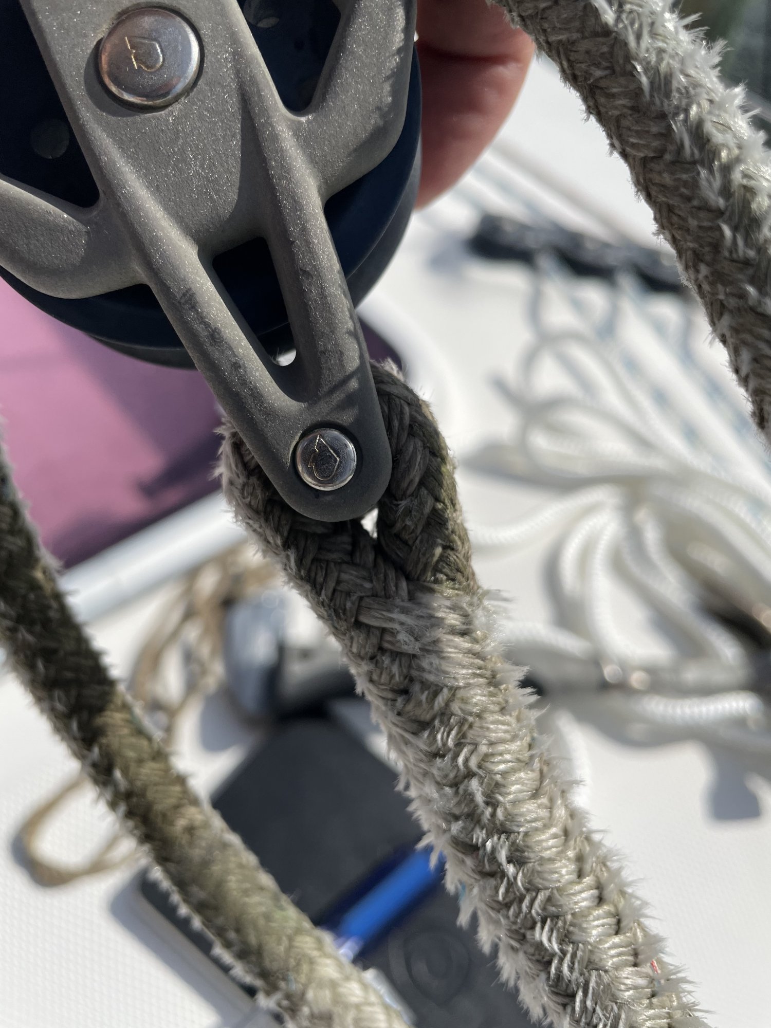

I have several of these blocks (one for boom vang pictured). The new lines have eyes spliced in. I assumed (perhaps stupidly) that these pins simply pressed out so I could replace the line. Now I'm not so sure. How do I get this pin out to replace this line?

Yep.....time to replace the vang control line. The fiddle block looks like they need a special key to screw out the pin. might check with block manufacturer if the PO did not leave you one. Could replace fiddle block with one that has a clevis pin and ring ding like I have on my Hunter 46.
Or, worst case, drill out the old pin and replace with new clevis pin and ring ding.
Could those pins be a "permanent" part of the block and the old lines have been spliced directly to them?

I bloody hope not! That's gonna be a few hundred more $ but worse, likely a week delay again :(
tbh those "pins" (is the correct term "bail"?) look like the olde schoole brake lining rivets or the rivets used today on light aircraft brake linings, ie the one end looks like it is a "factory" head and the other like it is a "shop head".
The eye looks awfully tight to have been spliced around the pin. I tried gently to drive it out using a small socket as a backer and a small drift. It didn't budge.
Drilling out might be an option assuming I can find a suitable pin. That's my next step I think.

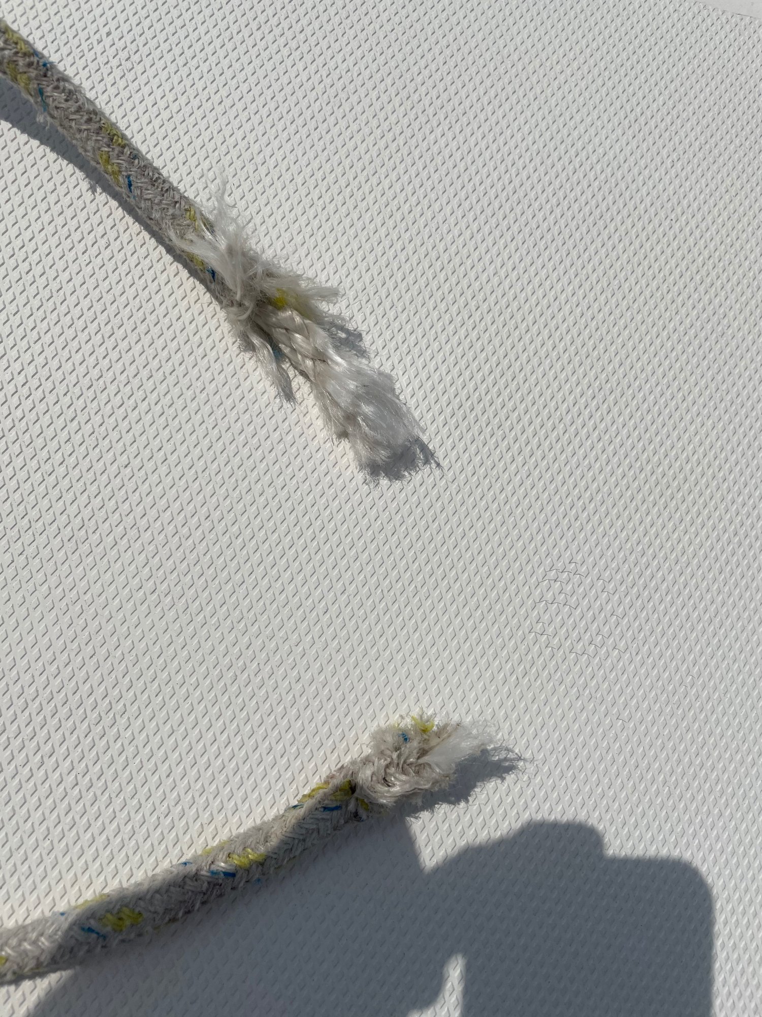

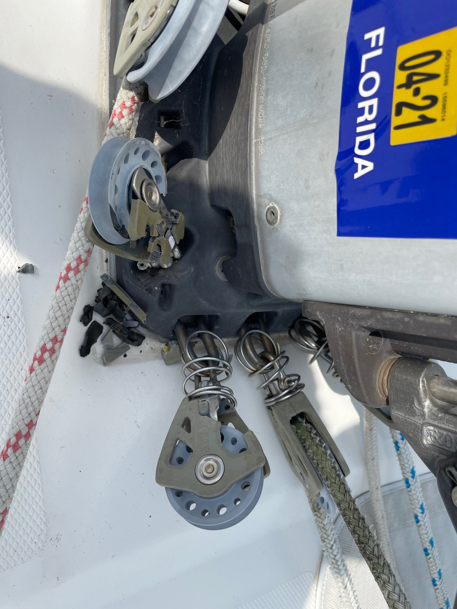

Yes, time to replace ALL lines. I'm replacing every piece of running rigging and some of the blocks etc as well. If the jib halyard is in good shape I may re-purpose for a spinnaker halyard (that being the only option this boat didn't have) I saw when I viewed the boat prior to purchase that the lines were pretty bad, and it was called out on the survey. Thought they were good enough to go for a day sail or two while I was waiting for them to be made up. I was wrong. Right outside the Ft. Pierce inlet main furling line jammed, then parted. Had to rush to get the main down and under control. Also found the two turning blocks at the mast step were fractured. Idk exactly how, maybe were cracked and missed on survey. It was real sporty for a few minutes.

To close this out, the quickest and easiest route was to purchase a Harken 60 mm Aluminum Element Block (6261) from West Marine locally. $65 out the door and done in 40 minutes including round trip time to the store. Now on to the final challenge, the main halyard which is giving me fits, new thread for that.
