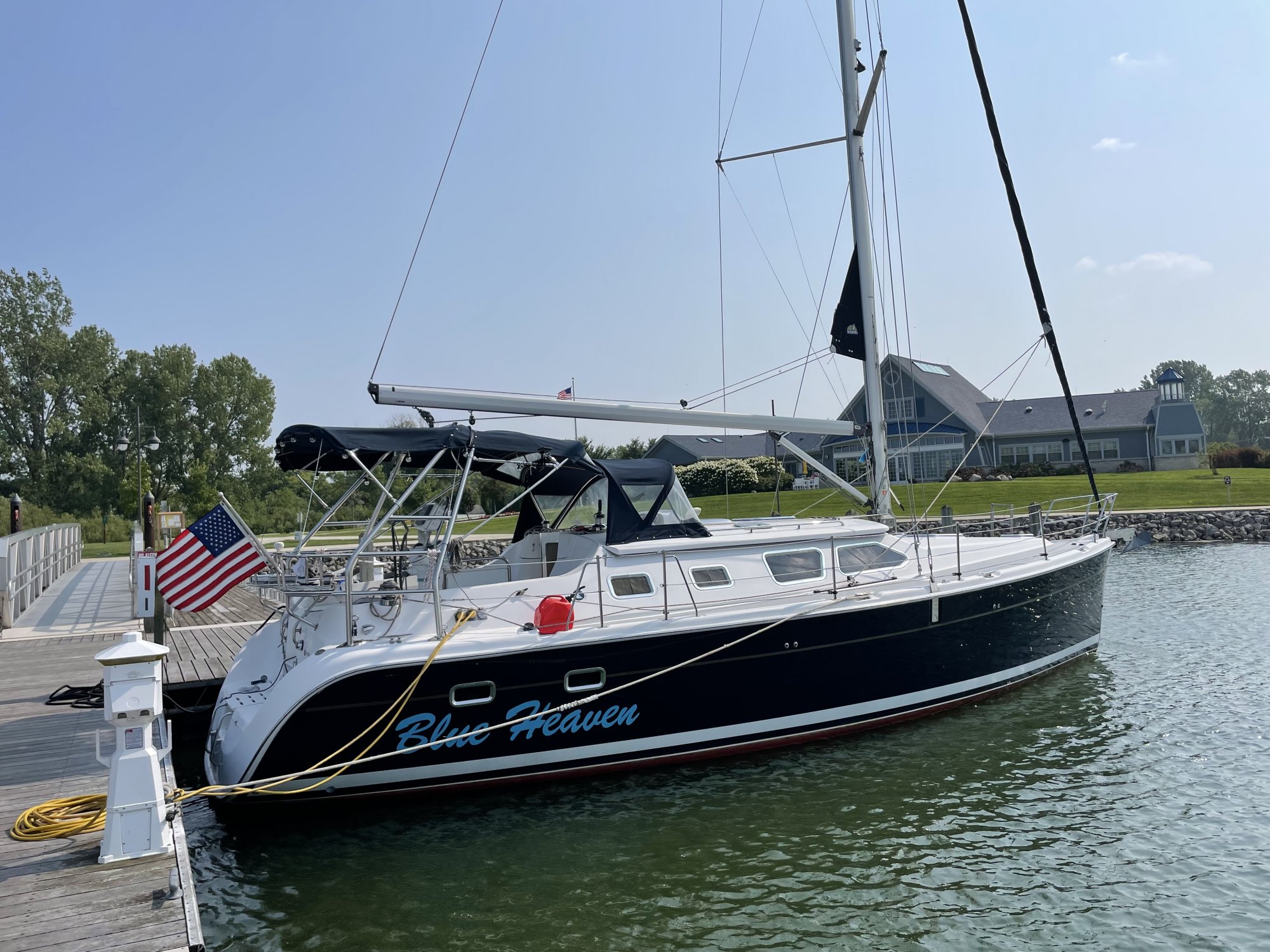

So we’ve owned the boat for three weeks now and couldn’t be happier with it. For the money it’s definitely a lot of bang for the buck. She’s fast, handles well and has the interior of a small house. Since it IS our house it’s pretty perfect. I’ve ordered all new electronics, solar panels, batteries, a new main, building davits, new canvas, etc. As we plan to do extended cruises on the boat I’m simply wondering if I am missing anything? When we go I want to stay gone so I want to get it as right as I can before we take off. Thoughts? Suggestions?

Beautiful boat and one I can definitely relate to, I notice that you have no strain relief on your shore power cords in that picture, you need to tie a line from cords to one of the horizontal bars on the arch to relieve the tension on the plugs, they will last much longer that way.

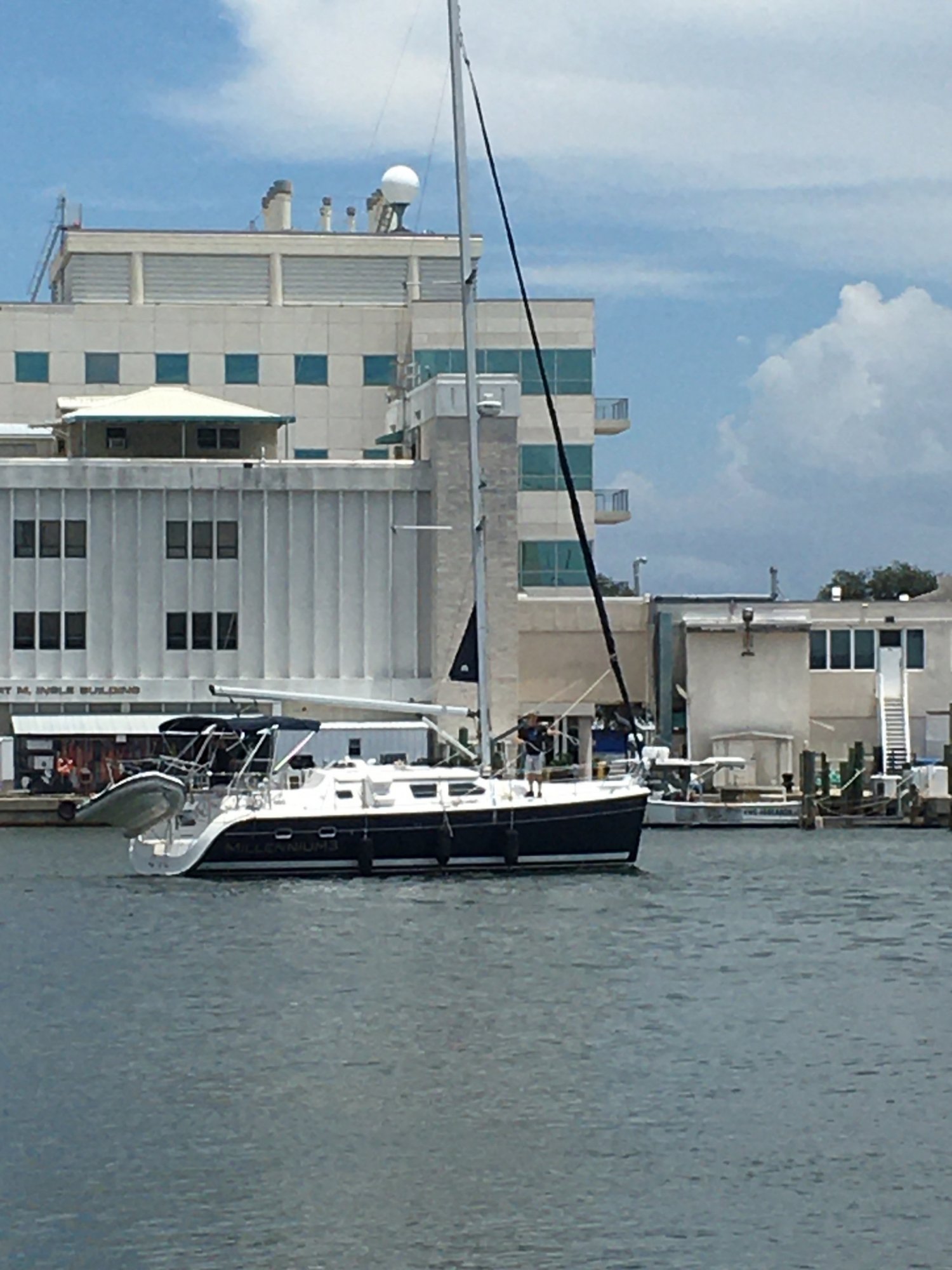

I have heard many times, the two best days in the life of a boat owner is the day he buys and the day he sells. When our 41 was sold and left the marina, we felt as if we lost a child. The broker sent me the last picture I have of the 41 sailing to a new home.
