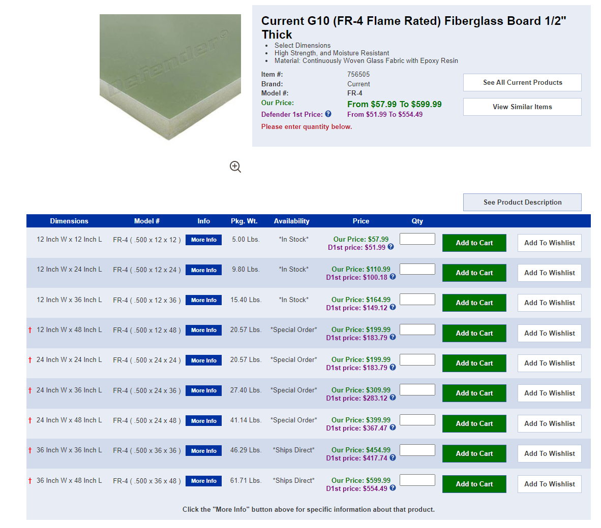

  • Motor Mount: Reinforce interior transom with G10 backing plates fastented to transom interior fiberglass surfaces using a proper adhesive.
    • Jamestown Distributors has 12" x 12" x 1/4" G10 panels in stock. They also have larger 1/2" panels, but yikes they are expensive.
    • Was thinking the right adhesive to use would be a thickened epoxy like six10 or equivalent.
    • After installing the above, use the existing motor mount holes as guides to drill through the G10 plates, and then through-bolt the motor mount.
    • Note: The above would require the removal of the existing interior backing plates, assuming they are surface-mounted (they appear to be).

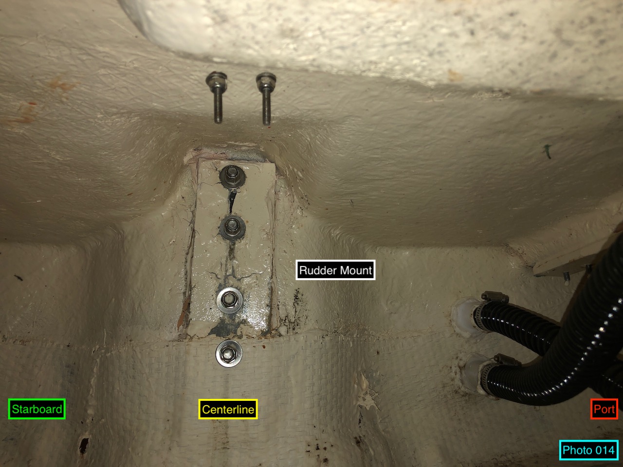

  • Rudder Mount: TBD; I need to get a closer look and shoot more photos. That said, if it is washers on fiberglass, then at a minimum, I'd think about doing the following:
    • Remove the rudder + mount.
    • Clean up / remove existing backing material (if it exists).
    • Add layers of G10 backing plates + thickened epoxy.
    • Drill through the G10 backing plates using the rudder mount as a guide.
    • Reinstall rudder mount using longer bolts.

Concur. I measured the area yesterday, and it looks like I can fit up to two 12x12x1/4 G10 plates under the transom from the starboard side of the transom to the starboard side of the rudder mount hump. Another alternative would be to replace the narrow strips with 6x12x1/4 G10 plates if that would be enough to stop the flexing.

Which ones? The pedestal mount bolts? The rudder mount bolts? If the latter, I have one update that makes me feel better: The rudder mount bolts appear to pass through an aluminum backing plate. I'm ~90% confident about this since I couldn't reach the plate for a scratch / poke test yesterday when taking the attached photo.

By the way at least one of the pedestal bolts are leaking.
You thinking port side aft? There's a bit of "not as clean" around that bolt. I reposted all of the photos with updated labels and numbering; see photo 012.

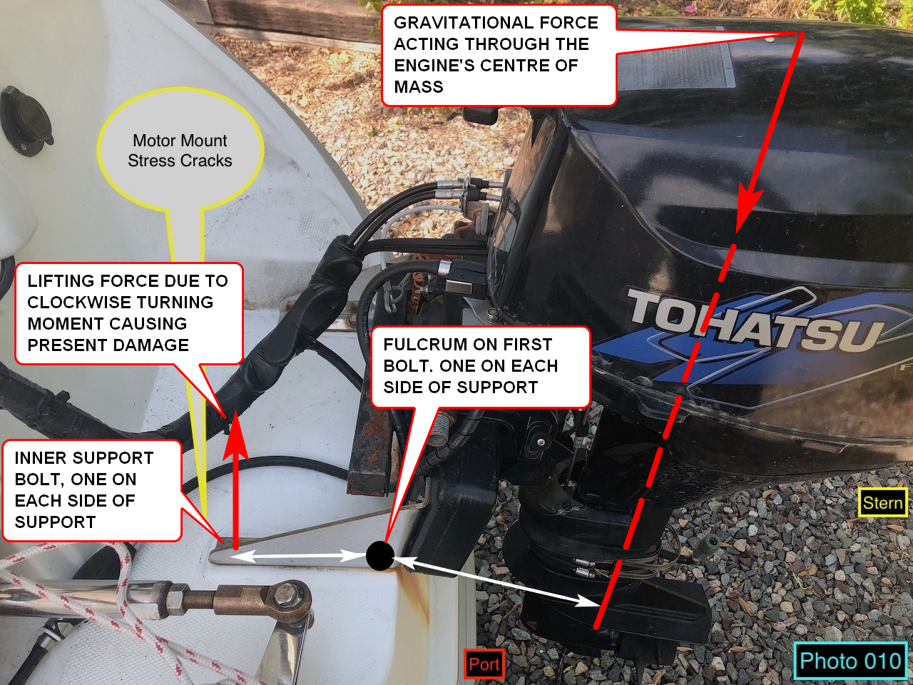

After looking again and again at photos #8 and #10, I am convinced that your only problem shown in these pictures was due to towing the boat with the motor mounted on the transom as well as not being properly supported. You mentioned the weight of your engine somewhere back in these posts and I seem to remember it was no lightweight. I can imagine it created one hell of a static lifting force on those inner bolts when looking at pic #10 but add the bumping of going down a road and ouch, ouch, ouch :yikes: :yikes: :yikes: !
I think if you vow never to tow the boat with the motor on the stern again, your problems will never occur again after you have repaired the existing damage.
1. Install sufficient backing plates of 1/4" aluminum with full contact backing as previously discussed. No need to go fancy with G10 unless you're fixated on it.
2. Grind out all of the structural damage to the FG shown in #1 and #2 and either soak with thinned epoxy if heavily damaged or just fill with gel coat if damage is light. Pure white gel coat should be a perfect match for your boat. It's a perfect match on my boat for all of the spider cracks I've patched over the years.
You'll want to do some inner soul searching before doing the repairs on the damaged motor supports. Do you want to open up the broken FG and fill with thinned epoxy and then quickly clamp the supports into place or is the damage not that severe ? I'm thinking about cracking your nice gel coat repair job several years down the road. I think you get my drift.
I think the rest of your gel cracks are simply due to age. I've got gel coat spider cracks in the most inexplainable locations you could imagine. No source of stress but there they are. Maybe they appear just to keep me occupied and away from the beer parlor.

Like the manufacturer, I did the math but found that their support bar is not what they claim it to be. I hope the following will explain. No math, just vectors:
1. The weight of the OB engine pushes straight down.
2. The centre of mass of the engine overhangs the engine support by some distance.
3. The entire weight of the engine is supported upwards by the FG at the rear edge of the support platform. Bouncing down the road adds as much as 2-3g force to this small area.
4. This small supporting FG area acts as a fulcrum
4. The overhanging engine also causes a clockwise turning moment which lifts the damaged FG portion of the engine supports.
These forces are shown below:
If you take note of the support rod of the Extreme Max product, it can only offer a horizontal force as shown:
As the engine sits motionless, the bar will push aft to counter the clockwise turning moment caused by the weight of the motor. This will in turn eliminate the upward force on the damaged FG. The downward force due to the engine is not reduced by the support bar.
Unfortunately, this arrangement requires zero movement between all connecting parts or there will be lift on the damaged FG you now have. For this reason, the Extreme Max will offer next to no support to avoid damage to the inner support.
This is a common method of support in welded structures but again, these have no possibility of movement.
As far as current use of the boat, any way you can lash the motor to the interior of the boat while transporting it ?
Great job with the markup; makes it easy to follow. Your vectors confirm what I was thinking.
Makes sense. However, if the extreme max support bar can be extended far enough, it would be able to support the motor in its tipped-forward position.
Agreed. I received the support bar today, so I will assemble it and see how much play there is. Assuming there is no play and that it is long enough to support the motor when tipped forward, this could end up being a viable option.
Yes, I could lash the motor to a strong point while it is tipped up. However, I am leaning toward removing it for transport, because that feels like the safest option.
You may be able to salvage some use out of the contraption for the final permanent solution.
Again, if this problem were mine I would be be completely satisfied with a permanent solution consisting of:
1. Installing improved backing plates behind the supports.
2. Grinding out the damage in the FG and refilling with whatever is required depending on the depth of damage. I would do it without the SS support in place to ensure no stresses added to the FG and no future cracking of the repaired gel coat.
3. Install the Extreme Max to allow travelling with the motor in the tipped forward position.
4. Doing cosmetic repairs on the other spider cracks when bored.
Post again once you start the permanent repairs this fall/winter either here or private message me. I'd really enjoy seeing how the repairs go.

The gouge on port side of rudder on transom was hit by an object and could have caused some gel coat cracks but no fiberglass issues based on nothing seen.
Rudder base inside bolted on top of aluminum block but suggested use of larger washers.
