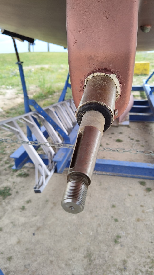

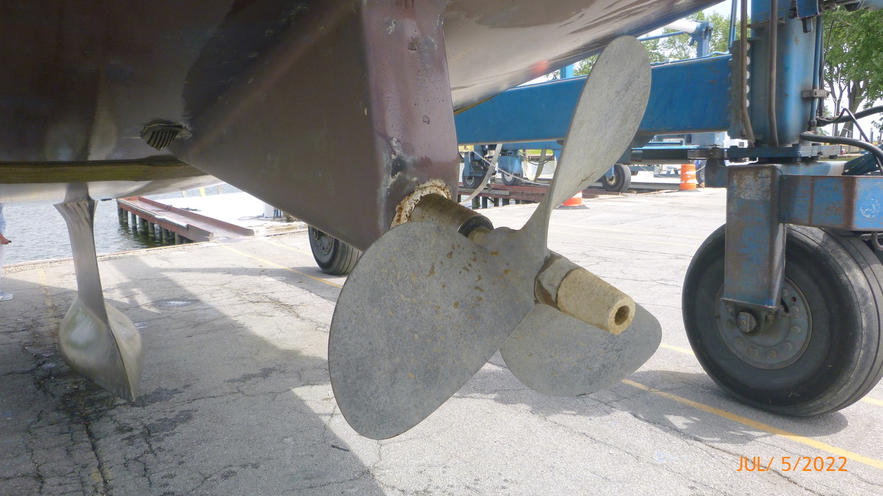

A sea trial, earlier this week, on a 2006 Beneteau 423 revealed a Volvo Pentax engine / prop shaft vibration. Even at a moderate 1500 rpm I could see significant visual deflection of the shaft when under way as I was inspecting the engine back side compartment. The vibration can also be felt in the cockpit and increases with significant intensity up to 2900 rpm, where I would called it severe. The obvious vibration is what pushed me and the surveyor to check further while underway with the engine.
The sea trial was done after the haul out inspection. No lateral shaft movement was felt when the propeller and shaft was inspected while on the hard before splashing back in for the sea trial.
I am several hundred miles from the boat and a subsequent inspection done by the "broker/mechanic" did not show any alignment issues between the engine and shaft coupling. He suspects a shaft and/or propeller issue.
The vessel has a 3 blade fix propeller, see attached pictures.
This is the only major issue (other then some other medium and small stuff, which are normal for a 2006, that needs to be addressed) that is holding up the purchase process until the root cause of this vibration is identified and corrected.
Any feedback on the vibration issue would be greatly appreciated, as well as, any other recommendations as to shaft and propeller choice, if it they need to be replaced.

It looks like no water flow through the Cutlass Bearing. Some sort sealant against the strut.
But that set up is new to me.

That’s a normal Beneteau set up. What you see coming out of the skeg is a stainless shaft log. Sealant is applied where the log comes out of the skeg. The shaft goes through the log with a black rubber cutlass bearing at the very back of the log. They usually have a dripless shaft seal and a way of injecting water behind the seal. The water flows between the log and the shaft, out the grooves in the cutlass.
The fact that there was no lateral play in the shaft suggests that the cutlass is adequately lubricated, otherwise it would heat up and wear out.
I would lean toward potential motor mount wear as the cause of the vibration.

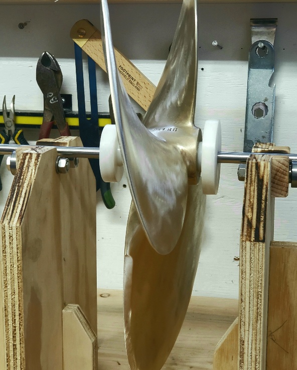

5. Balance propeller.
Even if you are considering installing Max Prop, you should balance your fixed 3 blade prop to know if unbalanced prop was causing vibrations. Your pics show not damaged propeller, so most likely shaft is strait. Vibrations probably are due to unbalanced propeller OR engine misalignment.

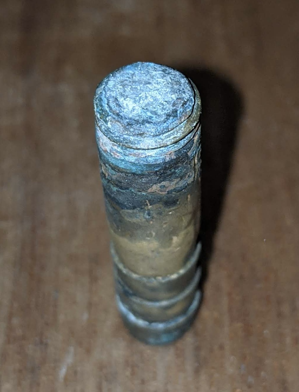

NOTE: Now It is good time to check if barbed fitting epoxied in the stern tube is not PLUGGED WITH SALTS (especially if you don’t know if PO checked or replaced barb fitting). Gently, not breaking the barb fitting in the process, remove from the fitting 9.5mm I.D. rubber hose. IT IS SAFER TO CUT THE HOSE very close to the fitting to prevent breakage. When hose is removed, check if you can blow air through the fitting. If not, poke with stiff wire (small size Allen key will work). Best will be to replace existing fitting with a new one.
If interested I will show you (and other Beneteau owners) how to make DIY, never corroding Titanium fitting.
Attached picture shows completely blocked with salts, barbed fitting removed from Beneteau First 45.5 in my marina.

I was thinking mounts as I read this. That prop is amazingly clean. BTW, my Bene came with a MaxProp from the previous owner and I love it.

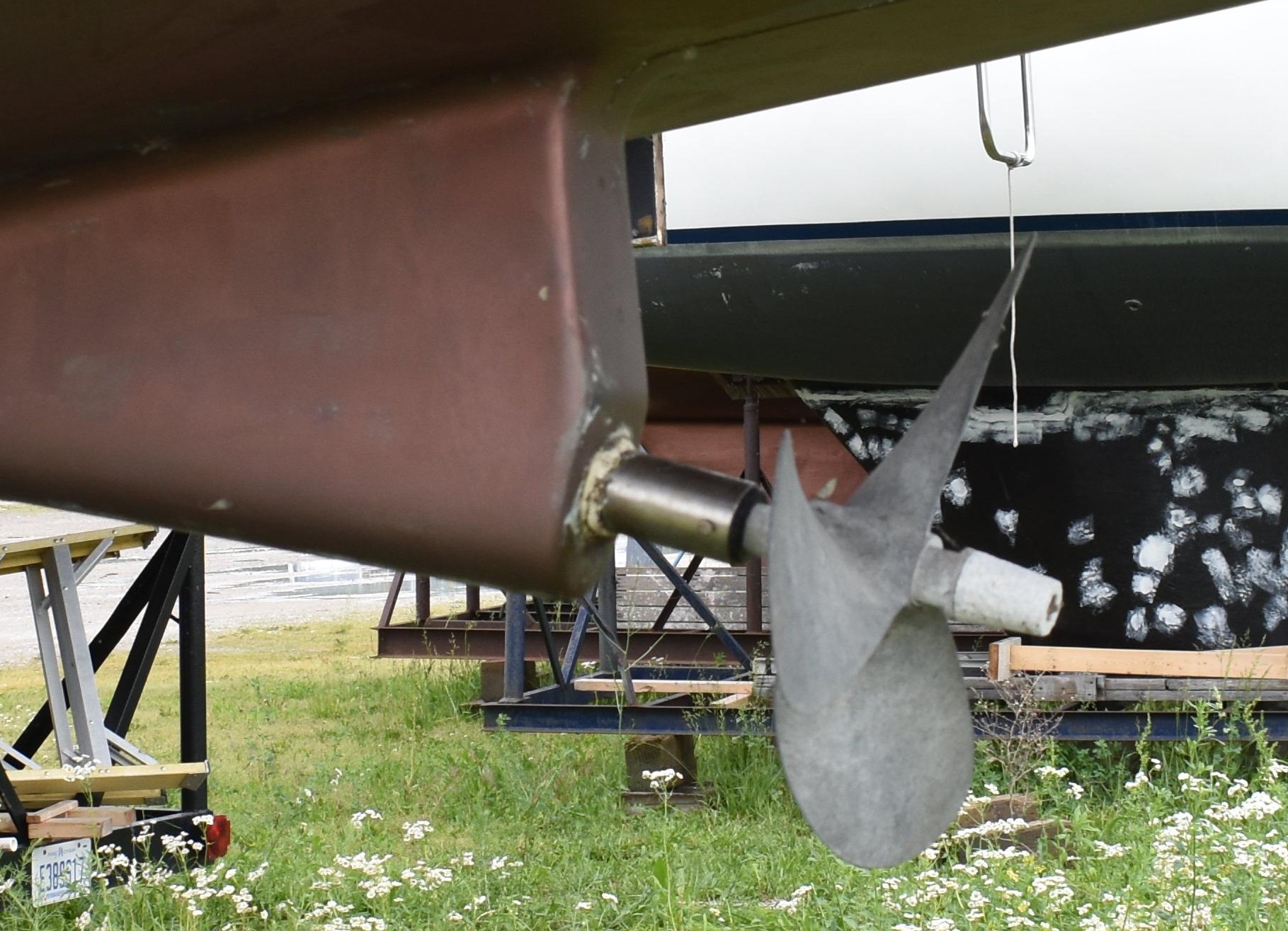

Hauled out the Beneteau 423 on Friday to further investigate the vibration issue and remove the old fixed blade prop today.
Found:
1) up/down play in the cutlass bearing, more then I would like to see.
2) 1 blade of the fix blade prop bent back by at least a 1/4"+ compared to the other 2.
3) After bending back the SS washer, the prop nut came loose with almost no effort and the prop was pulled off also with little effort, which leads us to believe that it was probably not seated completed tights on the prop shaft.
Will check out the prop shaft in the next few days.
I now have a new PYI 3 blade Max-Prop on order and will have the old prop serviced locally and keep as a spare.
I intend to replace the cutlass bearing, now need to find where I can purchase it. PYI suggested I contact Ward at Beneteau USA. Will try that on Monday.
