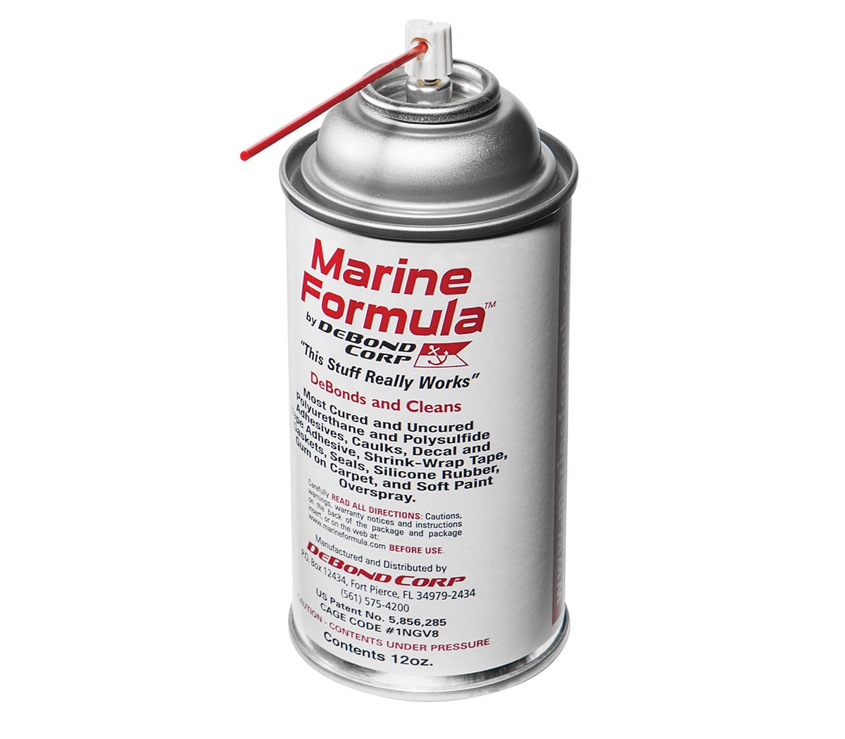

Hopefully it's not 5200 ..... you can't buy marine formula by Debond on Canada. Best I can do is captain phab:

5200 solvents:
Don't know the writer from Adam or more importantly, who he's associated with. Marine Formula by DeBond Corp. is worth a gamble (anything is) but as far as acetone goes, no effect at all on 5200. Your choice.

Next job will be to scrape the 5200 off of the deck and arch footings. Will try the heat gun again as well as a couple of adhesive removers (including Re-Mov as suggested). Practical Sailor says that Marine Formula by DeBond Corp is the best but you can't buy that in Canada for some reason. I think they got in trouble with product mislabelling and are banned for now. Will let you know how all of this goes and will post some pictures.
