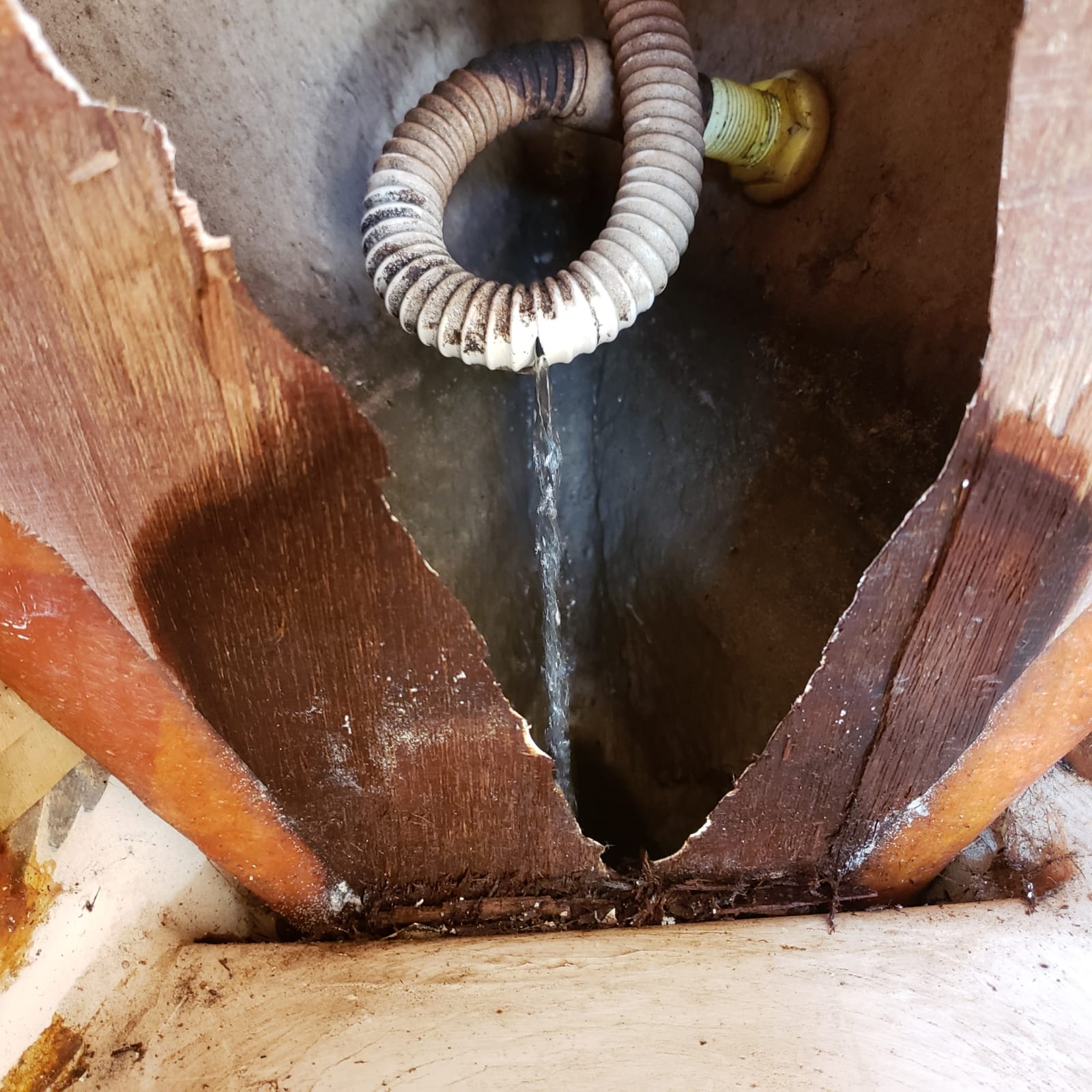

Rain water, the bottom is fine. Our biggest leak was from the anchor locker drain hose that had a loop before going overboard. In the winter it would fill with water and freeze.
