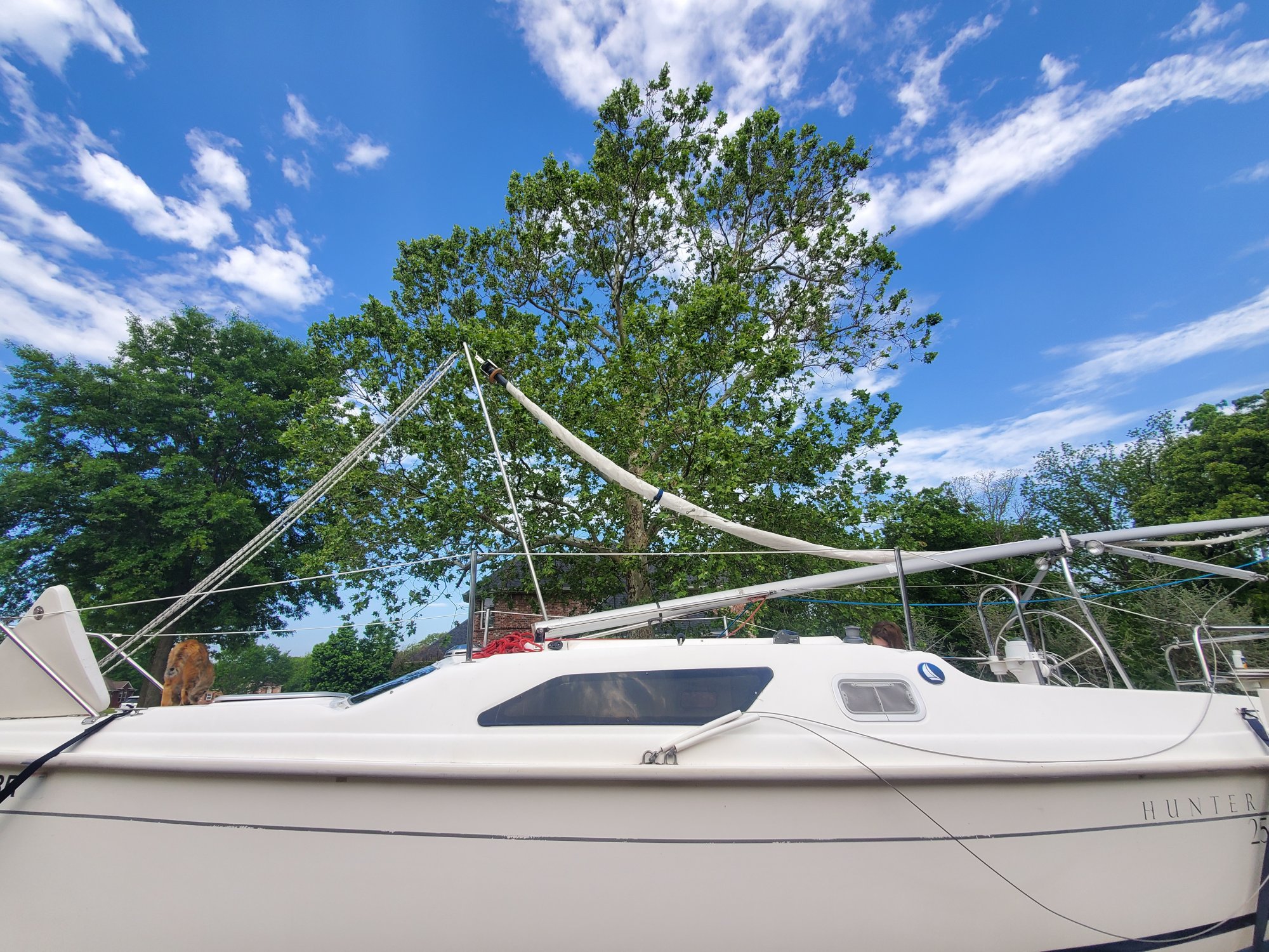

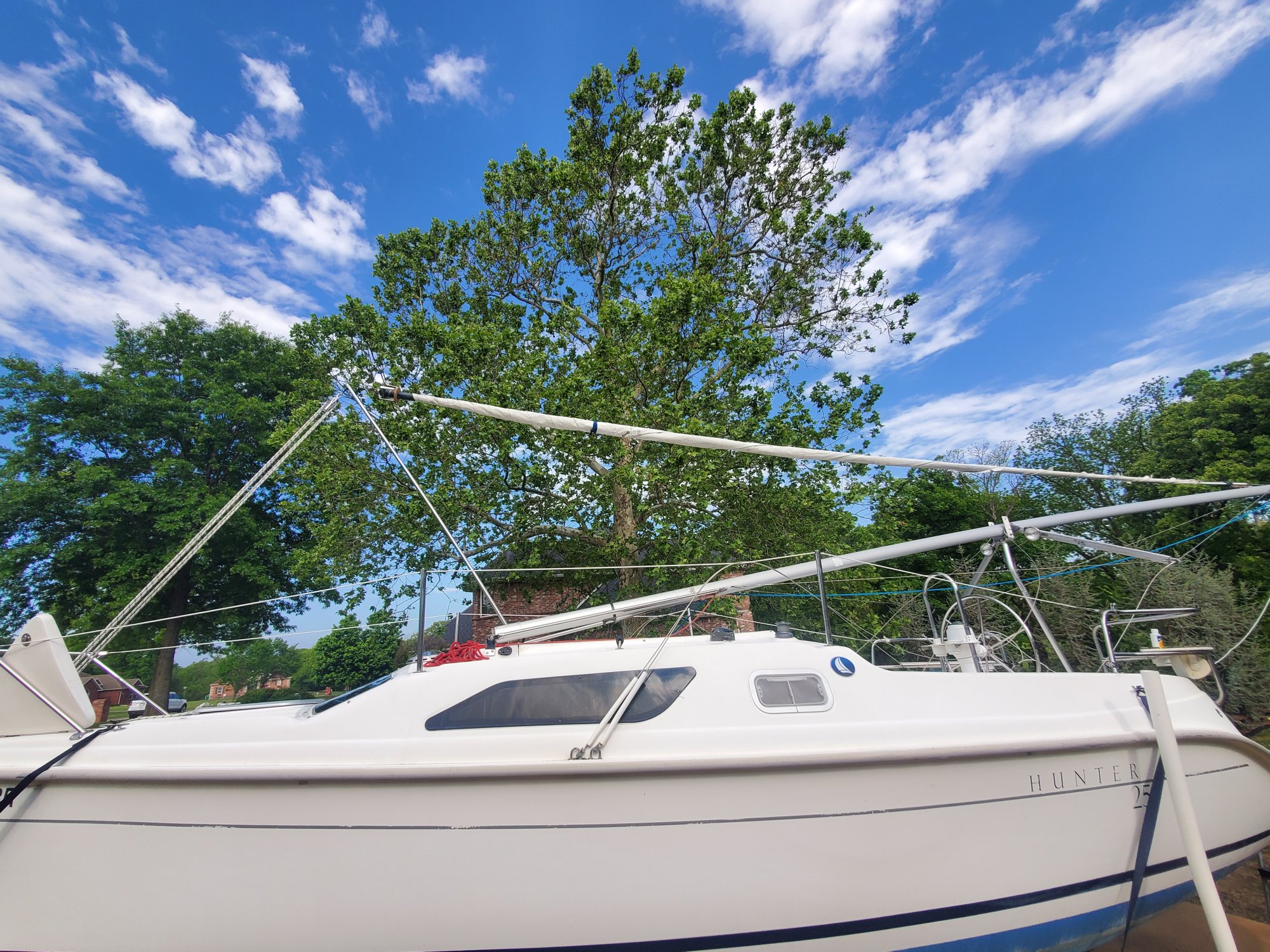

Mast resting in support and gin pole installed. Gin pole looks fine here, but jib hasn't been pulled tight. Once tight the gin pole is forward quite a bit more than I'd like.

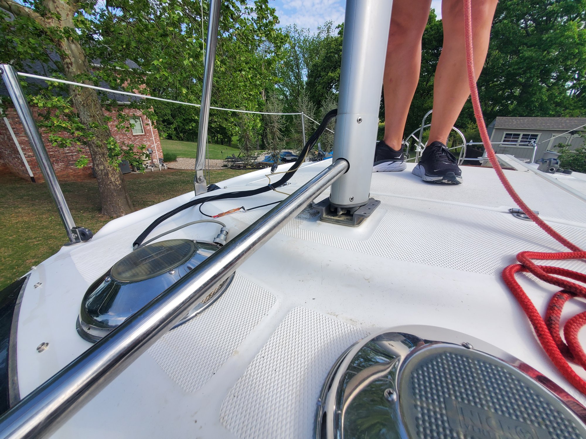

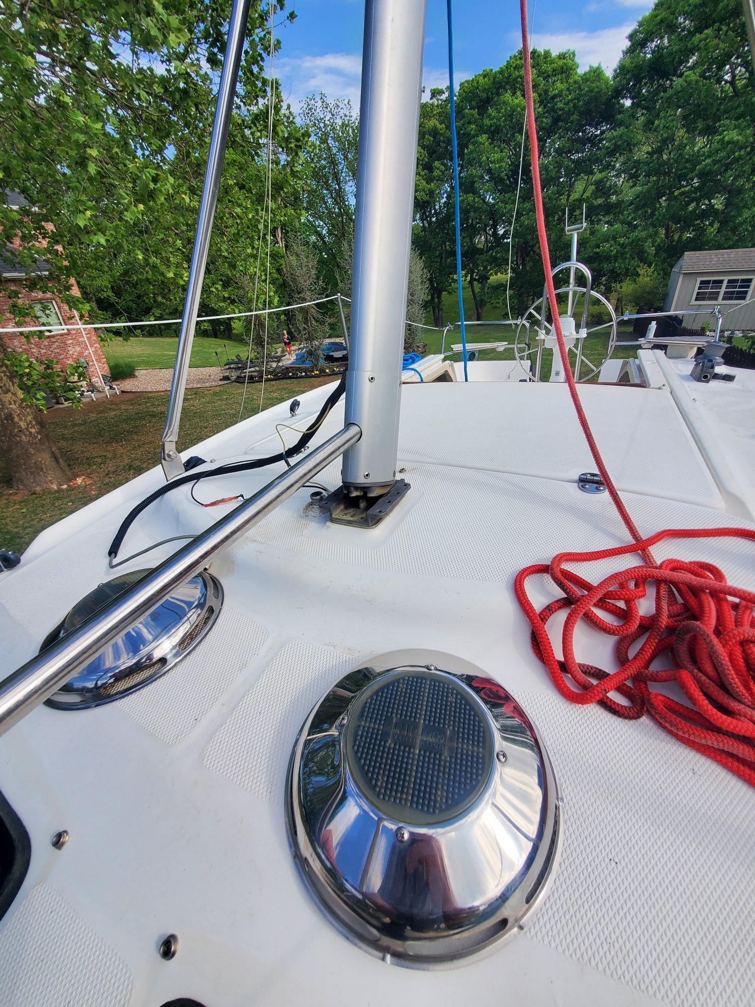

Once I've raised the mast and exhausted the main sheet the mast is still quite a bit short of vertical.
With some assistance we can get the gap to close a bit more, but still short of being able to attach to the stem head fitting.
I do believe that I can use another line to pull the mast forward enough to secure the jib to the stem head fitting, but still wonder if I'm doing something wrong with the system as intended.

Spoke with owner today and went over mast raising in detail. His furler is not a FF 2 CDI but there is a turning block above the forestay and no spinnaker. That solves the issue. I told him to gett another halyard Ten feet longer than the jib halyard to use to raise the mast raising pole. once he gets it , he will advise and will go in depth and report then
Told him to raise the pole upward and get a new longer mainsheet with 10 more feet
@Cap’nhook. Never raise the furler attached to the mast raise pole but leave it on the deck parallel with the pole

We nearly had the system "working" using the furler, but @Crazy Dave Condon quickly noticed that I was putting undue stress on the gin pole and urged me to stop using the furler to raise the mast. As you'll notice in the pictures, the gin pole was not at 90 degrees to the mast and likely near failure.
I'm unable to use the jib halyard because it is used at the top of the furler to hold the top roller bearing assembly up at the top of the forestay. However, I do have an additional block at the top of the mast for a spinnaker halyard so I have another halyard on the way that I can use instead of the jib halyard. That should solve my lifting problem.
The reason the mast wasn't settling fully on the mast step plate - the shackles on my shrouds binding at the chainplate. The issue was sorta hidden by the boots and mostly exaggerated by my inexperience. This was all realized during the last attempt we were performing to get pictures to post. Once we straightened shackles the mast settled nearly all the way down and I believe once I have the proper lifting halyard we will be in business.
