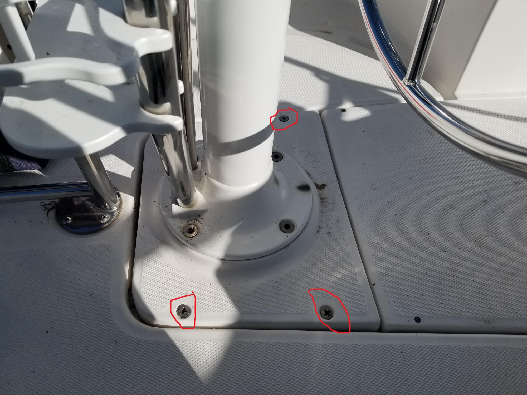

I was checking to see if anyone has had to remove the 4 mounting bolts that hold the helm to the cockpit floor. It has 4 bolts/screws going into the deck and 3 are loose and will not tighten. I have not been able to pull them out and do not know if they are machine screws or self taping screws or if there is a backing plate or nut embedded in the floor of the cockpit. I did not want to damage it more by extracting them so I was looking for someone who has gone through this before. Please see pic attached with screws in question.

Yes, I can but it does not give you any access to the 4 screws.

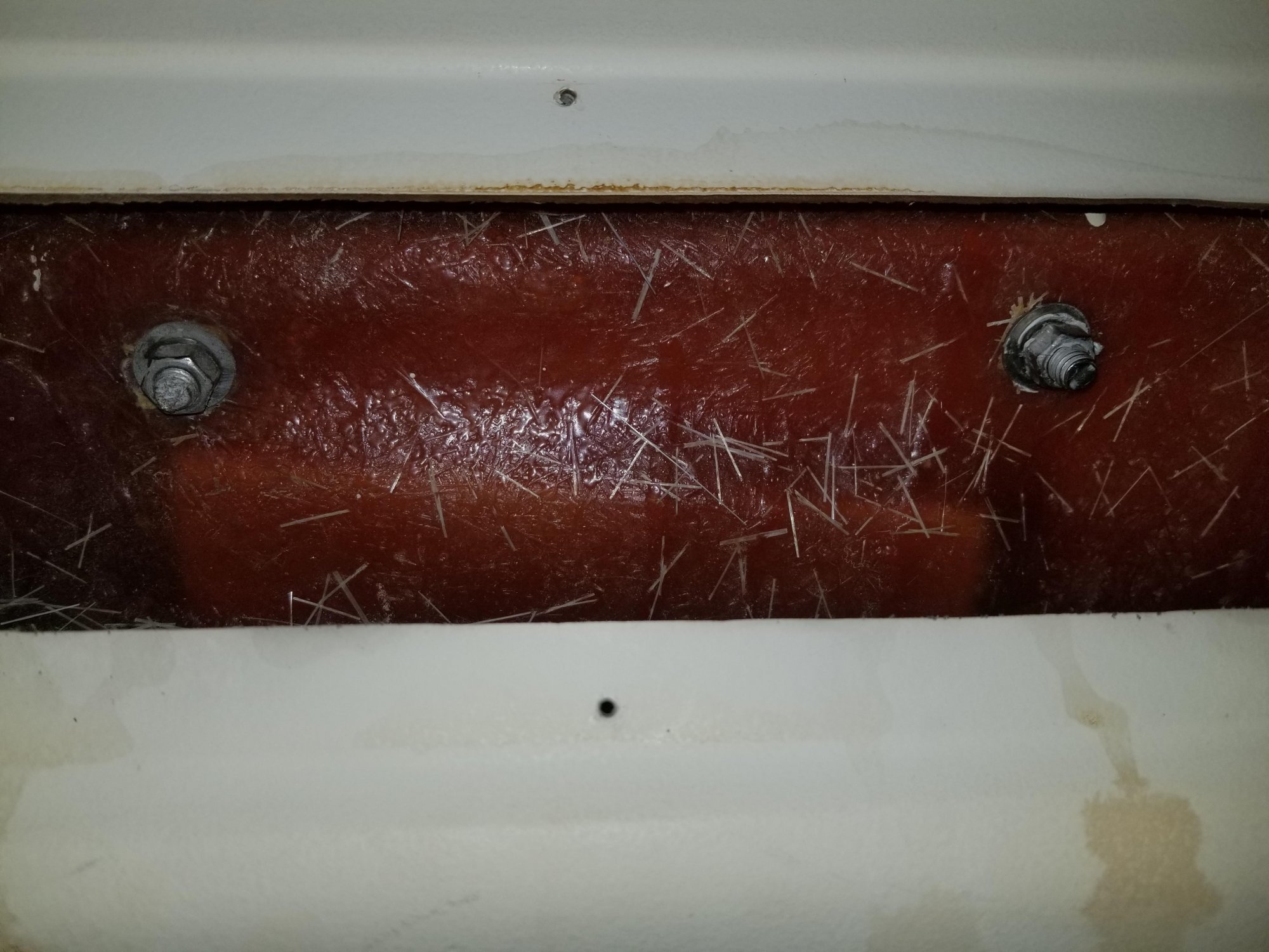

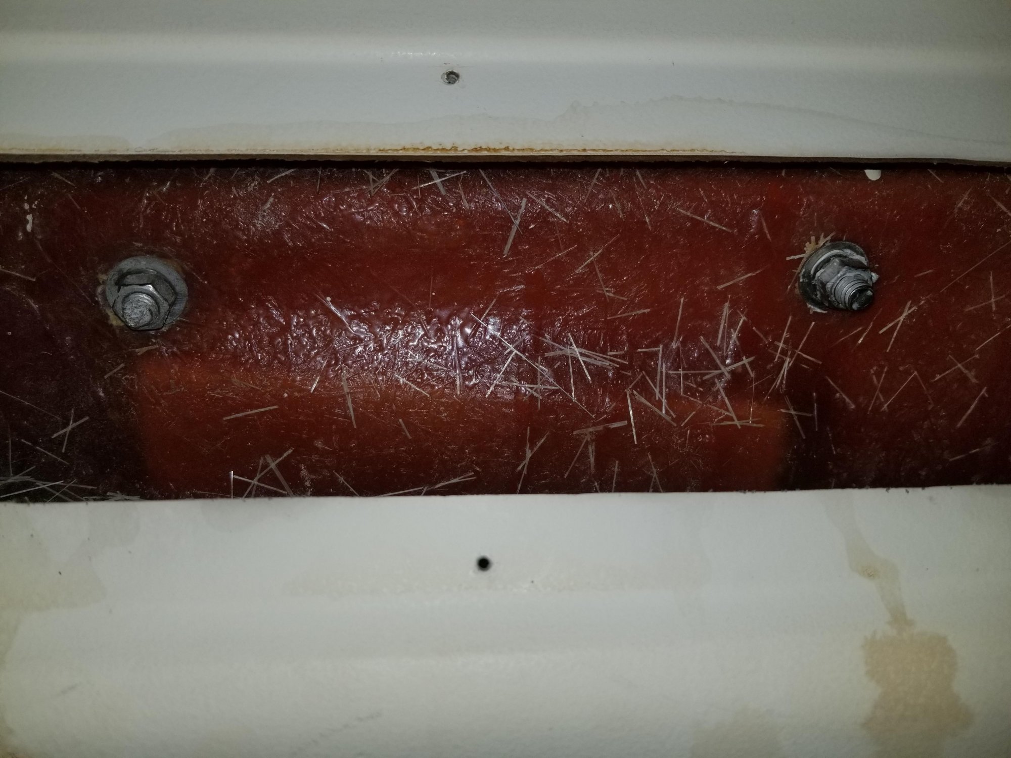

I've had to remove those in the past to run new wires. You can reach them as Ken states from the aft berth inspection covers. There was a lot of 4200 around the bolts and nuts as a water seal. I used butyl tape to reseal everything when completed, still dry.

No, it was easy. The bolts are in the ceiling in the berth under the cockpit. Just take off the two access panels on the port and starboard. Very easy access.
