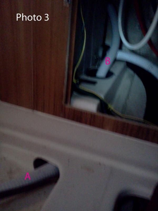

Photo 3 shows the pipe going from the under-berth area to the holding tank compartment i.e. A to B. I was able to get my hand through the front opening in the fiberglass enough to cut a cable tie that was securing it. However the pipe still didn't want to move so I convinced myself there were more holding ties inside the channel, out of reach.

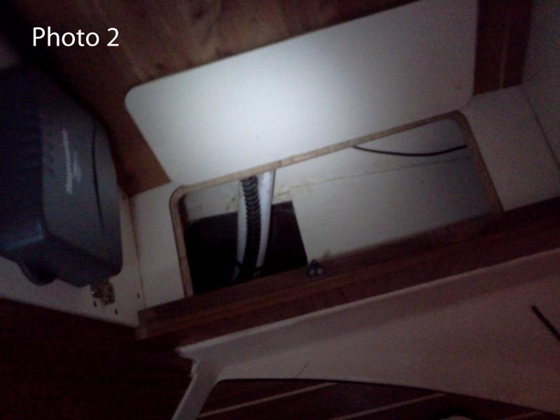

Back to Photo 1, the pipe goes from point F under the stbd. cloths cabinet to the head. Photo 2 shows a down view of the cavity under the forward part of this cabinet. I was able to put my hand in through the "black hole" and find and cut another tie. However the pipe still didn't want to move here either so again I convinced myself there were more holding ties under the cupboard, out of reach.
