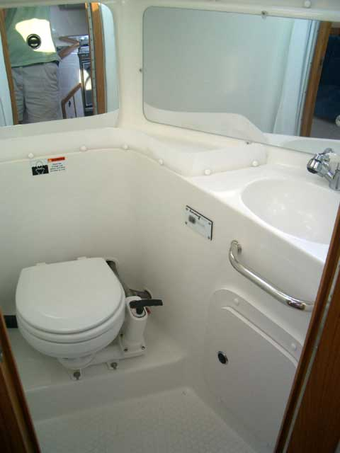

The breaker switch on main panel at nav desk must be on, then waterproof switch on sink is used to drain shower sump as needed. I just pulled this picture up on google , it shows switch and plate on the head sink. They made changes during the production run, I think my shower pump is under the head sink.

maybe I am completely blind. I will check again tomorrow. Again thank you very much for the effort!

it turns out I was completely blind. I guess I assumed it was a nameplate like appears elsewhere on the boat so I ignored it without seeing the rocker switch hidden behind the cloudy plastic. In any case thank you so much for the effort!!!!
