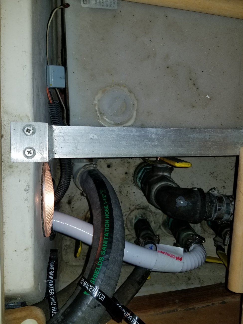

I've flushed the vent line with water and it is not plugged. I'm moored in Boot Key Harbor and the pump out guy says he's getting no suction/vacuum hissing when he puts the pump out hose in the pump out deck plate. He said to check waste hose connections. Connection at deck plate is good but I can't figure out how to get to the fitting on tank under aft bunk. Anyone know?

On my 420 the tank is under the aft bunk, port side, forward, near the through hull fittings. I just changed out my tank sending unit. You can inspect a little through the hole. The vent is on top of the tank.

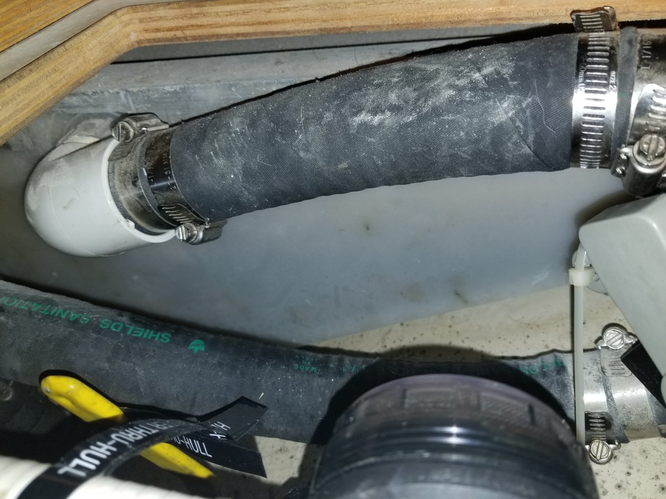

Thank you for the reply! I'm baffled. I can only see the 1.5 inch hose going into the top of the tank from the y valve and the 1.5 inch hose going into the bottom from the macerator. I can not see the vent or 1.5 inch hose to the deck plate - or any way to take apart the bunk covering the tank.

Before I try plunging or snaking, I'd really like to check the fitting where the pump out 1.5 inch hose goes into the tank but see no way to access it. Anyone ever been able to see that on a 420 passage?

Most likely if it's like on my 410 you have to move the mattress and the then unscrew and remove the board above the tank.
