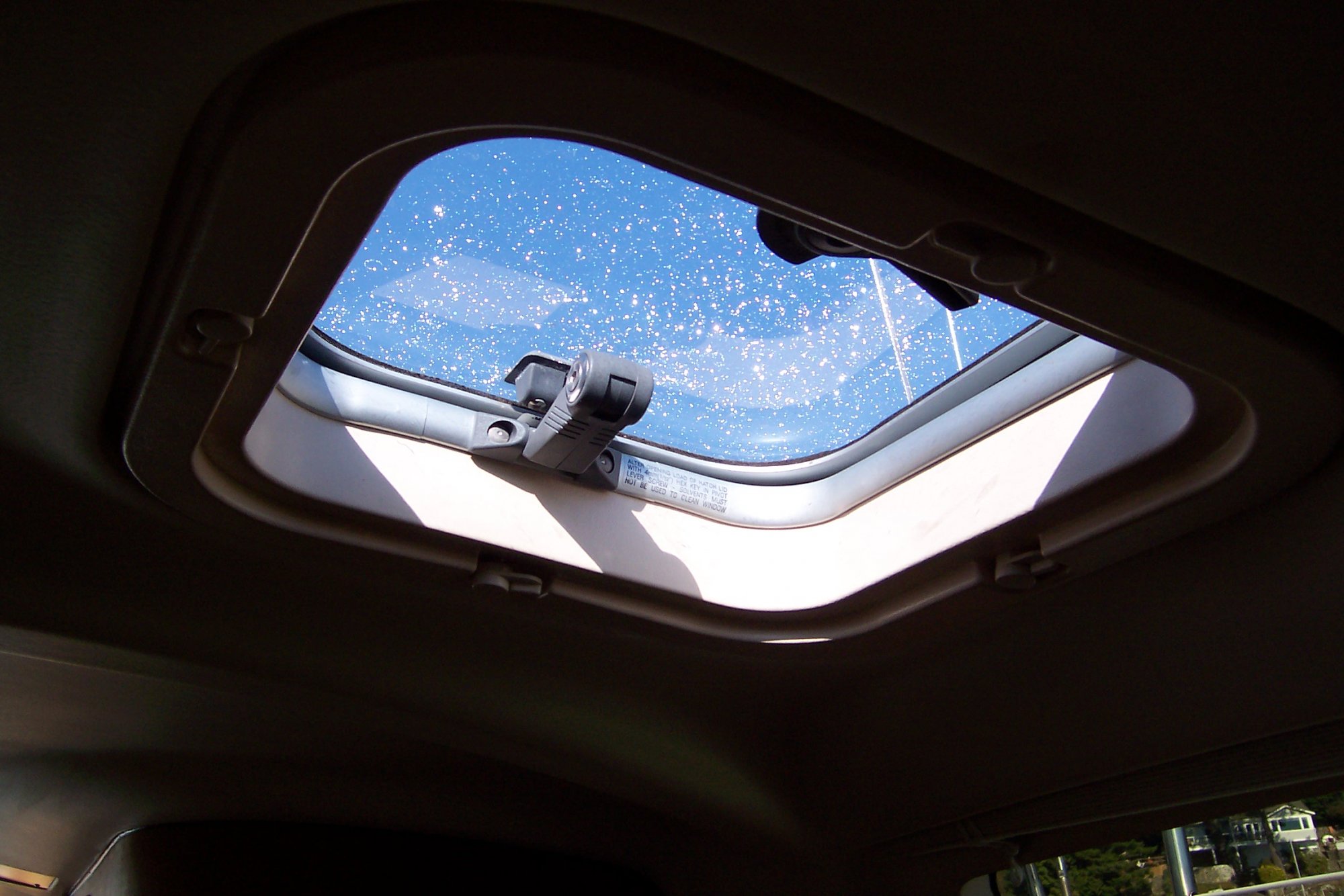

Three years ago, I decided to install my own hatch and port covers in the belief that they would reduce UV radiation and eliminate crazing. The boat is 1999 and I bought it new. I have replaced the three opening hatch lenses and three opening port lenses three years ago as they were getting far more crazed than the non opening ones. Manufacturer's built obsolescence I would suppose. The non opening ones range from lightly crazed to as god as new condition. The covers were an attempt to eliminate further crazing. A few examples :

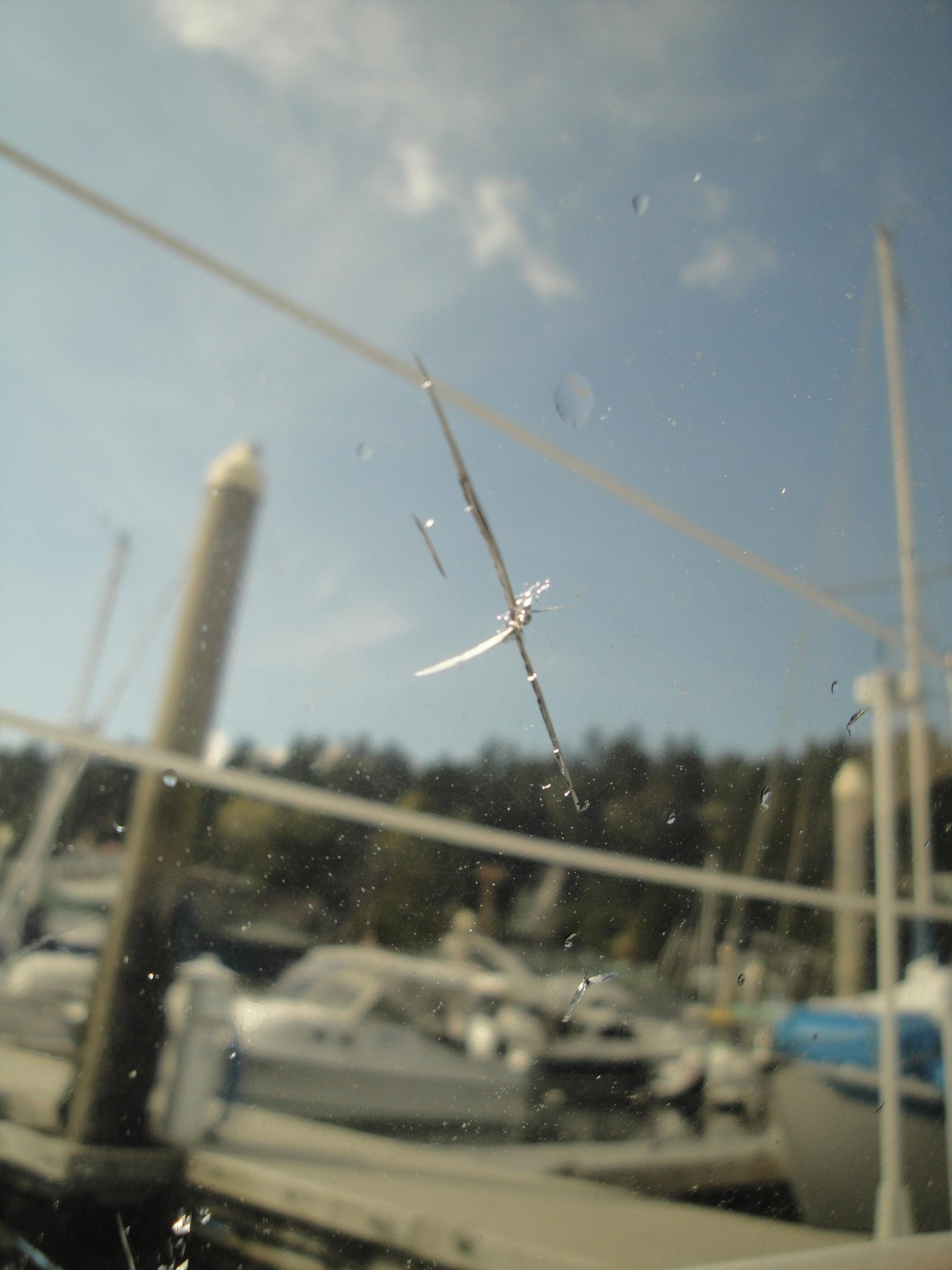

The above is an odd one as the crazing only shows as a few deep cracks. No exterior blemishes thereby eliminating impact at some previous time.

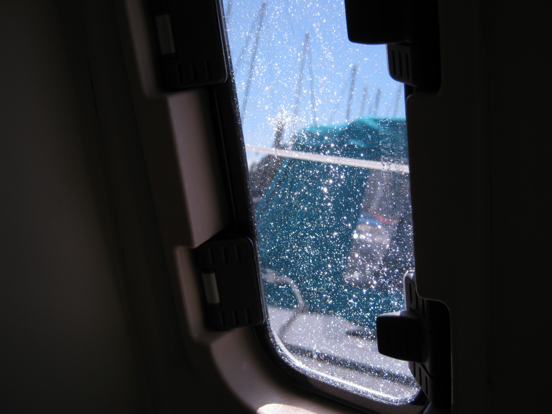

Lewmar opening portlight all asparkle. The other two looked identical in failure. Replacement lenses were about $100.00 ea.
All hatches looked the same (all sparkly) as well. Fortunately, I was able to cut and fit my own replacement acrylic lenses for these hatches for about $20.00 ea.

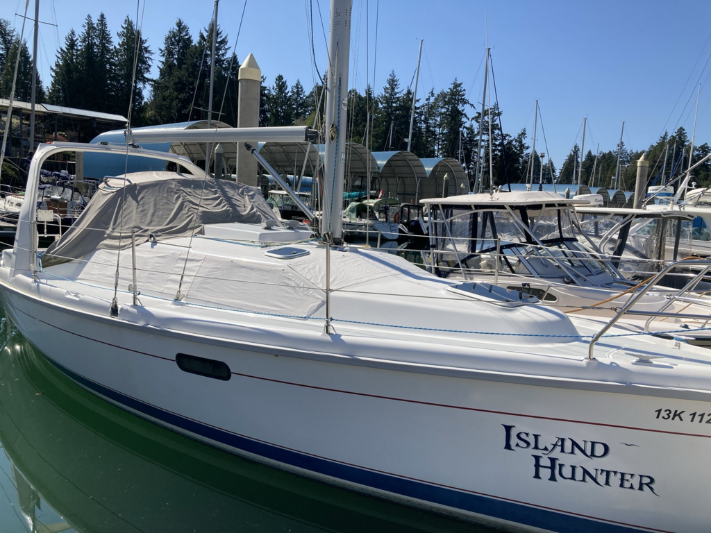

These are my covers made up about 3 years ago :
The hatch covers were installed shortly after this picture was taken.
What are your covers made from and what colour. The above are white Sunbrella. Is your boat a 2003 or older ?
