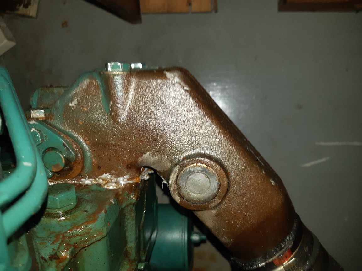

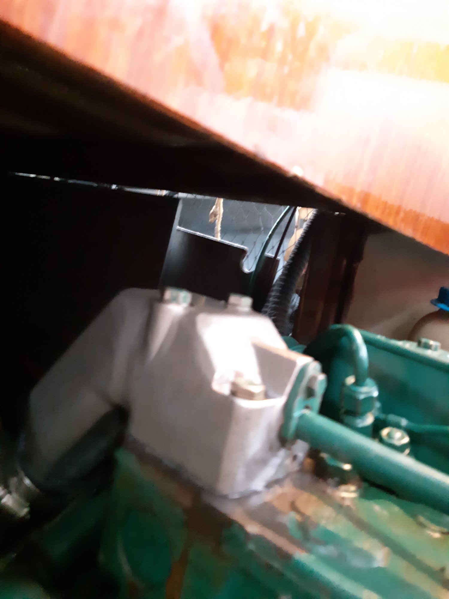

Actually, the later model 2000 series blocks and heads were made with nickel steel, so block corrosion is not such a problem. The exhaust elbow, on the other hand, is cast iron. I've only got about 500 hours on them before they plug up. The cure is simple and less expensive then a replacement volvo part.
The second photo is a one year old replacement made of cast stainless from a PNW company. Less expensive than original, and i expect it to last well beyond 500 hours.
Corrosion ? No, in this case it looks like you are experiencing deposition in your HEX rather than corrosion. Totally unrelated problems. I don't think you have the answer as to why your not getting any cooling water through your HEX. I would suggest you do some serious searching while you still have a working engine.
