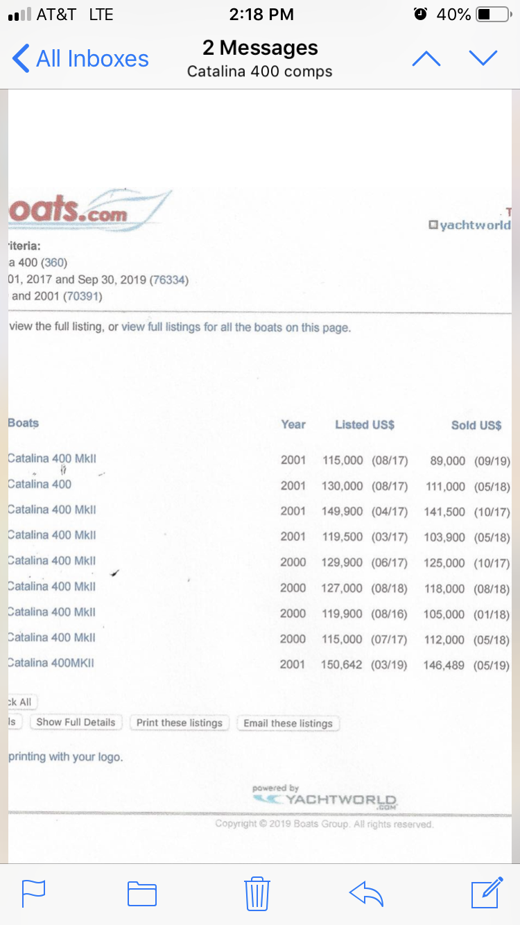

Catalina 400 in that year list for $100-140k. Has your broker given you a recent print out from Soldboats.com? That will show you listing vs sold prices for similar boats. In general it's 10-20% below the asking.

Just went back to the listing. So to go from $130k to $98k you already negotiated pretty well. If you can get insurance and financing than I would probably not try for too much more. But I would only buy this boat knowing that you have some work to do to finish the refit. This would include at least inspecting all of the standing rigging including the chainplates, rebedding all the deck hardware, and all of the stuff you already listed. The insurance company will require everything listed in the survey to be fixed.

There’s no broker. The boat is actually in good shape overall. The chain plates are in good condition. The surveyor is/was on my side and I believe he was being pretty picky. The sail is in serviceable condition. The electronics are brand new bng. The rigging looks good but recommended replacement. The blisters he pointed out don’t seem to be blisters at all to me. I still haven’t got the survey yet. I’m already approved for 100k through Essex. I went through boat us. They I’m sure get a commission. I’m a full time captain, I’m a diy and I’ll use some pros here and there when needed. I’m used to working on boats in pretty much every aspect. Kinda already what I do for a living. I love the layout minus two heads. I’d rather it only have one. The forward has an electrasan that’s not working or I couldn’t figure it out but that will take another grand off the already 98k agreement prior to survey. 600 was the cost of the haulout. 940 for the survey. The bng is oversized. It has the new radar bng. It’s hooked up. The owner bought all this stuff brand new recently and moved before he finished installing. So not obsolete. It’s all brand new. 12 inch screen and two more mfd. check out that arch too. I think I’m going to offer 92k and no more. I think that will cover the haulout. Nothing else financially is needed after that until the next haulout before I head to the South Pacific. That’s still probly five years away. Once my survey guy emails me the survey, I’ll post some pics. The 2000 / 2002 issue may or may not drop the asking price above the six grand I stated above.
