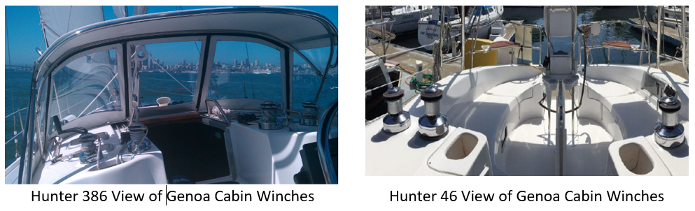

I would think it is possible to install genoa winches on the coamings. A new Lewmar size 30 self tailing chrome winch (specs did not say if it is one or two speed) can be purchased from this site for $913 or a Lewmar ocean series 48 chrome self tailing winch size 48 costs ~$1800 from Defender. Of course you need to install a block on a stanchion to re-route the jib sheet to the cockpit, a jam cleat and possibly longer sheet. We like the cabin located genoa winches on our Hunter 386 and now 46 as it avoids sheets in the cockpit and you have a built-in sheet pocket there to stow your sheets. It makes genoa winch operation easy and comfortable.

I can single handle both sailboats with or without an autopilot. One major advantage of genoa winches on the cabin is you can social distance when sailing with others and will be doing this for some time to come, whereas you cannot social distance if the winches are on the coamings. The cabin mounted genoa winches was a great innovation. I assume the 356 sheet pockets are right behind the winches as shown on the 386. Very convenient!! You can easily re-route the main sheet to the helm with a jam cleat on the arch if you want ....but that is the subject of another thread.
