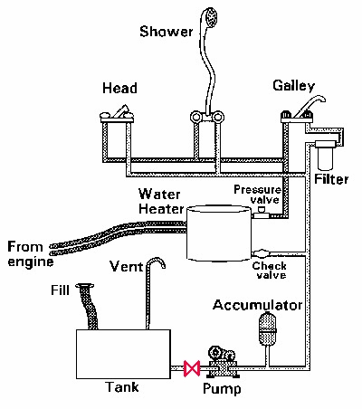

I'm putting my money on @Terry Cox with the leaking pump check valve .................. unless you have a pressurized fitting pi$$ing all over the floor.
You can test for a leaking pump check valve if you have an isolation valve before the pump as shown:
with credit given to @Tally Ho's fine drawing.
Once the pump is up to pressure and shuts off, close the inlet valve (shown in red). The pressure is now contained within the system and the pump should not come on again. If it does, Mr. Cox has just cost me a bucket full of money. Run the test for a little longer than the cycle you've been seeing, to prove the point.
The test requires that you stay by the pump so that if it does come on again under test, you can quickly either :
a) quickly shut down the pump or
b) quickly open the inlet valve.
Running the pump with the inlet valve closed for an extended period of time is not recommended.
