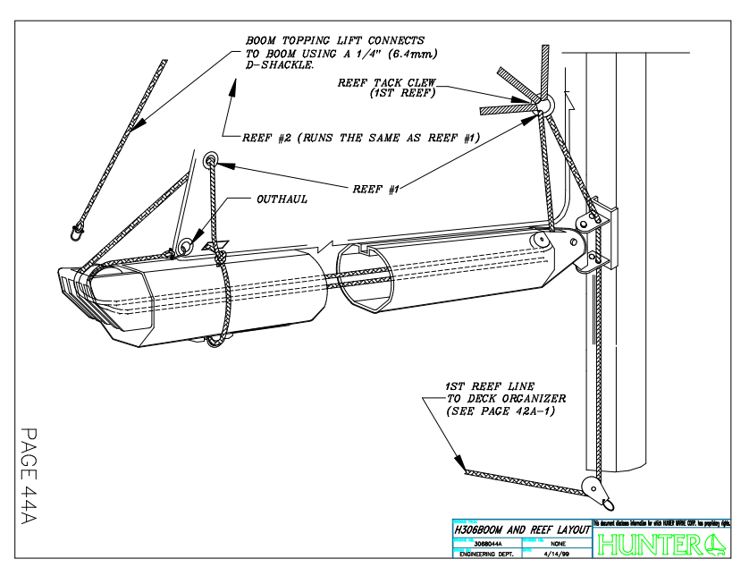

I just purchased my first sailboat, a Hunter 290, and while rigging it to take it out for the first time I noticed the outhaul seems to be setup in an odd way. The line for the outhaul comes out the aft end of the boom. It seems to work but doesn't seem logical especially once the bimini is up.

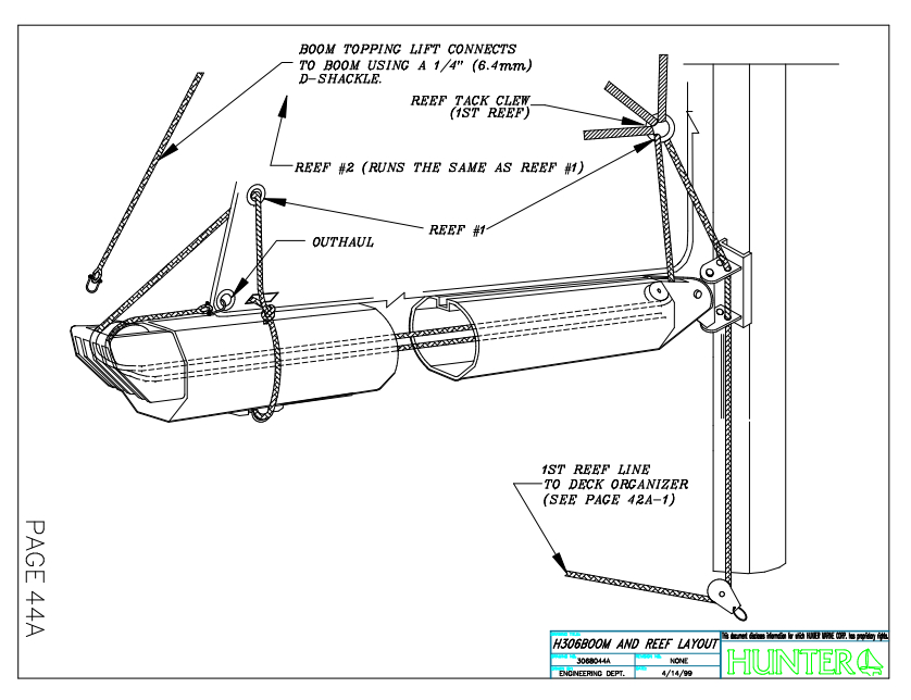

Can anyone show me a picture, drawing or manual that shows how it should be rigged? There is a cable and blocks in the boom and it would seem the line should run out the front of the boom for easier access.

Thanks Panera. I have the owners manual and looked through it. It shows a basic breakdown of rigging the boom but just that the line goes to toward the mast. Not how its supposed to be routed.

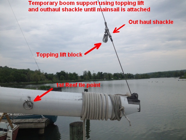

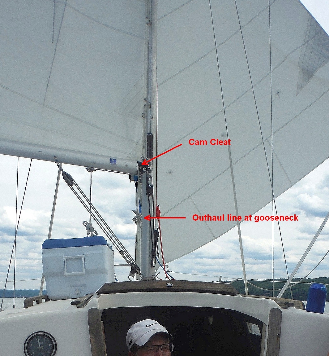

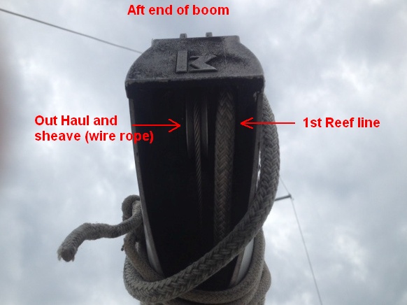

Hi Matt, Welcome to the forum. My boom is an older Kenyon and I'm not sure if any of these images will help you, but just maybe they will. The out haul exiting from the aft end of the boom has a shackle which attaches to the clew of the mainsail. The wire rope travels inside the boom to an internal set of blocks which I believe offers a 2:1 purchase on the out haul line (rope) which exits at the goose-neck and cinches up to a cam cleat on the boom, near the mast.
Let us know how things turn out.
