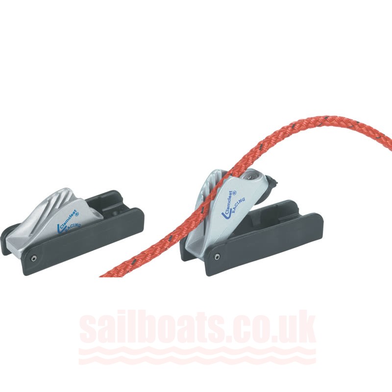

On my 260 I used a downhaul of low stretch line on the rudder secured to a cleat that would release at a preset force. Much easier than trying to replace than a shear pin in shallow water !
