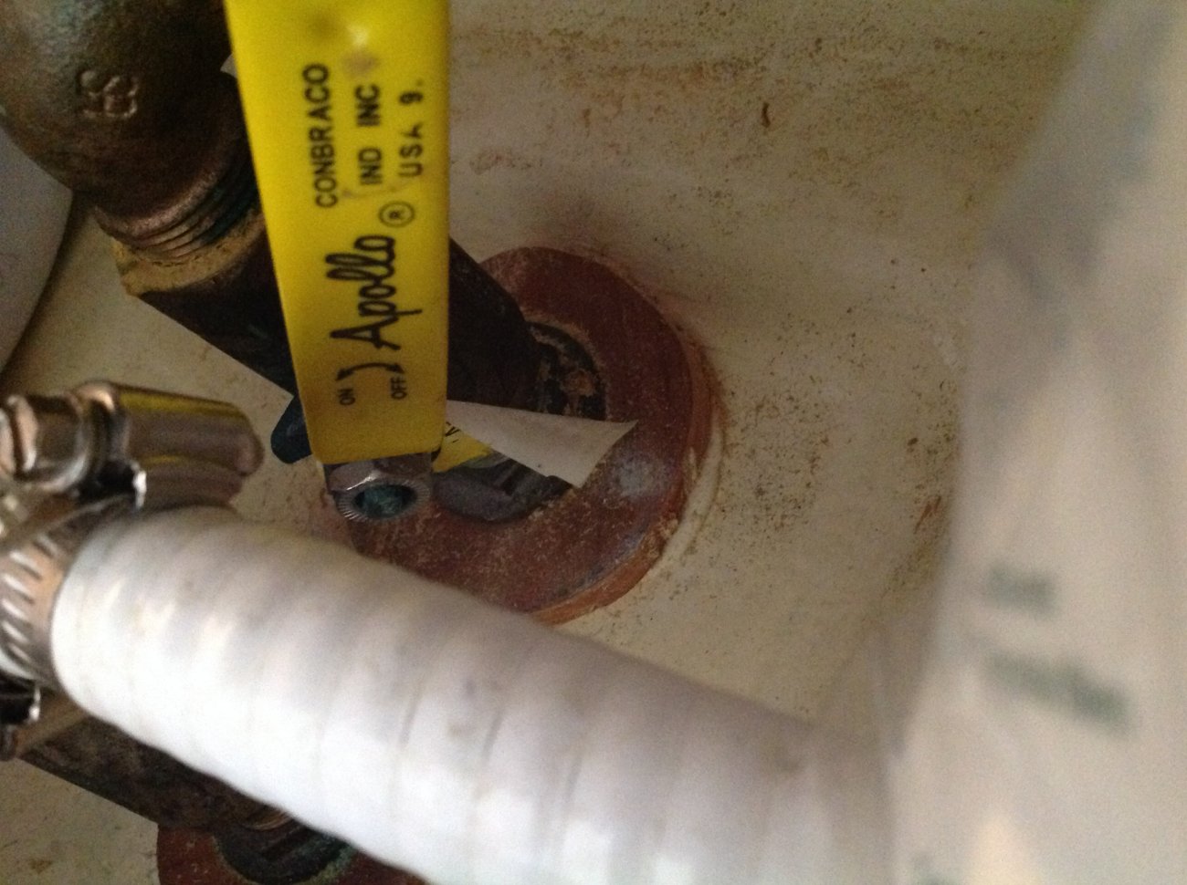

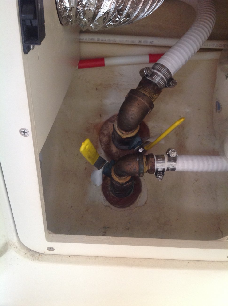

The seacock in the Head from the sink revisited......
Now that my boat is out of the water, I took on the issue this morning. It was all but impossible to move the handle a 1/4 of an inch in any direction.
So I thought I would try heat. I used a heat gun on the body and just where the the handle meets the body of the seacock. Within about 3 minutes of on and off heat the seacock was hot but not to hot to touch and hold and the handle started to move.
Another minute on the low setting and the handle was free. I was able to flip it open and closed with one finger. Looking outside at the thru hull opening I can see a small trickle of thin white grease about an inch long. I used a long thin bristled brush and could go completely up into the seacock, but nothing further is coming out.
I sprayed it with a light oil for now to keep it lubricated and will check it later this week to see if it is still free.
My guess is, I used to much grease and it hardened up inside.
I'll replace the line from the sink to the seacock later, after it makes it through the winter without ceasing up on me again.
As it stands right now, it's the most free seacock on the boat. I'm thinking I'll use heat on the others to clean them out also and regrease them. If this proves to be the remedy.
