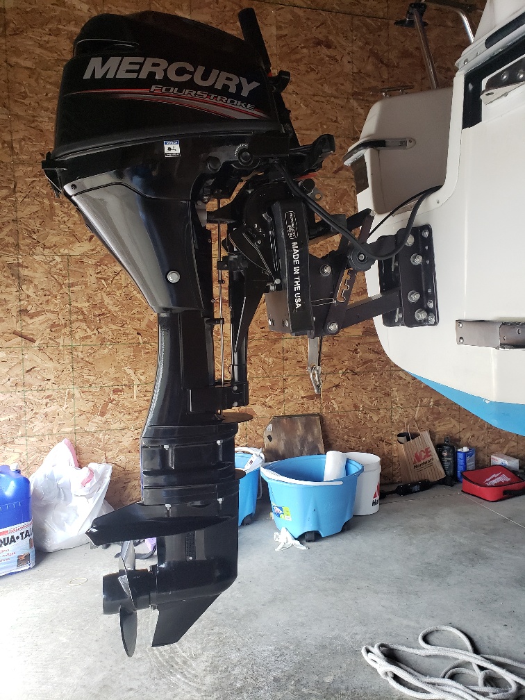

I have a 9.9hp Merc with command thrust on my 26s and it will push the boat to hull speed at 3/4 throttle. More HP is just extra weight and pressure on the transom. I have the 25" shaft and the motor is on an adjustable motor mount. In my opinion the 25" is more important than whether you get an 8 or 9.9 hp. When the swells get bigger, I need every bit of the length and drop the mount all the way down to keep the prop and water intake in the water. Run the motor dry too much and the impeller will shred.

AndyVS's photo and commentary make an interesting and valid point - how much of the motor shaft is actually in the water based on how it is mounted to your boat? For my Catalina 27 it was mounted directly on a stern cutout, the bottom of which was several inches lower than AndyVS's pictured mount. That may explain why a 20" shaft was fine for my particular configuration, and why a 25" shaft might be more appropriate in his. Its not clear from his photo, but perhaps his mount allows him to adjust it even lower, but as pictured its about the level below the stern of the boat of the 20" Yamaha long shaft we used.
An adjustable mount is much better than my non-adjustable in the stern cutout, IMHO. It may put the weight out a little further from the stern, and possibly contribute more to "squatting", but my guess is he doesn't have a cutout that allowed water to enter that area of the stern, which always concerned me on my boat.
