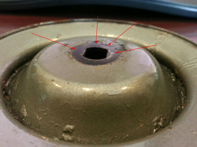

PGIJon
Mar 3, 2012
856
Hunter 34 Punta Gorda
Pulley Straightened
The arrows in the picture shows where the pulley was actually dis-formed.
I was actually able to straighten out the pulley by using a hammer and a flat surface.
-Jon
10,048
Perfect, Jon ! Note: not to side load the pulley when tightening the belt.. Little bugger can be easily deformed.
