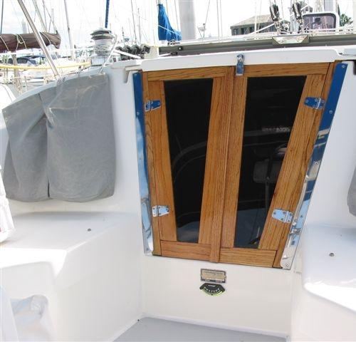

I made my own
I made my own companion way doors to replace the hatch boards. They are made of oak frames stained to match the teak on the rest of the boat and have lexan inserts to let in light. We love them and can't imagine going back to hatch boards. I made a template from the hatch boards and made the doors from that. It took sevral trips back and forth to the boat to get the fit correct but it was wortht the effort.

Nice work Reid.
Sharp looking boat. What are the things that look like snaps on the cockpit seats - something to hold the doors open? John

Thanks,
Thanks we love the doors and wouldn't have a boat without them now. The snaps you see in the photo are for the cockpit cushions - keeps them from sliding around while underway.
