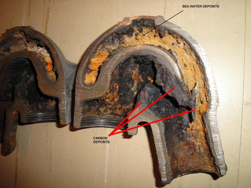

I always look back at the photo Ralph Johnstone has published of the cut away mixing elbow. That internal passage, even when clean and including the humpty hump path sure looks like a lot more resistance in flow than the differences in downstream exhaust pipe sizes discussed above. I remember with car engines a certain amount of back pressure was good to assist in exhaust scavenging. Running straight exhaust would burn the exhaust valves. So, it looks like most of the required back pressure is already designed into the mixing elbow.

I am never am surprised when someone ask a question and and the tangent changes. to heeling 25 deg and motoring wow dah-mazing, Allen 12210 I really like the photo of that elbow cutaway that is an eye opener for me. I have I heve never even bothered looking to see if it was clogged. maybe I will get another 100 rpms, thanks for that post. oh as for what exhaust smell small openings on small eng, yea we have a had that
