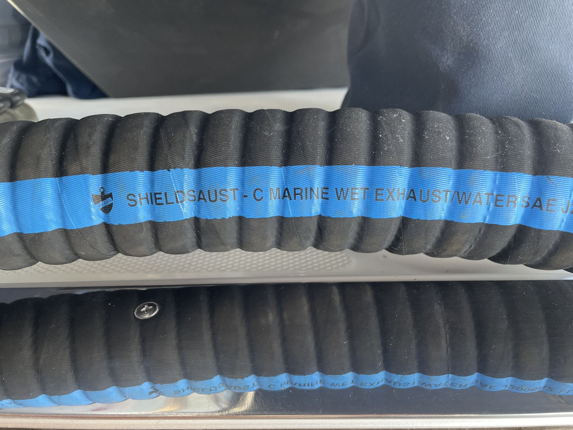

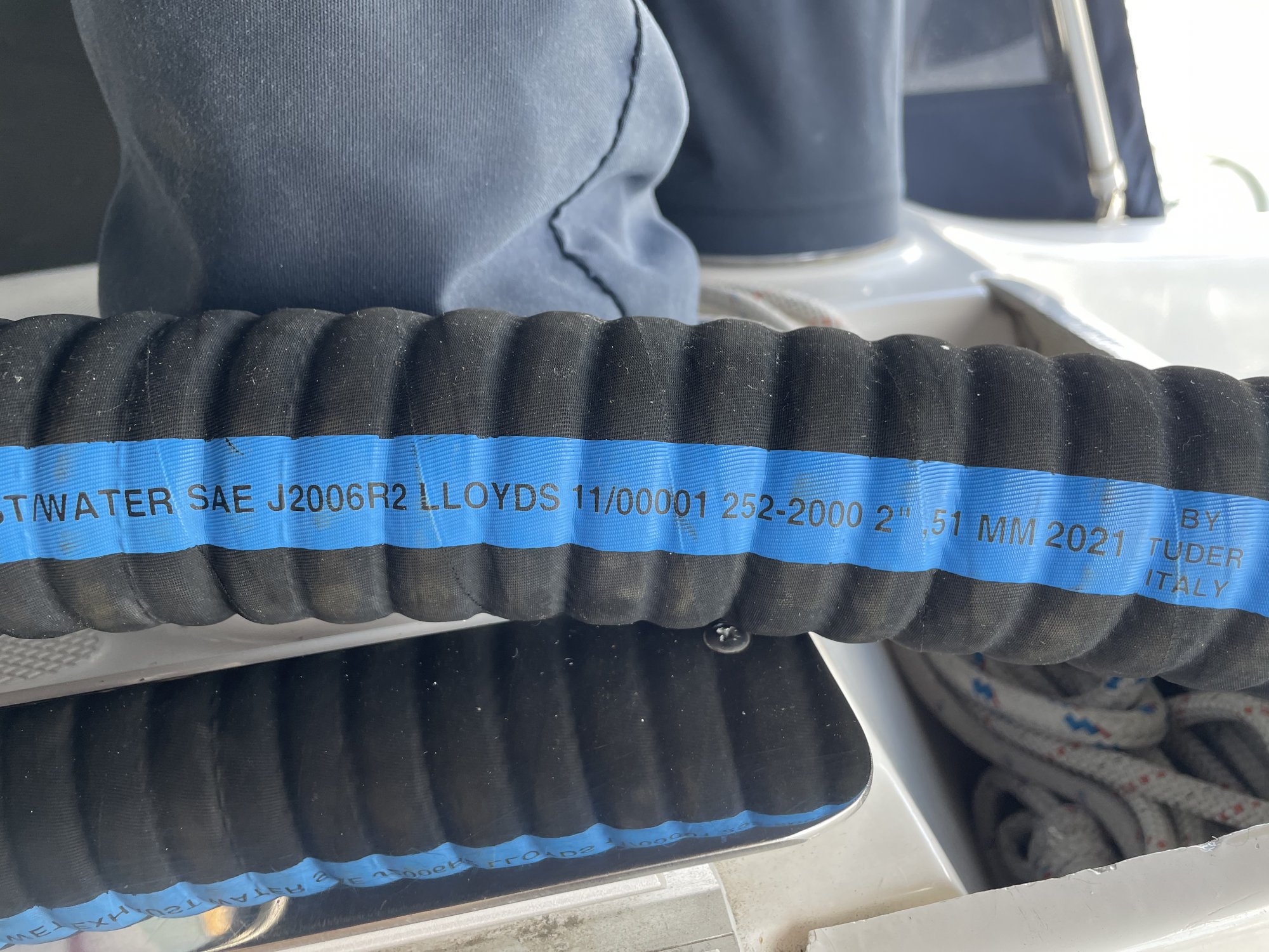

The best prices that I've found for the MPI brand of 252 series wet exhaust hose are on eBay. I need 4" I.D. and it is just under $2 per inch. There is a listing for Shields 252-2000 (2" I.D.) for $16.95/foot with free shipping in the U.S.
Likes: bcrossb
Dec 27, 2021
6
hunter 356 San Diego
Thank you for the info
