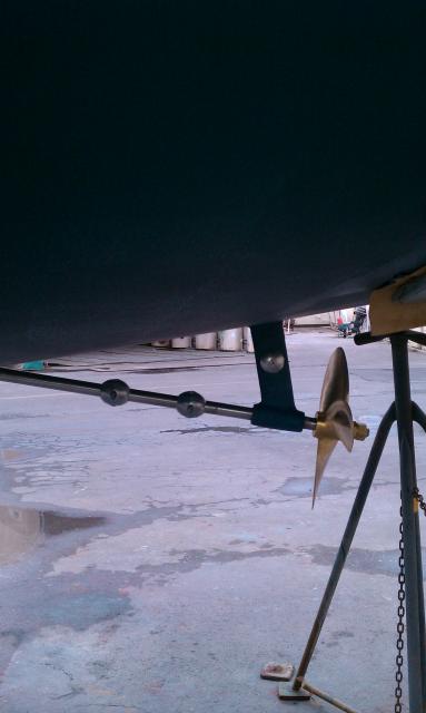

I purchased the recommended Campbell 3 blade and installed it on my 1990 H30 (Yanmar G20) when I bought the boat 2 years ago. On the acceptance sea trial the engine smoked and overheated. After several discussions with Norm at West By North I returned the prop and went back to the 2 blade. The engine and transmission were checked for proper ratios, engine power etc. The engine has run fine since then.
I never have found an answer as to why it didn't work on my boat. I have heard most sailors who have switched to that 3 blade prop have been very satisfied.

Steve, My marina put the prop on and then told me it doesn't fit properly. The last inch or so of the hub is the only contact that is made with the shaft. A local prop shop tells me it fits their 2 shafts fine. If the forward part of the hub is off by 1/12000 of an inch, is that going to be a problem?

I just replace the original 15X12 2 blade with a new shaft and a 14X9 CS. I am still fighting a vibration but I need to re-check the alignment now that the boat is in the water. I dio find that the boat handles way better- backs straighter, accelerates much quicker, and stops much better without that sidwards kick to the left (when I didnt want it!). I am finding that I am over pitched tho- WOT is 2500rpm and speed is 6.7 (gps) or so. I have to do some accurate numbers on calm water before I call Norm, but 2500 with the throttle against the stop and too much smoke is not good. I was able to do just over 6 knots with the rpm at 2700 on the tach with the old 2 blade and WOT was 3400.
