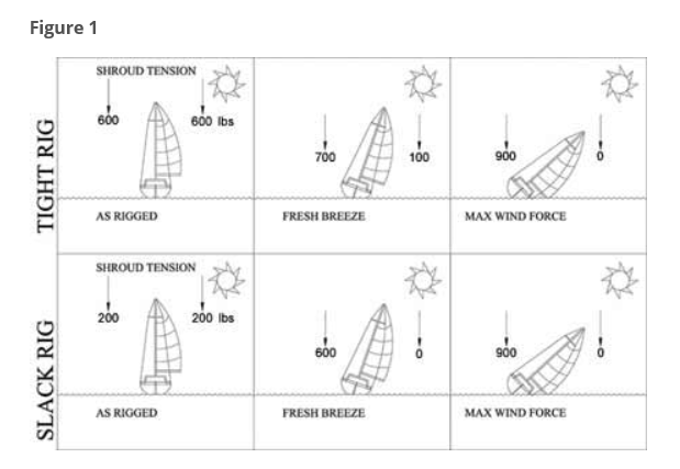

Your shrouds will be a bit looser in very cold weather than they are in warm weather because the coefficient of thermal expansion is about 30% - 40% greater for aluminum than it is for stainless steel. That said the change is not very significant and will only result in reducing the preload on the static rig. The final ultimate tension on the rig is only dependent on the properties of the rig/boat. Ideally you want your stays to be tensioned so that the leeward stays just start to come slack (start to dance) when at your normal max angle when fully powered up. On my boat that is at 22º. The rig tension or lack there of will NOT CHANGE THE MAX TENSION IN THE RIG. The rig tension will be greatest in the longest cables and decrease as they get shorter. You should do final adjustment under sail fully powered up and adjust as needed to keep the mast in-column, ie not bending to either side. And FWIW, yes I am a licensed Structural Engineer.
graphic reposted from https://loosnaples.com/how-tos/tension-gauges

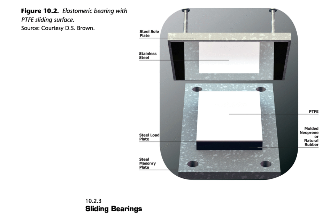

As a structural engineer I can tell you that the expansion joints in bridges is not a "'sort-of' slip" joint. The bearings are Teflon on mirror polished stainless steel to provide the minimum bearing frictions possible.
Expansion joints can be designed with up to 48" of movement. The actual expansion setting of one of the most critical aspects of most bridge projects and are completely weather dependent. The temperature much say within a specified narrow range of change typically not more than 10º in 12 hours. The joint then needs to be set to a specified width based on the casting temperature. On one bridge that provided expansion joint inspection, the contractor waited for 1½ months for the conditions to be met.
