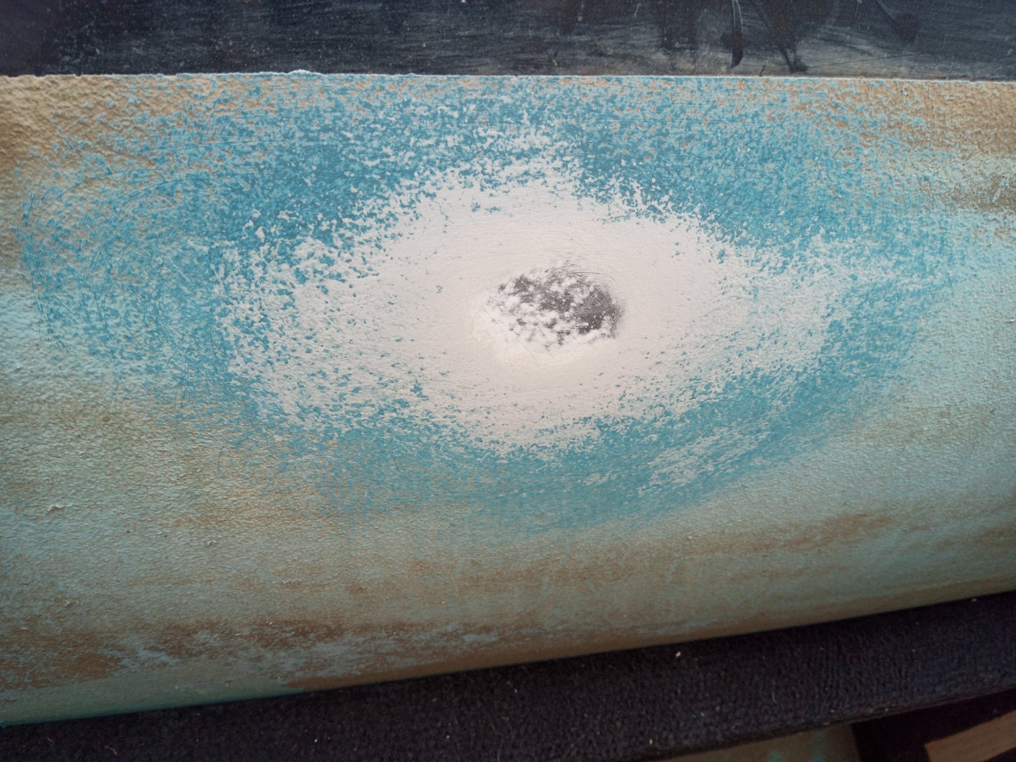

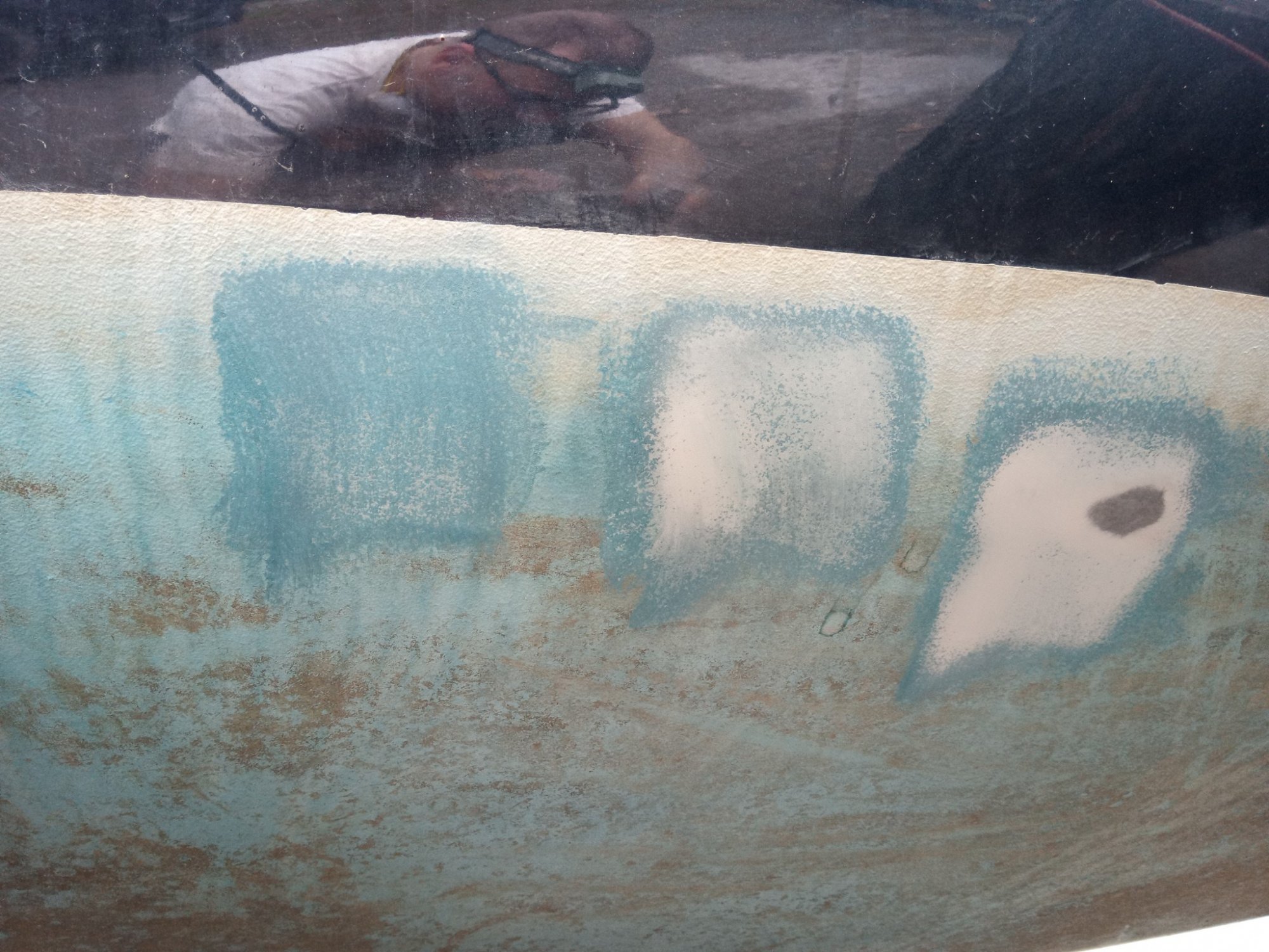

So apparently the previous owner used Pettit Vivid. I have 1 gallon of Pettit Hydrocoat.
Should I just sand the hull down to the bright blue...Or the white? Pretty sure the dark is bare fiberglass?
Ive attached pics of the sanding in step so I could see each layer but not really sure what I'm looking at or how to proceed.
Please include step by step if you can... because I'm new to this and a classic overthinker,lol.
Thanks!!!!

My guess is the white is barrier coat. Definitely no reason to go through that. If the bright blue layer is well adhered - no flaking or chipping - I’d probably just rough it up, get the debris off and to fresh blue. The hydrocoat should be compatible enough with that.

This is good advice. Hydrocoat is compatible with the Pettit Vivid. Just a scuff sanding with 80 or 100 grit then paint.
Tip - Hydrocoat (and most other bottom paint) will adhere better if you use thin coats. Thick coats are more likely to flake or chip. Avoid the temptation to slop it on thick with the hopes of it wearing longer. The opposite is true. Use a short nap roller (1/4”).

I'm no expert, but the white coating doesn't look like gelcoat...unless it is a very rough layer done after the hull left the mold (in cases where later repaired), so it looks like some kind of non-slip coating like Awlgrip. There appears to be a tape line adjacent to the black area...
The dark patch looks a bit like the resin layer beneath the gelcoat...but it is hard to tell from the photo viewed on my phone. Perhaps the swirl patterns is from sanding or glass mat in the first layup layer? If so, and yu are through the barrier coat, shouldn't that be touched up with barrier coat before any top/antifouling coats?

Concur, I only see fiberglass/resin, then gelcoat, then various paints.
As for how to paint, just follow the paint manufacturer's recommendations. They have instructions on what can go over what and what prep is required (wash, light sand, heavy sand, complete removal).....
If you don't have blisters, carry on. If there are a few small ones here and there, it would likely be worth it to sand down all the bottom paint, apply barrier coat, then new antifouling. it's much easier/cheaper to fix it when it's a small problem than once you get hundreds of blisters to repair.
