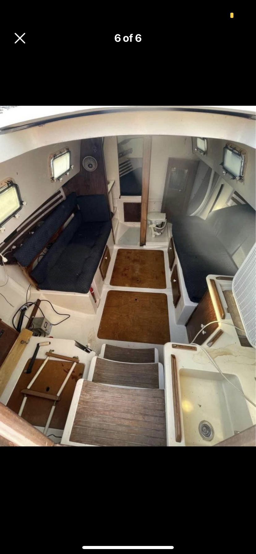

Just purchased this boat for cheap because the owner is moving out of state. It looks decent for what I paid but it’s definitely a project. The “bulkhead” or as I would call it the wooden wall that cover the toilet area has been removed and that does worry me. It doesn’t look like it could have had much to do with the integrity of the hull to me personally but I know nothing about the subject. I’m curious what you guys think on that. The guy says the 8hp Renault runs fine, he has an impeller for it that he never got around to putting in. Im wanting to do whatever tune up/maintenance on the motor I can to help ensure it’s in good shape for this summer. Im open to all suggestions there. And I have winter weather coming in quick and I’m not sure of what I should do winterizing wise. Really any advice about this boat is welcome. I have zero sailing experience, but a strong desire to learn.

Congrats on the new boat, sailing is a lifestyle. Pictures of the missing bulkhead would help people determine if it's structural or not. As far as winterizing, you definitely should get on that - the pressurized water system, the head and the engine's raw water cooling need to be completely drained (everything) or you need to add "potable" antif-freeze to them. There should be plenty of info on this site about that but ask any questions you have. I'm sure you realize what damage freezing water can do to your boat.

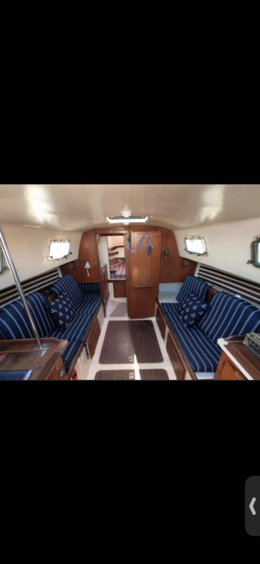

This I believe is what it looked like originally.

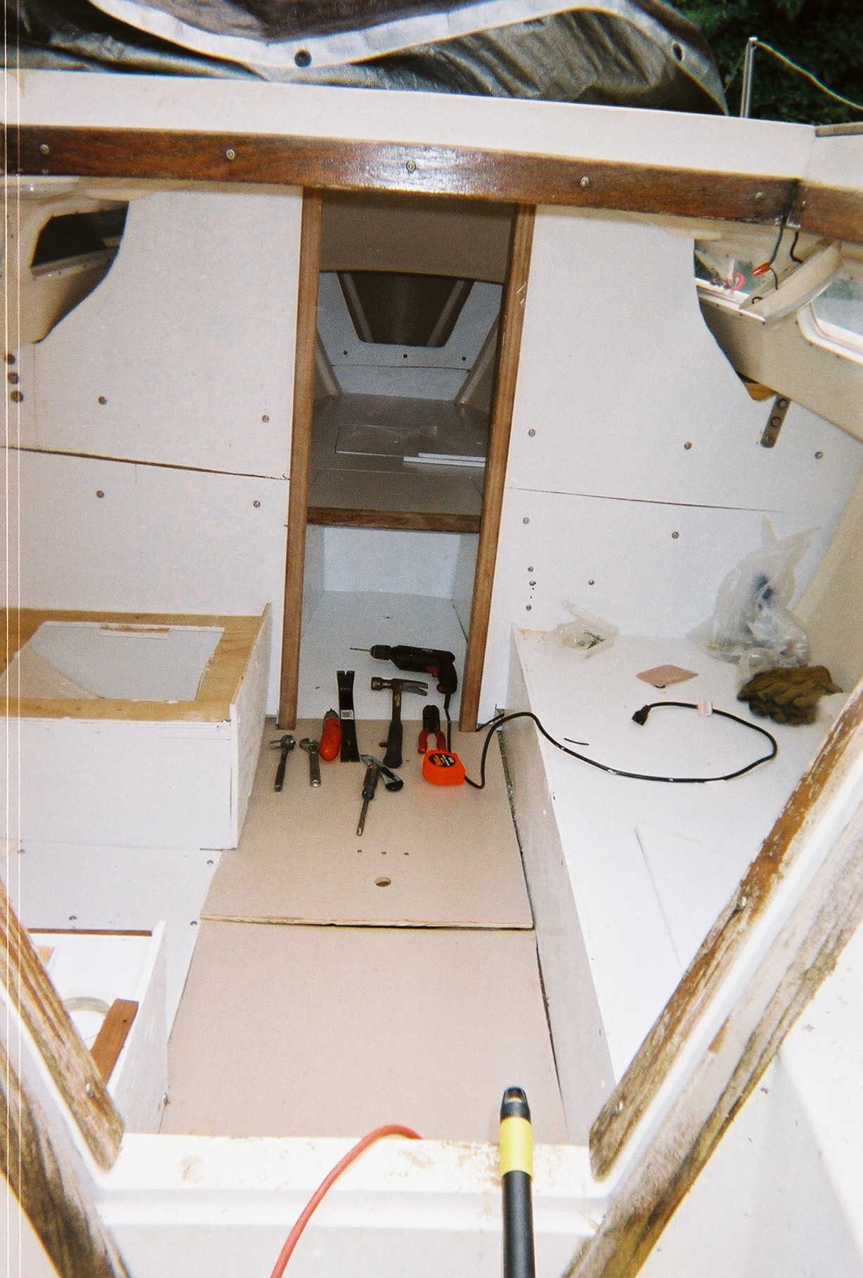

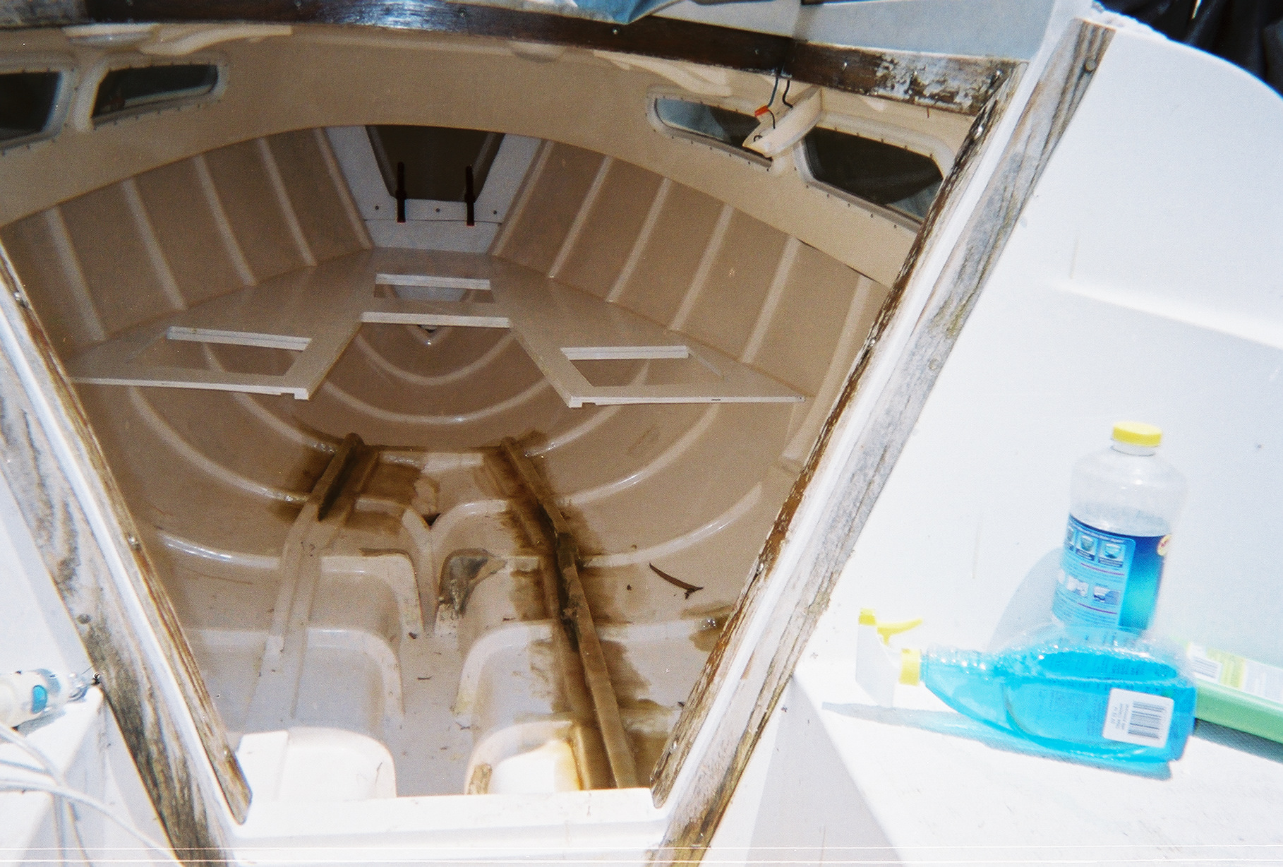

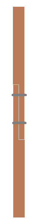

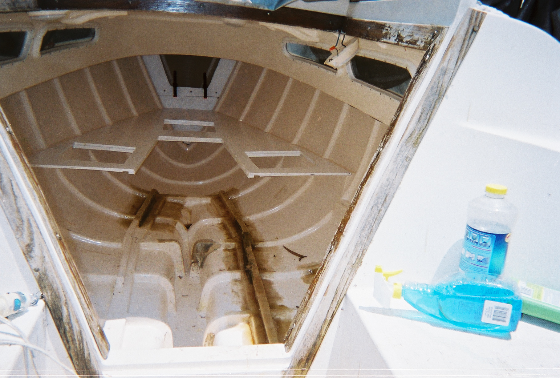

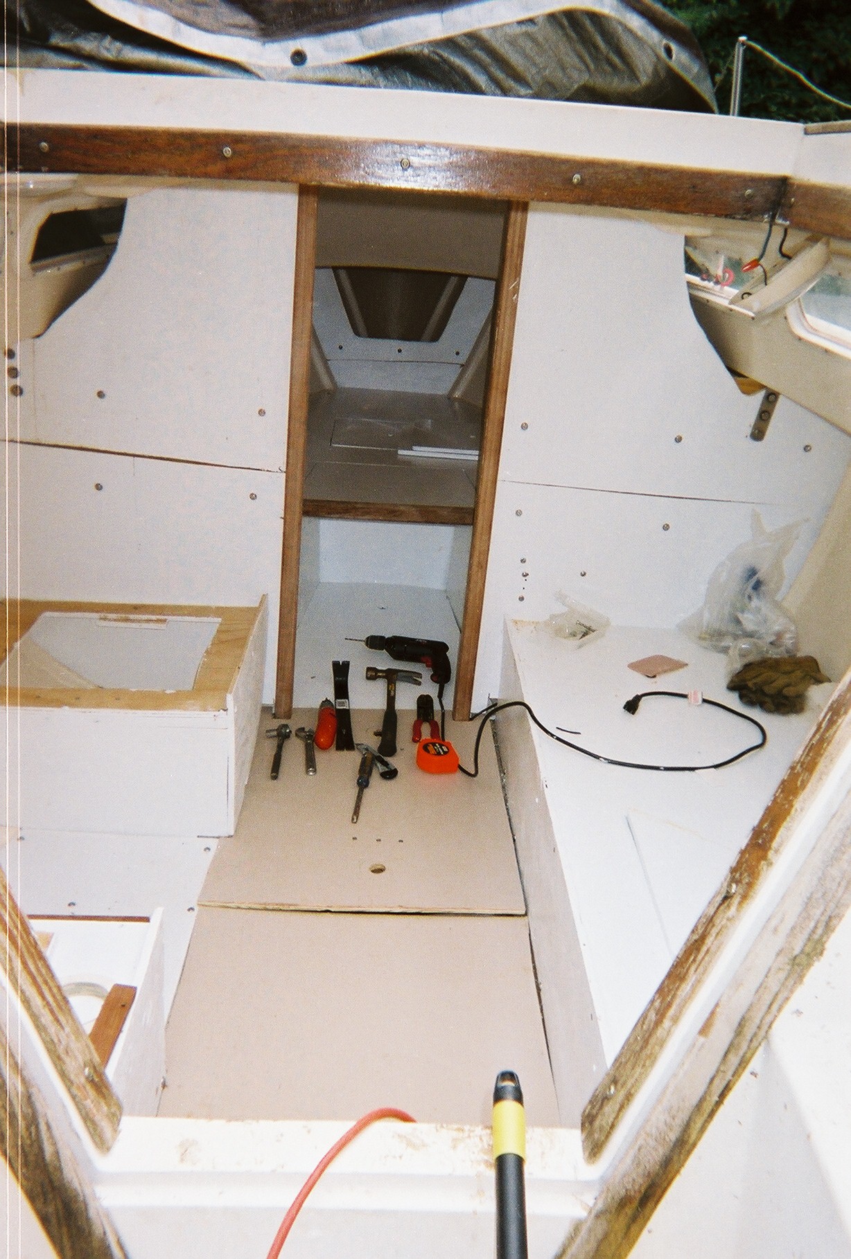

Getting a bulkhead back in place without removing the deck is tough but I've done it once before on a Coronado 23. I had to make the bulkhead in two pieces with overlapping segments in the middle. Glue... through bolt until gule sets and then remove the bolts...Here is a side-view of what I'm trying to descirbe.
You will then tab the edges of the bulkhead to the hull with fiberglass tape and some resin. Here are some pics of the job I did...
I covered my bulkhead with carpet tile to make it look nice but over the years I have come to really hate carpet on boats. I would not do that again. I would cover it with something else like a quality headliner material or vinyl. In this example, the bulkhead fit into a groove on the hull's surface so I did not need to tab it... I did lay a bead of glue down in the track to get a tigh connection between the bulkhead and the hull.

Now that I am thinking about the job I did on the Coronado... I should have made the joint lower on the bulkhead and then I could have hidden the joint behind the settee benches.
