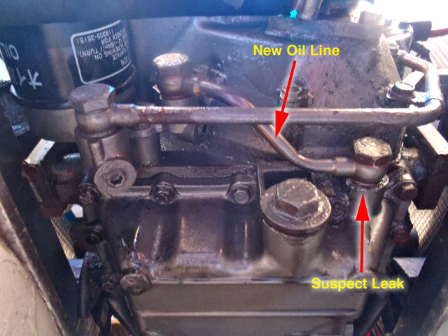

After methodical replacement of various seals I've managed to eliminate the fuel leak. Thanks for your help with that. All I have left is an oil leak. I found it last night with a mirror and running the engine.
It usually amounts to a teaspoon or less under the engine after 30 minutes of running the engine.
I don't think I can get to this spot without removing the filter, and maybe some other stuff.
Have any of you seen this before? Ok to let it go for the rest of the season?
The oil level doesn't seem to be going down. . . .

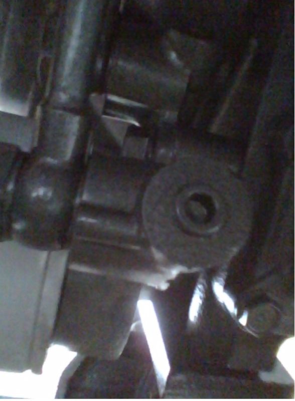

This is located under the forward starboard side of the engine--behind and below the oil filter? The banjo fitting is the terminus of a long oil line that comes from the port side of the engine. . .it seems to be coming from above the hex fitting. there is a rubber hose above this and very hard to see in the picture. I can find this fitting in my yanmar book.

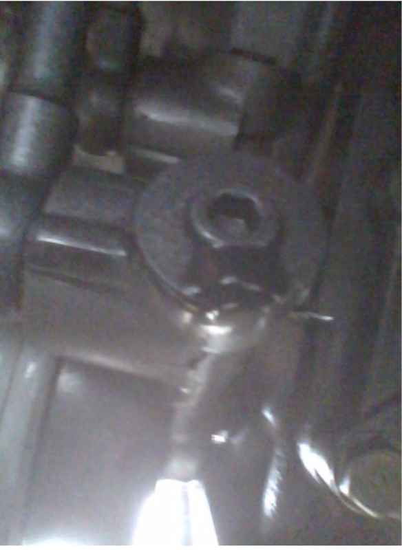

The third picture is not from my engine. My wife found it on the Internet and claims to be from a 1gm.
