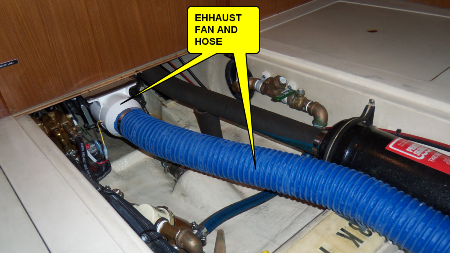

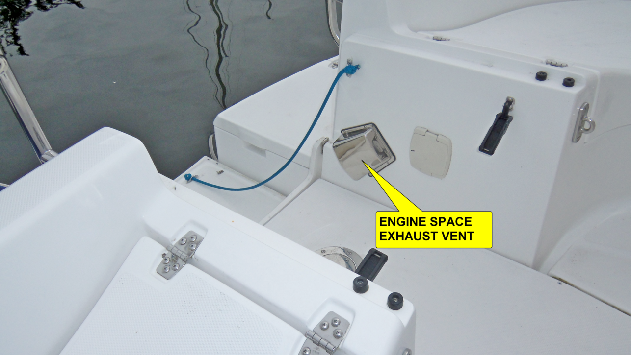

You're going to have to your homework on this one. Look for an exhaust vent on the exterior of your boat such as this one I installed :
You are looking for hose about 3" OD :

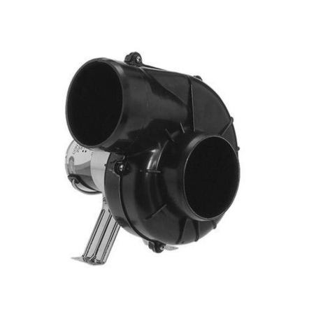

In my case and most likely others, you're limited to installing an in-line fan :
which has has smaller volumetric throughput than a larger centrifugal type fan :
There are many centrifugal fans available, it's just a case of finding one with a hose compatible inlet and outlet that runs on 12VDC and fits you available space.
