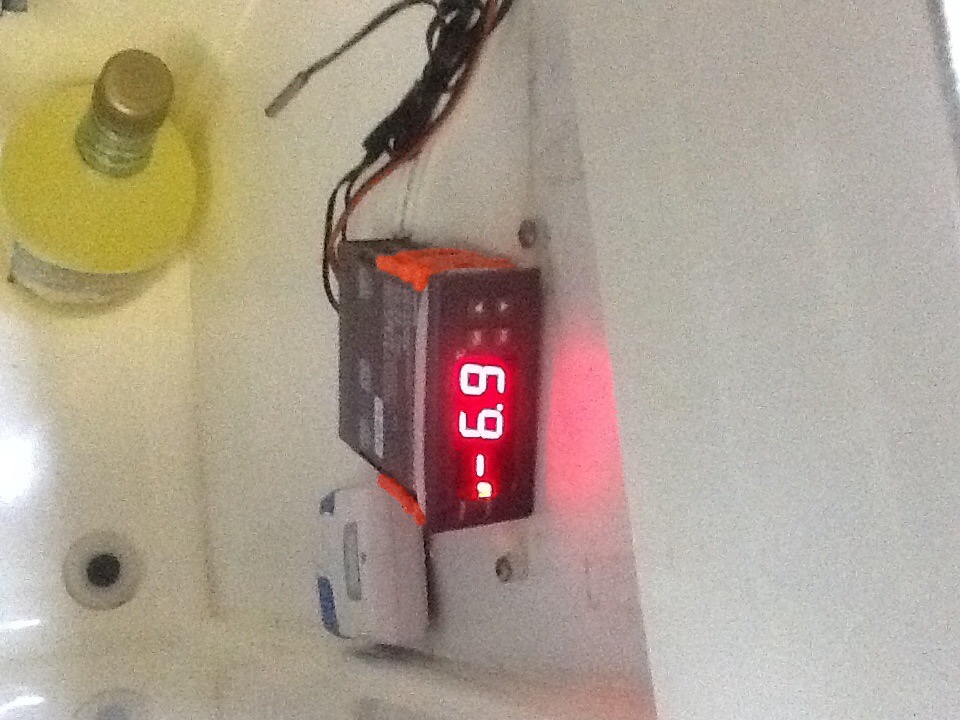

Hello, I went with a digital one I found on EBay. It has been working fine for 3 years now. Not the best place to put it but it worked at the time and still does!
