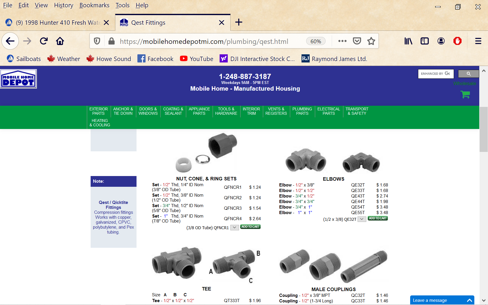

Thanks to all. It looks like the Quest fittings. The Nut, Cone, and Ring picture looks like what is on my 1998 Hunter 410. The tubing I have doesn't look like PEX at Home Depot, but the MobileHomeDepot.com says the fittings work on PEX.
Jun 12, 2020
14
Hunter 410 Boston, MA
Note: Qest fittings do NOT work on PEX. The tubing must actually be 1/2 inch outside diameter. Half inch PEX is slightly larger, probably 15 mm.
I am going to try 1/2 inch polyethylene tubing, which appears to match the existing tubing. Got it at Home Depot.
