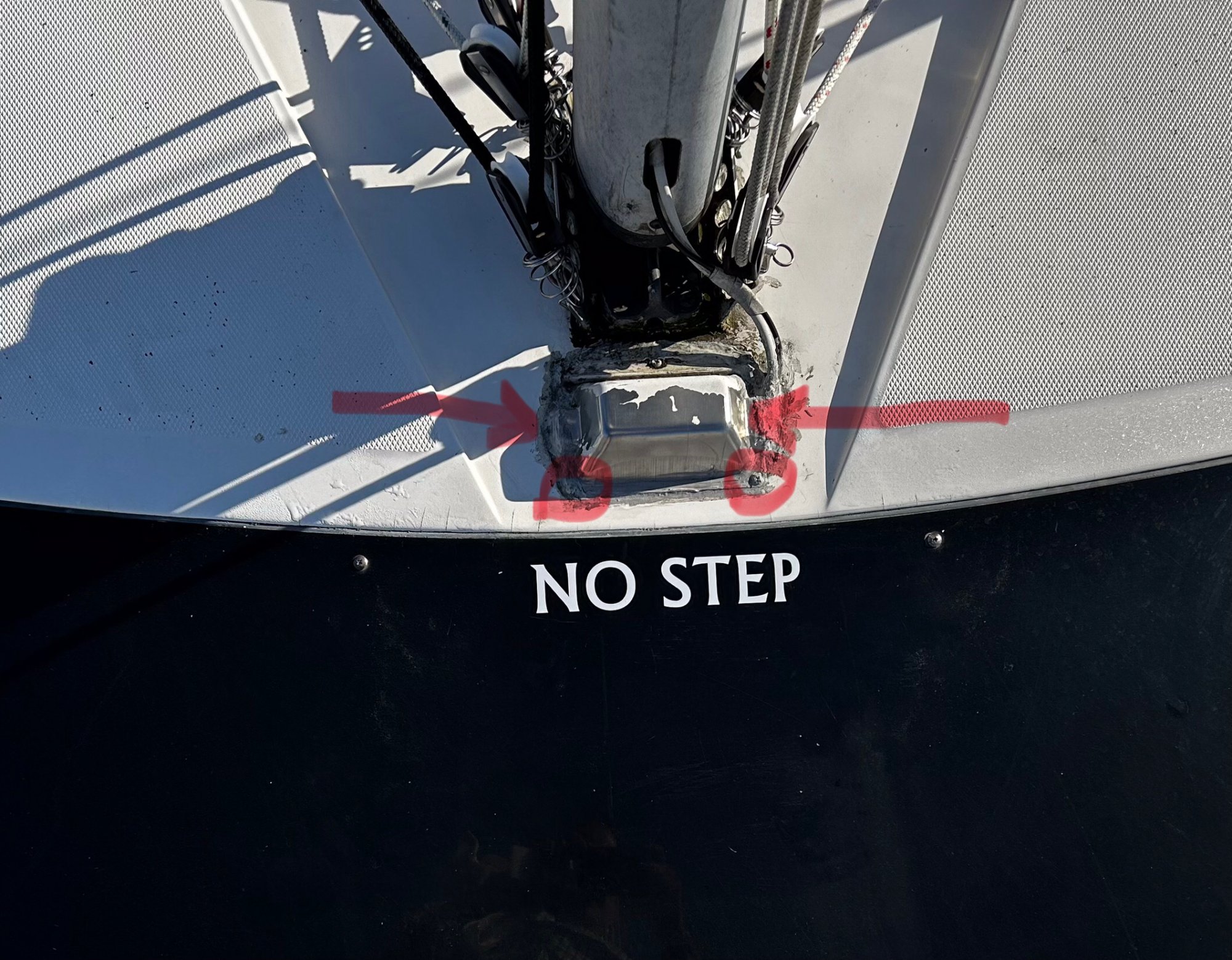

Do you have one of these on your deck?
On my 2000 340 this metal cover is the access way for the mast cables to enter the boat.
Please pardon the look of my caulk at this moment around this cover. It degrades, attracts all kinds of dust and dirt and looks like hell at the moment. The next cool cloudy day will be my re-caulk and clean project.
The 2 screws, circled in red, get removed and this allows the cover to fold back towards the base of the mast, it has a grooved hinge on the opposite side.
This exposes the hole in the deck where the wires and cables, under the center of that cover, go into the boat.
I have to re-caulk that hole every 2 years or so. Again, this is my year.
More importantly !
The 2 red arrows on either side, are the major issue. As you call it, Hunter Engineering.
I can’t speak for that, BUT, those arrows point to 2 “openings“ about 1” x 1” square on each side.
On my boat, the cables coming from the mast enter the cover on the right side. My red arrow covers this, but trust me, they go through there. The left side is available if I want more cables to go from the mast into the boat.
Now, those 2 1”x 1” openings have a foam sponge-like material stuffed into them. My guess is that was to stop water from getting under the cover.
But it clearly does not work. So I have to clean out and re-caulk periodically to keep water from dripping down into the boat, from that sponge-like material.
In the past, I have taken the cover off, cleaned off the chipped white paint and repainted it. But I haven’t done that in a while. Maybe this year after I get it all cleaned up, re-caulked and looking pretty again I’ll repaint the cover.
If you have one of these, check the ends, and replace the foam. But you have to caulk the openings, don’t trust any foam you use to do the job.
Hope this helps you out of your problem.
