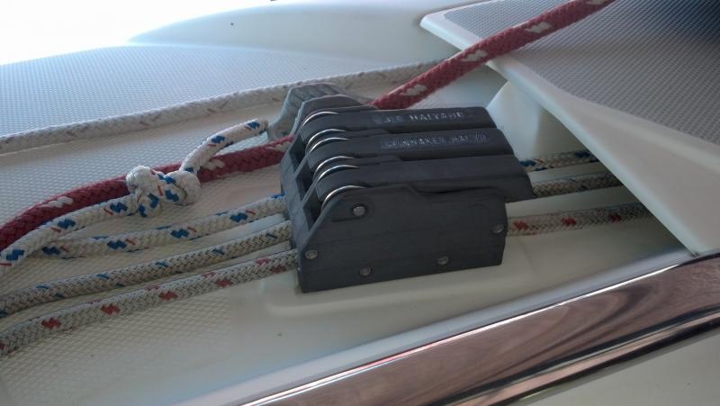

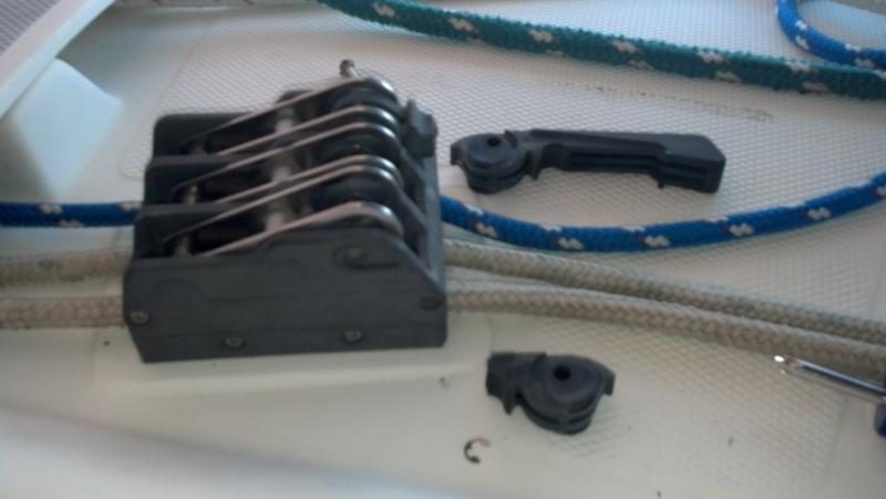

Hello to All,
I have recently purchased my first sailboat which is a 1996 Hunter 29.5' and would like to repair/replace the current triple rope clutch assemblies. Two of the handles are broken. I can not find the brand or model anywhere and wonder if anyone could pass along that info,,, assuming that the 1996 29.5' came with typical rope clutch assemblies.
Thanks!

Perhaps you could post a picture? Or you could call Hunter. They are very helpful.
Aug 12, 2013
4
Hunter 29.5 Lake Texoma
Thanks for your reply. Here are a couple of photos. I'll try giving Hunter a call.

I had the same issue. Here is the part at RigRite
Rigrite Part NF33503H Easylock replacement handle $17 plus $14 shipping
Easylock Mini Replacement Handle - New-Style: NF 33503H:
Replacement Handle for Easylock New-style Mini Rope Clutch.
Black Plastic Handle is 4 5/8" long x 3/4" wide.
