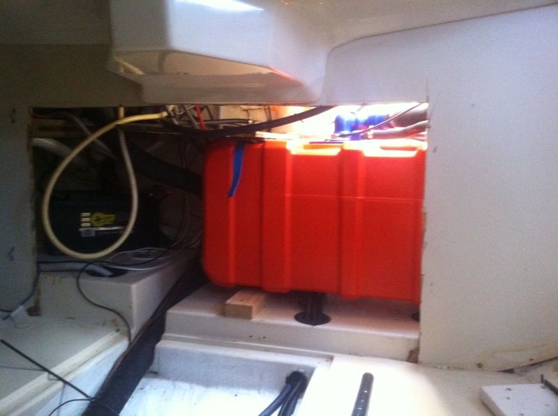

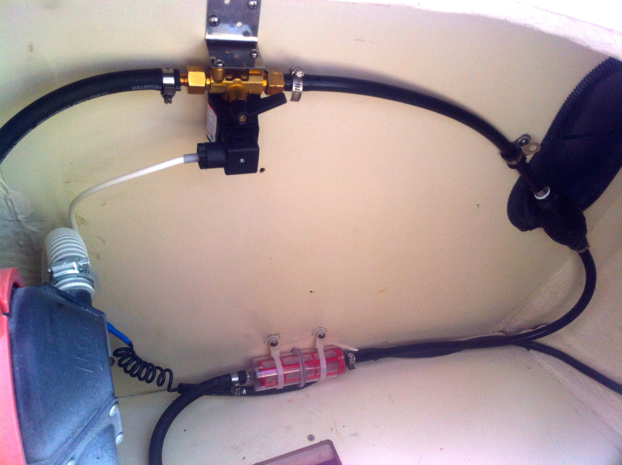

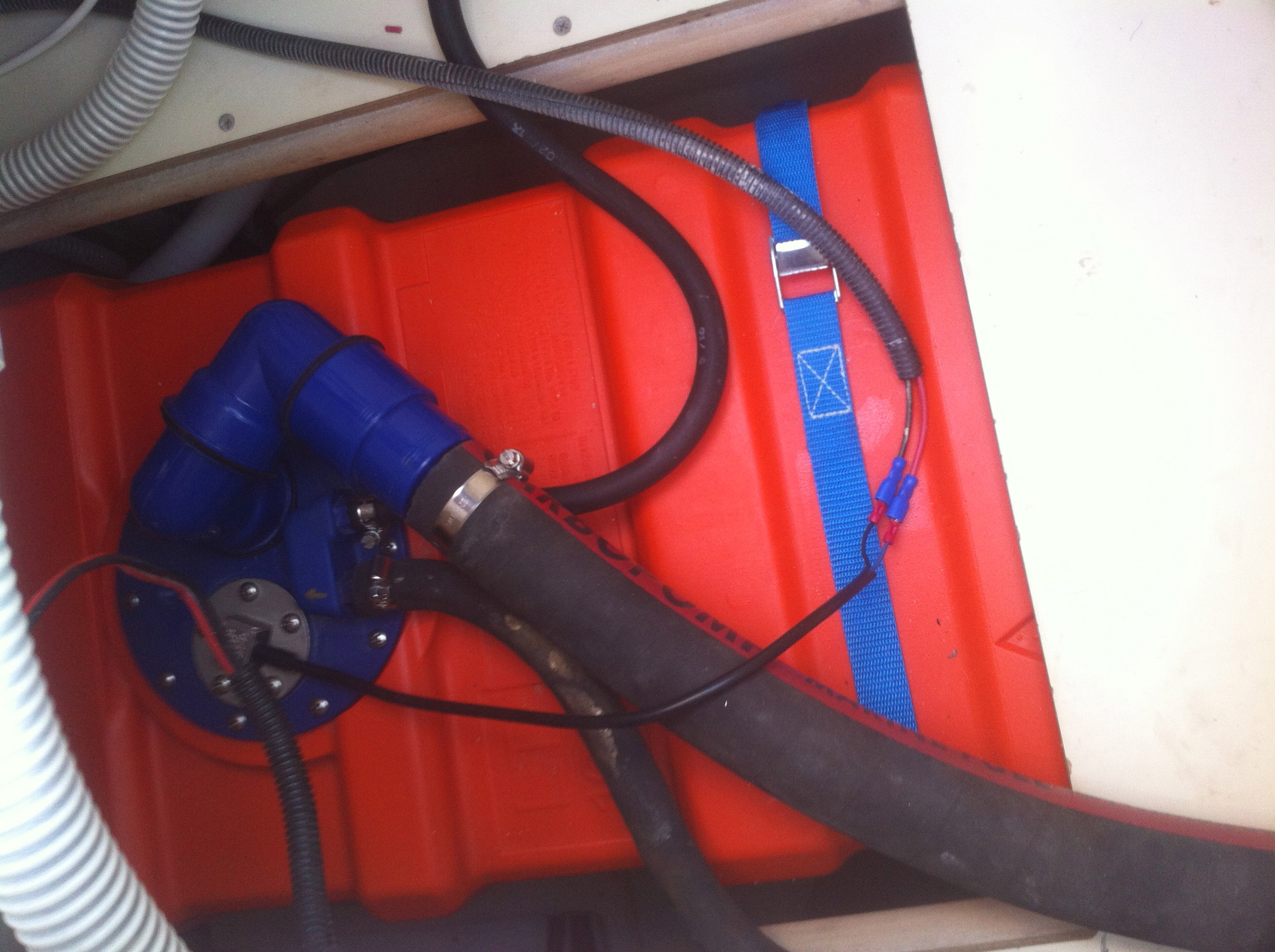

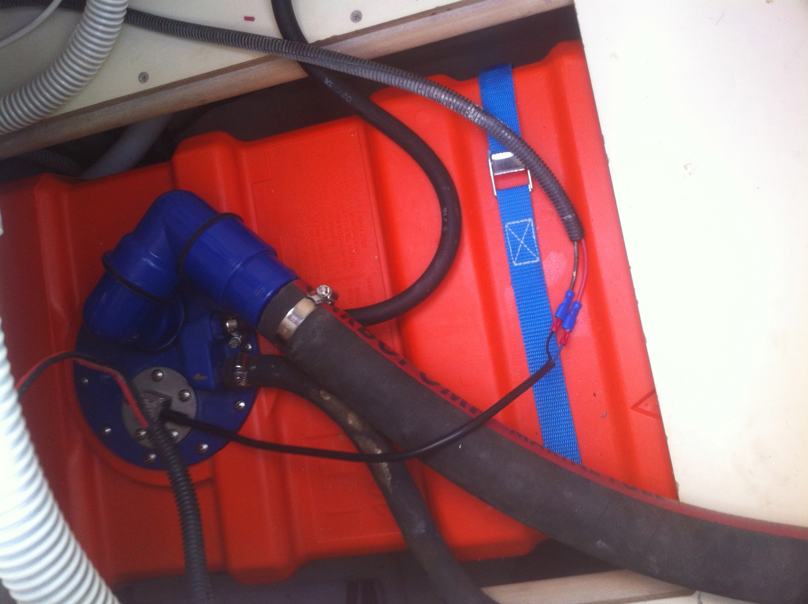

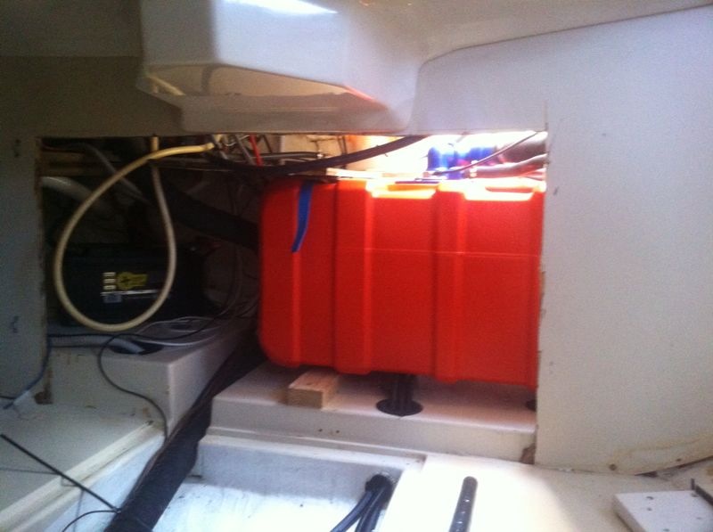

IMG_5738.jpg IMG_5866.JPG IMG_5739.jpg IMG_7734_2.jpg If you can serve, and this change that I made, I put forward the tank, and put 110 liters. here are the pictures. You see on the right a pump as that of outboard engines, it helps pump up if there are problems. Instead of the original reservoir now there is in holding tank. I hope I spelled it right ... Hello
