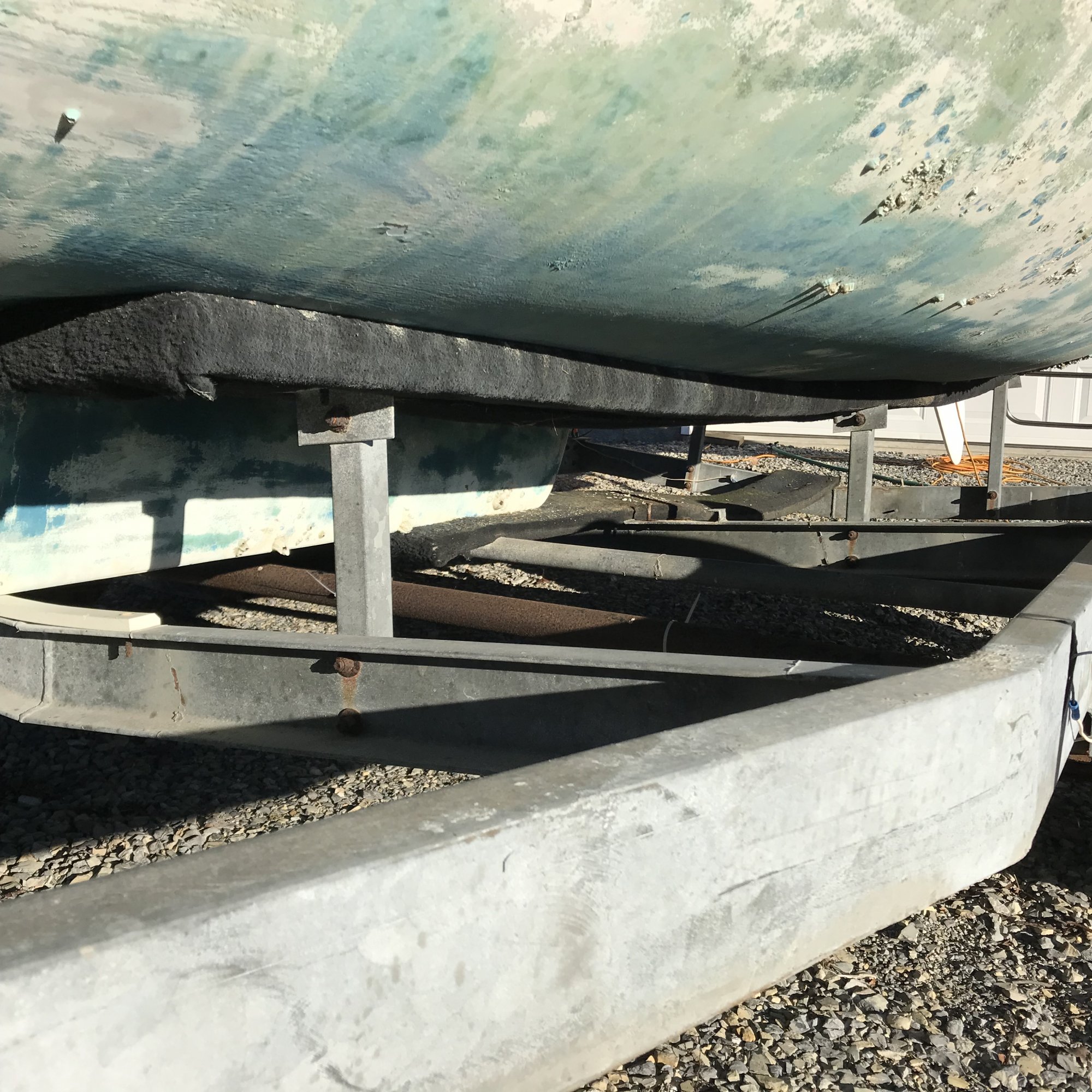

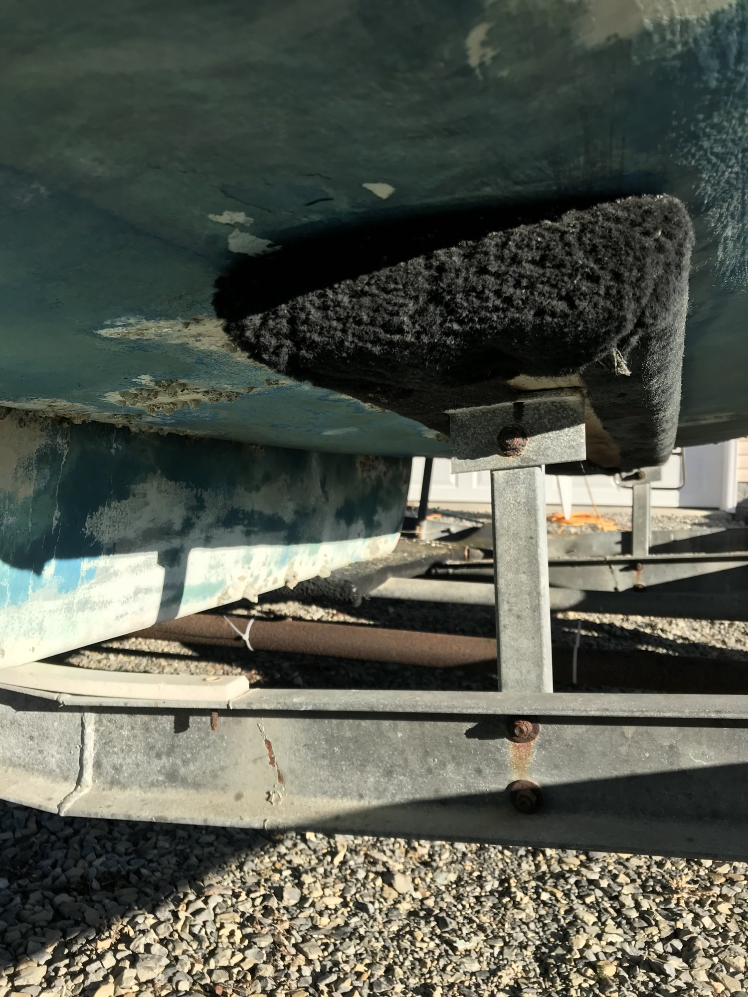

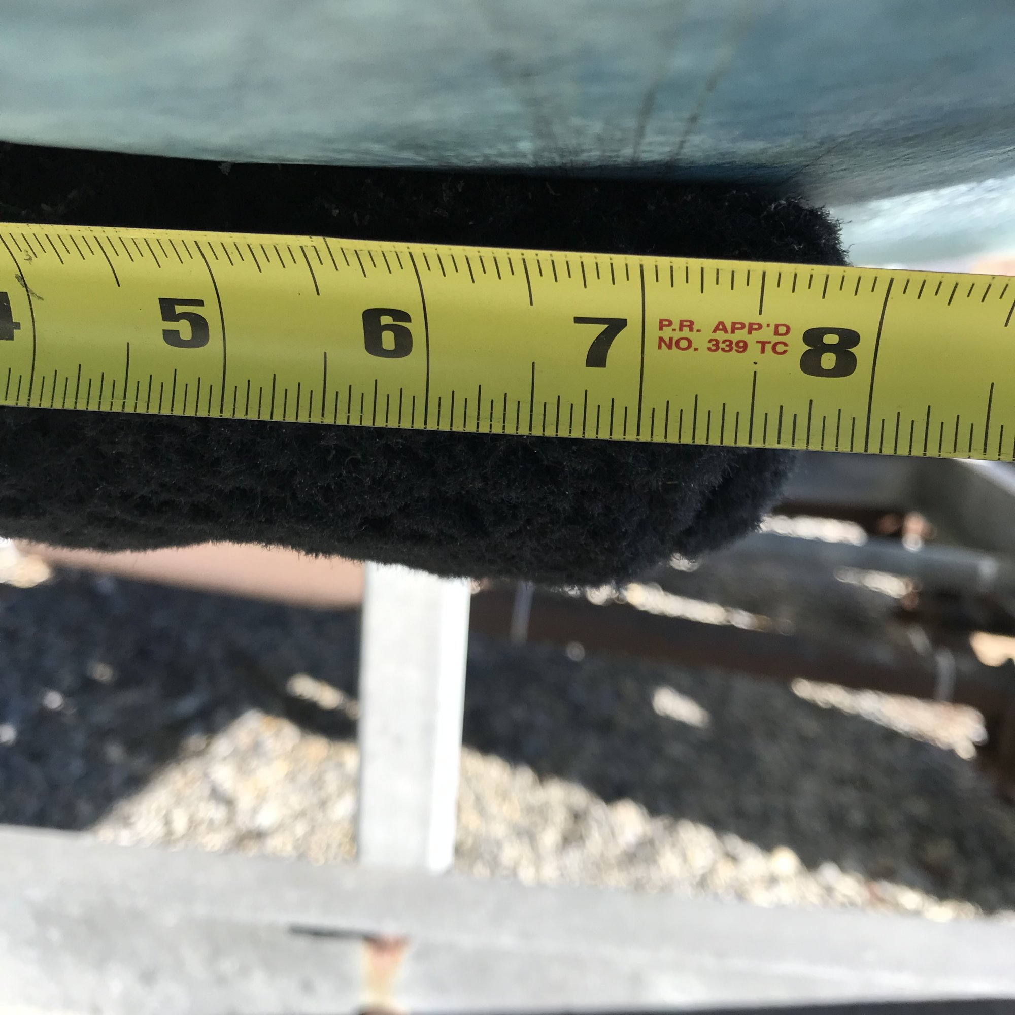

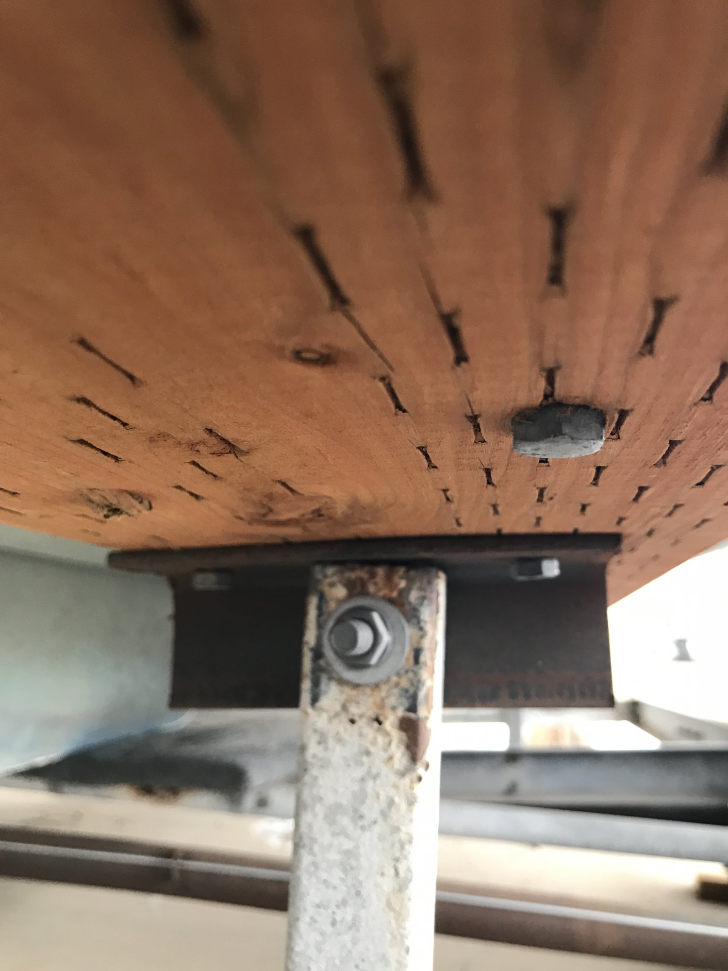

Some pictures from my 1995 H26.
I will add some text now that I'm at a keyboard (hate typing on my phone).
Mine has 3 uprights, the side bunk appears to be closer to a 2 x 8 then a 2x6. With the padding on it it was hard to measure but looked to me the wood was more like 7" wide.
The CB support bunk ends about halfway down the CB so only the aft end is supported. See the same on yours. Perhaps it was designed that way to keep the weight off the CB pin? I grabbed the front of the CB was able to rock the front back and forth but don't think I can move the aft end of it.
You didn't ask but if you are wondering the CB bunks (there are 2 side by side) are 1" x 8" x 8 Ft. (I think the 260 is a bit different) Oh and the LH one is removed in the picture as I'm working on it. Yah the boat is a little off center. (I didn't load it.)
Thaniel
10,536
-na -NA Anywhere USA
One thing on some trailers that the supports were not long enough. Why? The swing centerboard was jammed between the da boat and da trailer. I would sometimes have to call my friend at Hunter to advise. He would send new longer supports knowing he would not receive a claim. He now listens to all of you.
