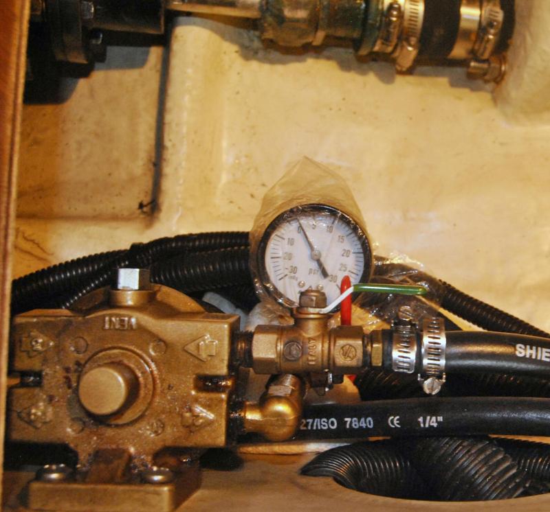

I have a new to me 1994 29.5 which was just launched for the season. It has a Yanmar 2GM20F engine. I was able to start the engine and it ran fine. My question is, are there an fuel shut off valves between the fuel tank and the engine that I need to make sure are open and exactly where are they located? I honestly don't see any and I'm afraid I'll motor away from the dock and the engine will die. Thanks.

The factory put a shutoff valve in the fuel line where it comes out of the top of the tank. It is under the access floor panel in the gull wing locker. Not very convenient :-(

It is a real pain to get to. I relocated mine down before the primary filter. much easier to use
