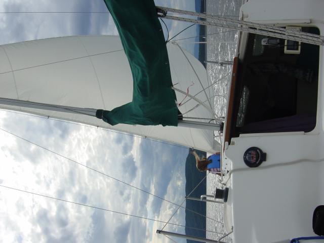

Vang picture
Novice question*1..Does the boom vang attach from the mast base plate to the same point on boom as the mast sheet?
Negative. There is (should be) an attachment point further forward on the boom.
The main sheet attaches further aft, directly above where the lower end attaches to the main sheet post.
Consult the appended picture (but you'll have to tilt your head sideways!).
