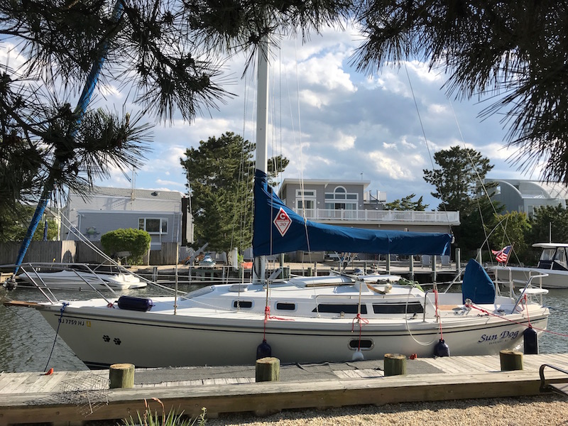

And here is "Sun Dog"

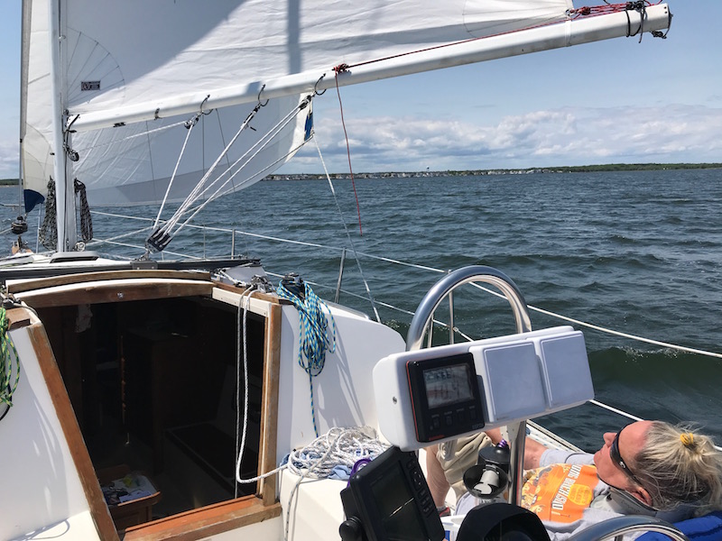

Cathy relaxing on during our first time out with all sails up.

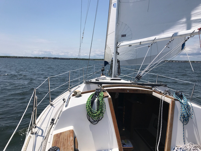

Heres a general pic. Nice Harken traveler but someone led the lines through several blocks and mounted the cam cleats on the teak of the sliding hatch cover. That added a lot of friction. I'll be moving them back to the traveler. That triple main sheet block is a nice Harken ball bearing block. The other main sheet blocks are new Garhaurer series 40 blocks. The main sheet clam cleat and single rope clutch will be replaced with a triple Garhauer rope clutch.

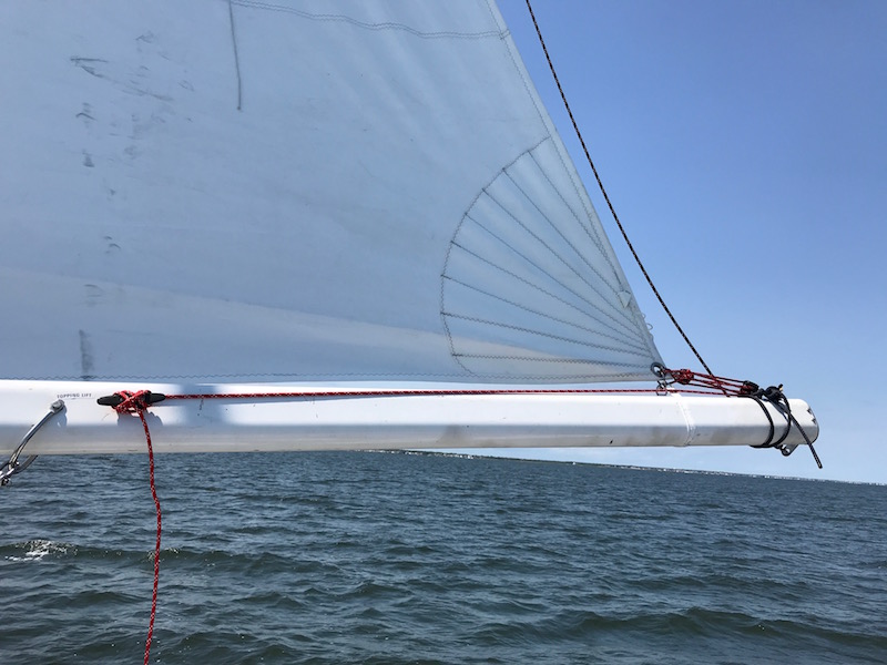

Here's the outhaul I rigged. Worked well. Will replace the horn cleat with a cam cleat at some point. Look close and you can see the clew strap I made. I sewed D rings onto both ends of a length of dyneema 1" webbing and used a shackle to attached to the clew. The dyneema slides easily on the boom.

I like your external outhual. Are you considering racing? Trying to understand why you would change from the cleat to a camcleat. Cruising you change the adjustments less frequently then when racing trying to get that last ounce of speed constantly adjusting. I cruise and use a cleat because I want a solid set that is easy to adjust but not going to let go until I act upon it.
Both my dock neighbor, who's boat I almost nailed, and the instructor suggested that with this boat and my desire to improve my sailing, I give racing a try. At times I like playing with sail trim controls, other times I just sit back and relax, so I may give racing a try.
As to the cleat vs cam cleat, just another thing on my long list of things to do that sounds like a good idea. It may get done when I feel like tinkering instead of sailing.
